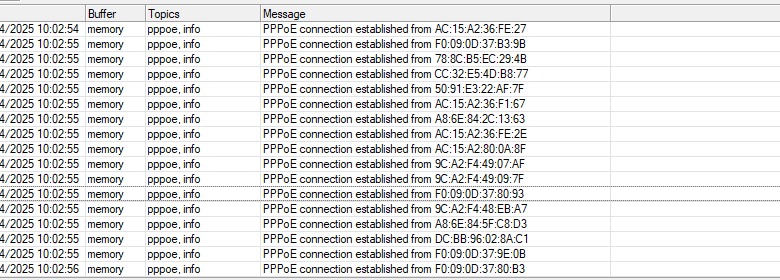

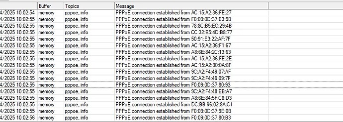

the CPU usage is very low. Only one is disabled. I have to wait for it to happen again, but I suspect the problem is with the IP pools. I've attached a screenshot of the log when it occurs.
