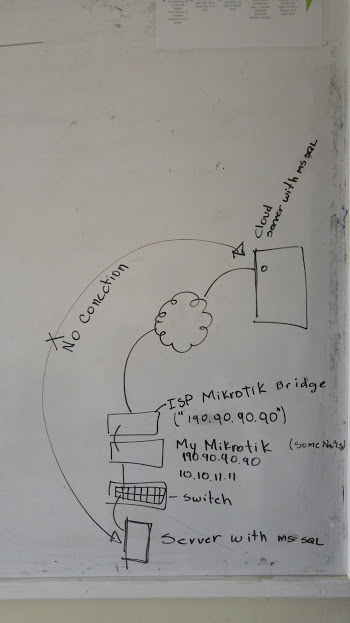

right now im a having a problem and i have reduced the problem to my mikrotik or my ISP.
so i have a server virtualized outside my LAN lets say 190.90.1.20 this server has MS SQL SERVER and i have MS SQL SERVER in a computer on my LAN lets say 10.10.11.11, i have a mikrotik ISP provided doing nothing but bridge (can see inside ISP policy) then i have my mikrotik with public IP lets say 190.90.90.90 now the thing is the MS SQL in my network cant reach the MS SQL in the cloud server.
right now my mikrotik only has some NAT to redirect trafic from some publics IP to several of our servers.

BUT i just tested connecting a cable directly to my ISP mikrotik and configuring manually one of my public ip’s and now i can connect but if i do this in my switch i can’t is there anything i have to enable in mikrotik to let any trafick to my remote server pass.
i created a firewall rule to accept input and output from my remote server.
