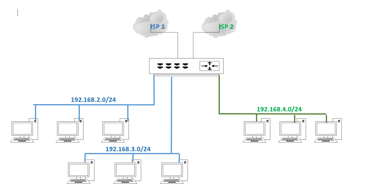

Greetings!
Scenario:
(I’m sorry this photo is not my actual config, just an illustration)
WAN 1: ISP 1
WAN 2: ISP 2
VLAN 10: 192.168.10.1/27
VLAN 20: 10.10.20.1/25
VLAN 40: 192.168.40.1/24
Load sharing between the 2 ISP are all fine, VLAN 10 and 20 gets its internet from ISP 1 and VLAN 40 from ISP 2 until one of the users from ISP 2 tries to connect/access file to/from the users of ISP 1 and vice versa.
And now the problem arises.
I can ping all their gateway (e.g: 192.168.10.1,192.168.40.1) but not the actual ip addresses of the current users. I get that their connected from different ISP but is there a way that they can communicate even when their connected to different ISP?
I feel like I’m lacking in my routing. Can someone enlighten a novice like me?
Thank you so much in advance for the response.

Without looking at your config, all comments are pure conjecture!
It appears you are simply asking for the ability to share information between vlans?
In that case you need to add vlan to vlan access rules, which you will probably want to narrow down to perhaps specific devices, protocols/ports, schedule etc…
Often one wants to share a common printer for numerous vlans for example.
Without really knowing the requirements (in user work flow speak, not equipment, config solution speak) and hte contents of the config its hard to say more.
Hey. What you meant when you sad that users are connected to different ISP? First of all they are connected to your LANs with or without VLANs. They are on your router even without ISPs. Your router is well aware of all routing info of all of 3 networks connected to him directly. So he knows how to reach them. If any PC has a default route, you need to look into firewalls on them or on router firewall filter.

Common problem is when routing is marked for anything coming from given LAN subnet and selected routing table only has default route, so for marked packets, router doesn’t know anymore about other LANs. Solution is to either not mark everything (exclude LANs), or use routing rules to look up LANs only in main routing table.

I’m sorry. Here is my config:
add admin-mac=CC:2D:E0:00:30:AF auto-mac=no comment=defconf name=bridge

add distance=2 gateway=122.***.***.*** routing-mark=to_ISP1
add distance=1 gateway=192.168.9.1
/ip route rule
add action=lookup-only-in-table dst-address=192.168.0.0/16 table=main
add action=lookup-only-in-table dst-address=10.0.0.0/8 table=main
/system routerboard settings
set silent-boot=no
/tool mac-server
/tool mac-server mac-winbox
Sob
October 25, 2019, 2:33am
6
Try this:
/ip route rule
Oh my gosh! Thank you so much. I can ping it now.
But I seem to have a little bit of a problem. I need to turn off the firewall of the unit so it can respond. What maybe the cause?
Sob
October 25, 2019, 3:47am
9
It’s possible that target device’s firewall is configured to only allow access from same subnet. Clean solution is to reconfigure it. Quick and dirty solution is to add srcnat on router, so connections from other subnets would have source address changed to router’s address, which is part of target device’s subnet. But it really is ugly, and the less NATs you have, the better.
cudalrm
October 25, 2019, 6:16am
10
Is that so? Reconfiguration is not an option for me.
cudalrm
October 25, 2019, 6:22am
11
you have a lan structure identified to the bridge, get rid of it if not required or create another vlan and set it up like the rest of your vlans.
(all the setting associated with 192.168.1.x)
get rid of IP DNS STATIC default setting
Where are Bridge VLANS? This is where you identify which etherports the vlans will go out on and according to the bridge port structure you do have, all the etherorts act as trunk ports??
Hi!
I needed it.
May I ask why do I need to get rid of it?
Well I’ll be only using 1-2 trunk ports so I didn’t bother to configure the other ports.
Thanks for responding by the way.
Sob
October 25, 2019, 11:25am
12
If it’s not possible to do anything with target device, there’s still the quick and dirty option, i.e.:
add chain=srcnat src-address=<source> dst-address=<destination> action=masquerade
Downside is that everything coming from will have the address changed to router’s address. Which can solve the problem, but it’s not nice at the same time. But you can make rule(s) only for specific addresses and ports where it’s necessary and leave the rest untouched.
cudalrm
October 28, 2019, 1:12am
13
Okay, I’ll try it. Thank you!
