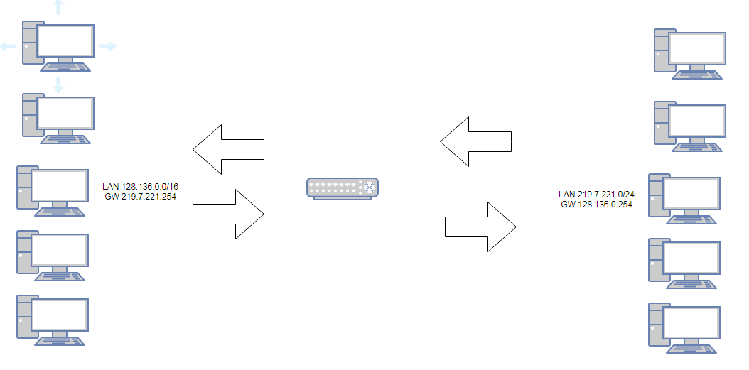

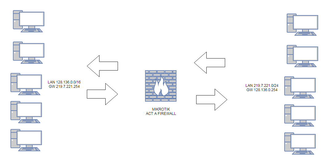

Hello, I will return with more detailed information about the problem.
I intend to put the mikrotik to route the 2 networks and firewall

I’ll assume the network subnets are real even if IP addresses aren’t. So … there are two potential problems:
  1. Does router 219.7.221.254 have static route towards 128.136.0.0/16 via 219.7.221.252?
  2. Does router 219.7.221.254 run stateful firewall? You are possibly creating routing triangle between mikrotik, devices in 219.7.221.0/24 and said router where packets from 128.136.0.0/16 towards that /24 subnet will be set directly from mikrotik to devices, return packets might go via router 219.7.221.254 (if devices don’t use mikrotik directly as first hop on way back) … stateful firrewalls burp if they don’t see all packets of connection traveling in both directions
    Same consideration applies to side of 128.1360.0.0/16.
Neither of problems applies to mikrotik itself as it will (by default) use own address “closest” to the destination address when establishing connection.
So in other words, there is a router attached to all the computers on one subnet and another router attached to all the computers on the other subnet and you want to add a third router in between to get the LANS to see each other for some purposes not clearly defined.
In other words, your network diagram and explanation are incomplete. Where is the internet for both LANs coming from?
If the answer is through the mikrotik as the MT has ether1 going to ISP1 and ether2 going to ISP 2, then all makes sense for firewall rules and routing etc…
Are the two LANs even in the same building?
