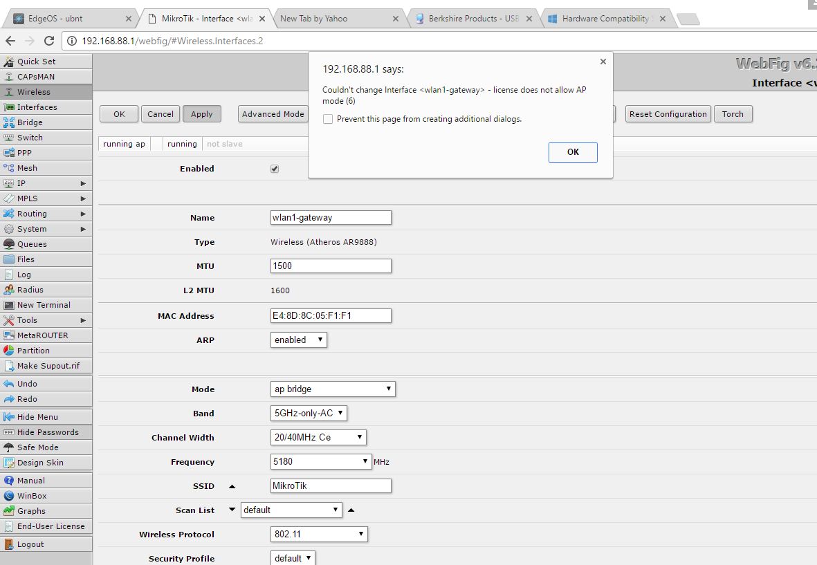

I am using the RouterBoard 911 Lite 5 ac.
I would like to set this up as ‘ap bridge’ mode. But it gives an error, see pic attached.
The error message says it all. Your device ships with level 3 license (CPE), whereas you need at least level 4 license to operate in the AP mode.
You can use it only in bridge mode to connect another device as station
