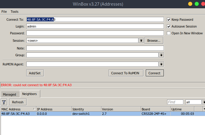

Hello together, I have a new CRS328-24P-4S+RM board, which I would like to use only as as Switch, for this purpose I changed from RouterOS to SwitchOS. After Reboot I could access from my client via Ethernet and static IP Range like the board to 192.168.88.1 and opened the Webinterface of SwitchOS. Afterwards I changed the DHCP configuration I think from default DHCP with fallback to DHCP only and restarted the board, to take the new IP address from the main central router/modem which already have a DHCP server…but after the reboot I could not get connected, because the WinBox windows show up under Neighbors my Board with a MAC address, but without an IP address = 0.0.0.0 !!! In the colum Version the SwitchOS runs with an older version 2.7, after that I looked into the current Changelog 2.12 (https://mikrotik.com/download) of SwitchOS which after my version there were many DHCP errors fixed…

In the attachments you can see my WinBox Neighbours Tab with the found device:
