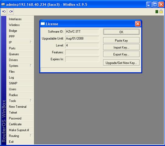

License is like this:
Expires at ago-2008
and now is LEVEL 4
And seems to be ok.
With the upgrade I pass from L5 to L4. But we can’t change mode from station to AP-bridge.

More info about this license problems:
If we put AP-bridge this is the Message error:
If we try to make supout.rif we get this:
And this is the actual license (Note that old license was Level5 and was expired july '07):
I can’t make commands in telnet because I have no access to the AP. My costumer takes these captures making it with winbox. I think its the same.
Now we have 1 new L4 license and 1 new L5 license for this ROS. If we put the L4 license we get these errors (attachments) and if we put L5 license we get L0…
