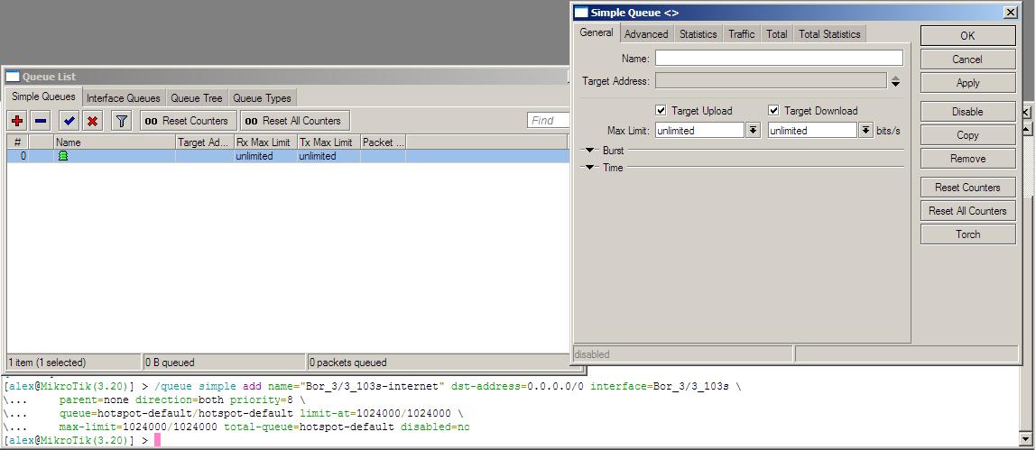

Now I use MT 2.9.x and wont to upgrade to 3.x, but faced with the problem. I have same script, it add pptp user, interface and queue. I have specificity of username it can contante /, exemple “Bor_3/3_103”, exemple of script add queue:
/ queue simple
add name="Bor_3/3_103s-internet" dst-address=0.0.0.0/0 interface=Bor_3/3_103s \
    parent=none direction=both priority=8 \
    queue=hotspot-default/hotspot-default limit-at=1024000/1024000 \
    max-limit=1024000/1024000 total-queue=hotspot-default disabled=no
witch MT 2.9.x it work fine, but MT 3.x (use 3.13 and 3.20) can’t add this queue from console, see attachment screenshot

Ok, make it easier, like:
/ queue simple
it done for MT 2.9.x to add queue, but at MT 3.x the effect same, the console does not understand a name of the interface with /
quotes have not helped
