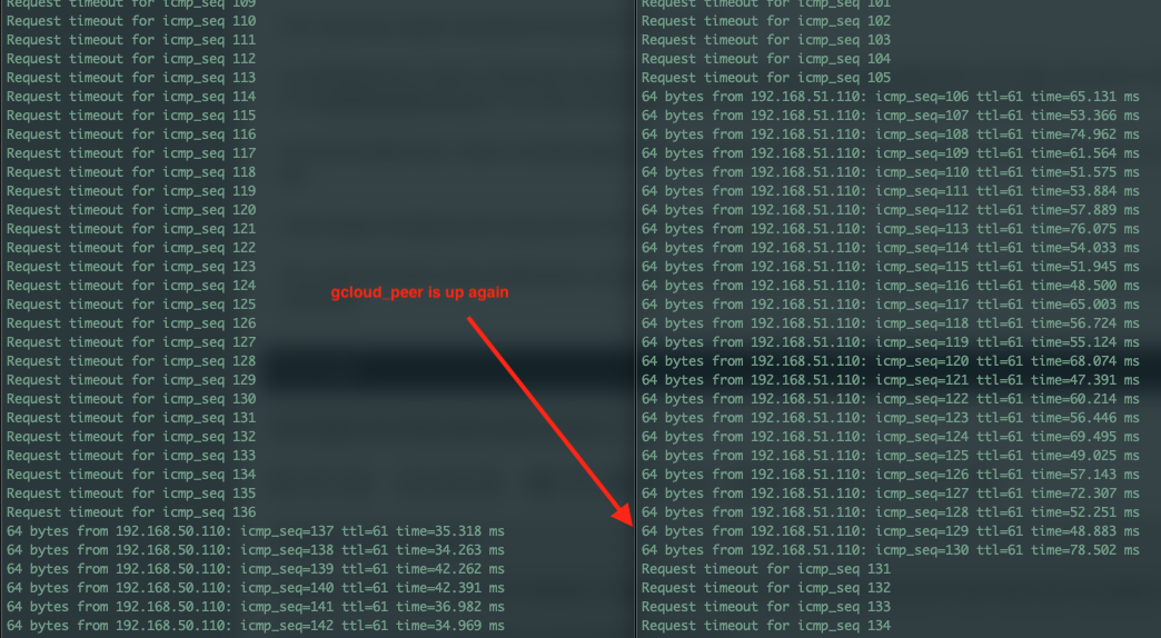

Thanks for the reply @sindy
I know it’s nothing unusual (on this Mikrotik I have 4 more tunnels to other locations and with them there was no problem, the only difference is exchange-mode=main).
This router has a direct connection to the internet (via PPPoE).
An interesting fact is that if I have both connections raised (gcloud_peer + gcloud_peer_fra), the traffic only goes to the gcloud_peer peer address, while if I stop it, the traffic appears on the gcloud_peer_fra peer. The other tunnels work without any interruption and do not lose any packets.
As for the firewall rules. There is nothing special there (esp and ah have accepts and are at the very top of the stack), in NAT similarly (address lists of these tunnels have accepts in src-nat)
Unfortunately changing level=unique did not bring any change :frowning:
This router has quite a long configuration to paste it in its entirety (a lot of things to hide) - so I don’t know if it makes sense to process and paste it all, but please let me know, I’ll prepare something
Look at the screens below:

That’s what I was assuming - the first one, with src-address=ip-gloud_peer_fra, shows only one packet transported, while the two with src-address=ip-local_router show about 450 packets each, whereas the one with src-address=ip-gcloud_peer shows 880 packets (so roughly twice 450) with an average size of 84 bytes.
To double-check, disable and re-enable the peers again, ping only the private subnet server by gcloud peer fra for a minute or so, and then check the same output of /ip/ipsec/installed-sa print detail …. If my assumption is correct, you’ll see non-0 packet counts for the SA with src-address=ip-local_router dst-address=ip-gloud_peer_fra (correct) and with src-address=ip-gcloud_peer dst-address=ip-local_router (incorrect).
After reset peers and pinging only gcloud_peer_fra it looks like this.
Ok, did You have any ideas how to resolve that problem? I see something like that first time in my carreer.
