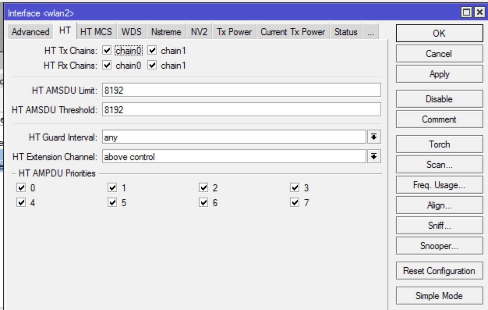

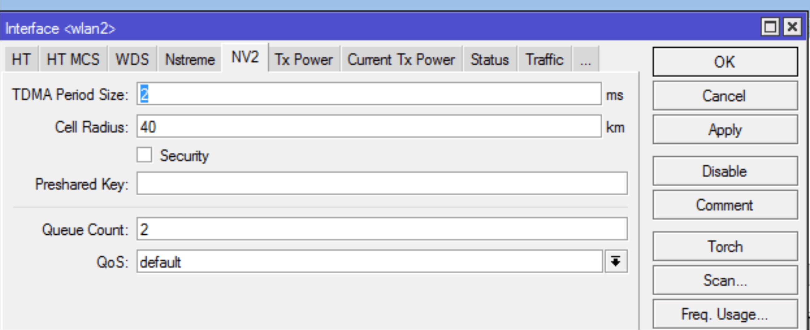

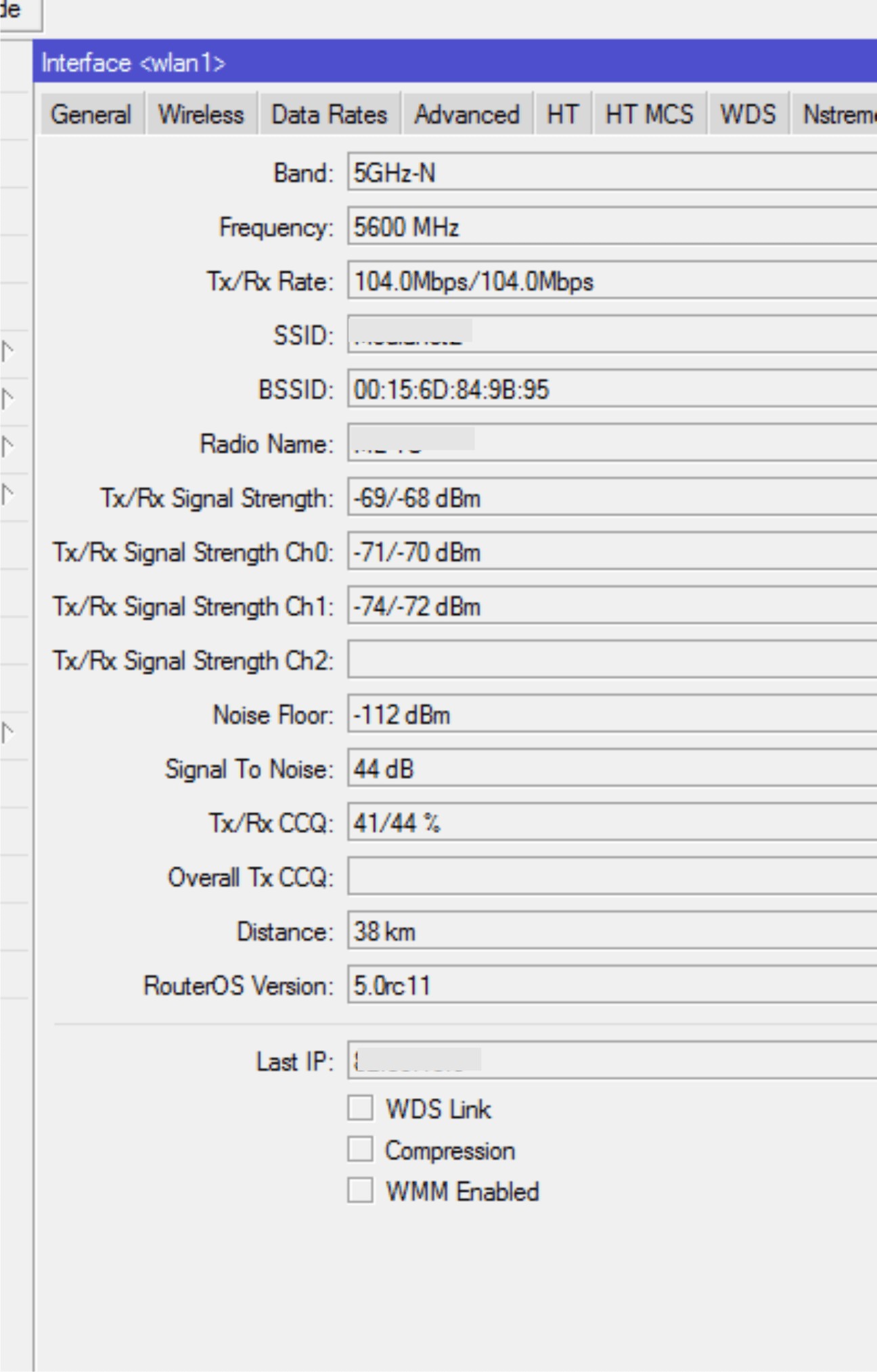

I still have serious problems with the radio link, I can not tell if it is
a configuration problem or a firmware problem.
What happens is that the link is very unstable going down there often for no reason
I enclose some of my configuration screnshot maybe give me a Potet
hand.
The configuration is as follows:

What data rates have you selected?
Looking at the signal strenghts of some chain they are on the edge (around -71 - -74 data rate jump to lower levels).
This means that the AP continiously is jumping between some data rates. This not only degrades the CCQ seriously, it can also cause disconnects of the client.
Try to find data rates which give better signal then -73 and try to go for this data rate only. Disable all others (also the ones of the ´old´802.11a levels) and set the basic rate the same.
Now see if your link becomes stable. If not, lower the data rate one step. (This can be tricky with the ´n´ rates. Look in the table what each rate actually stands for and make the decision which ones are next level down)
You’d better have a stable link with near 100% CCQ then a higher data rate link with poor performance.
