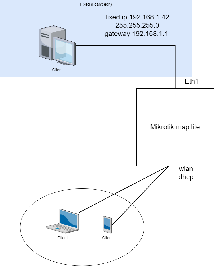

I have this architecture that I m posting. I want to configure the Mikrotik to have a dhcp wlan that permits me to ping my top client with static configuration. I have set this configuration:

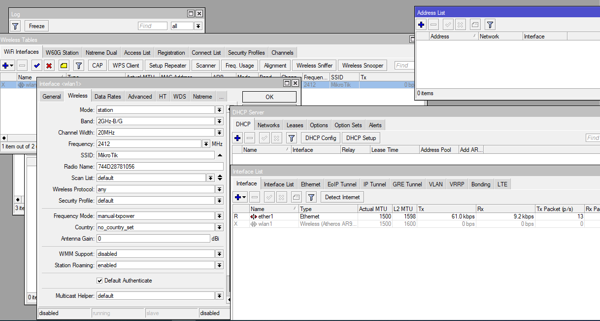

When I try to apply it to a Mikrotik with 7.* version it works, while with 6.* it doesn t: it sets the wlan1 in station mode and delete my dhcp server configuration.

Almost there.
There should not be any difference between ROS 6 and ROS7 in this simple network.
But …
  • there are no VLAN seen in your config. So remove the ingress-filtering on the bridge ports.
  • a WLAN in station mode is a client device to an other AP. You have clients to the mAP, so the WLAN should be in “AP-bridge” operation mode, as your config printout is saying.

I set ingress-filtering=no and now I can see the wifi (mikrotik led blinks now and I can see the wifi network on my pc), but the dhcp doesn t work (I post you a screen)
PS: I changed the wifi key with the right requirement
Yes I don t have ping problems, the same mikrotik with 7* version it works perfectly
You only need single IP address from subnet 192.168.1.0/24 and that one should be on bridge interface.
Your architecture is not clear, and where is the internet?
Do you have one or two LAN subnets?
The config is as confused as your diagram

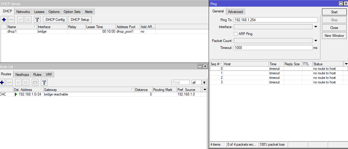

Done, now I just connected my iPhone to wifi, it assigns me 192.168.1.254 (I can see it in “leases” tab too) but i can t ping it:
Why did you change your network and config…
Did your requirements change or are you blindly listening to advice…

I don t have internet, I d like have a wifi network where i can connect with multiple devices (so i used dhcp server) and be able to ping and use my static device (the top client you can see in my first diagram, with static ip 192.168.1.42). Idk why configuration i set (in my first post) works in 7* version and not in 6*.
I just have a constraint, to not set the gateway in the dhcp server, so when i m connected to wifi with my smartphone, i can use my mobile data to have internet (http://forum.mikrotik.com/t/no-internet-flag-on-mikrotik/158463/6)
I have a static device X:
  • 192.168.1.42
  • 255.255.255.0
I want connect X to mikrotik via ether1, and have a wifi where i can connect and navigate to X via its ip.
As told in the latest topic, i don t want to add a gateway to my dhcp server to be able to use my mobile data while i m connected to wifi.

Someone can help me with this architecture?
Recap:
  • 192.168.1.42
  • 255.255.255.0
I want connect X to mikrotik map lite via ether1, and have a wifi where i can connect and navigate to X via its ip.
Important: i don t want to add a gateway to my dhcp server to be able to use my mobile data (for internet) while i m connected to wifi.
Adding gateway will not influence access to 192.168.1.42 from any other 192.168.1.yyy (this is local LAN, not via gateway).
Set WLAN1 in the WAN interface list. Bridge (and all it’s ports) are in the LAN interface list.
