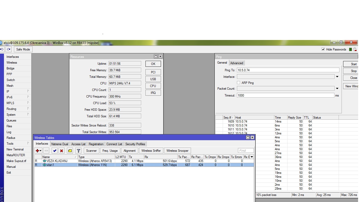

I’m a new user here and I have a problem with 70 KM link. The scenario is as follows: RB433 (interface named as wlan1 has R5H card on each locations). Antennas are dual polarity 30dBi dish with large radius. However, I am not getting what I expect here. As you can see from the screenshot about 6-10M goes through this interface but It should be at least 15-25 at night.
What am I getting wrong here?

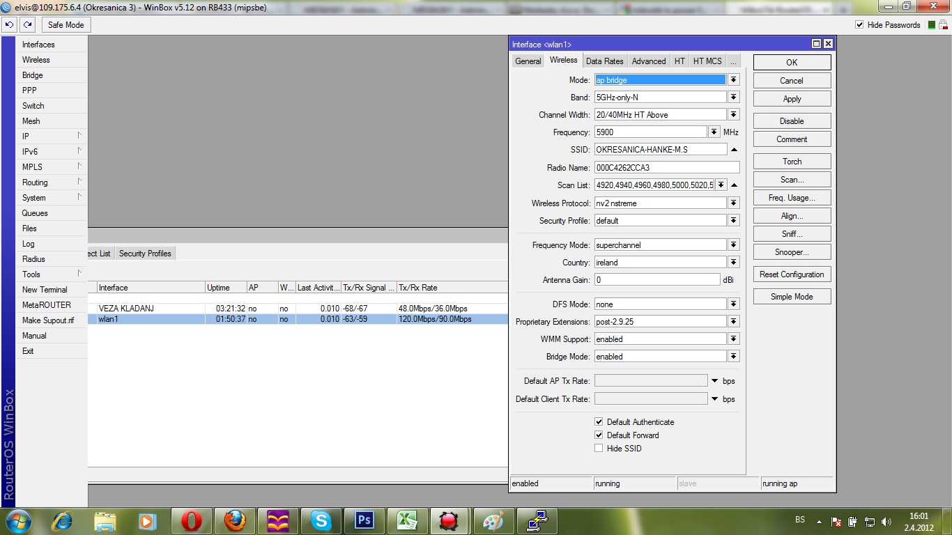

All settings are the same on card that transmits and on card that receives signal. Signal streangth is tx/rx -64/-61 and throughput tx/rx 90Mb/80Mb but in real it is no more than 10M :frowning:

wireless settings:
R name=“wlan1” mtu=1500 mac-address=00:0C:42:62:CC:A3 arp=enabled disable-running-check=no interface-type=Atheros 11N radio-name=“000C4262CCA3” mode=ap-bridge
ssid=“OKRESANICA-HANKE-M.S” area=“” frequency-mode=superchannel country=ireland antenna-gain=0 frequency=5900 band=5ghz-onlyn channel-width=20/40mhz-ht-above
scan-list=4920,4940,4960,4980,5000,5020,5040,5060,5080,5100,5120,5140,5160,5180,5200,5220,5240,5260,5280,5300,5320,5340,5360,5380,5400,5420,5440,5460,5480,5500,5520,
5540,5560,5580,5600,5620,5640,5660,5680,5700,5720,5745,5765,5785,5805,5825,5845,5860,5865,5880,5900,5920,5940,5960,5980,6000,6020,6040,6060,6080,6100
wireless-protocol=nv2-nstreme rate-set=default supported-rates-b=1Mbps,2Mbps,5.5Mbps,11Mbps supported-rates-a/g=6Mbps,9Mbps,12Mbps,18Mbps,24Mbps,36Mbps,48Mbps,54Mbps
basic-rates-b=1Mbps basic-rates-a/g=6Mbps max-station-count=2007 distance=dynamic tx-power-mode=default noise-floor-threshold=default nv2-noise-floor-offset=default
periodic-calibration=default periodic-calibration-interval=60 dfs-mode=none wds-mode=disabled wds-default-bridge=none wds-default-cost=100 wds-cost-range=50-150
wds-ignore-ssid=no update-stats-interval=disabled bridge-mode=enabled default-authentication=yes default-forwarding=yes default-ap-tx-limit=0
default-client-tx-limit=0 proprietary-extensions=post-2.9.25 wmm-support=enabled hide-ssid=no security-profile=default disconnect-timeout=3s on-fail-retry-time=100ms
preamble-mode=both compression=no allow-sharedkey=no station-bridge-clone-mac=00:00:00:00:00:00 ht-ampdu-priorities=0,1,2,3,4,5,6,7 ht-guard-interval=any
ht-supported-mcs=mcs-0,mcs-1,mcs-2,mcs-3,mcs-4,mcs-5,mcs-6,mcs-7,mcs-8,mcs-9,mcs-10,mcs-11,mcs-12,mcs-13,mcs-14,mcs-15,mcs-16,mcs-17,mcs-18,mcs-19,mcs-20,mcs-21,mcs-
22,mcs-23
ht-basic-mcs=mcs-0,mcs-1,mcs-2,mcs-3,mcs-4,mcs-5,mcs-6,mcs-7 ht-txchains=0,1 ht-rxchains=0,1 ht-amsdu-limit=8192 ht-amsdu-threshold=8192 tdma-period-size=2
nv2-queue-count=2 nv2-qos=default nv2-cell-radius=30 nv2-security=disabled nv2-preshared-key=“” hw-retries=7 frame-lifetime=0 adaptive-noise-immunity=none
hw-fragmentation-threshold=disabled hw-protection-mode=none hw-protection-threshold=0 frequency-offset=0 rate-selection=advanced
tx/rx CCQ: 37/20%

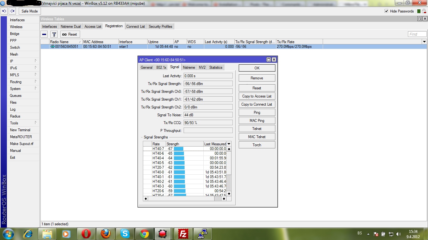

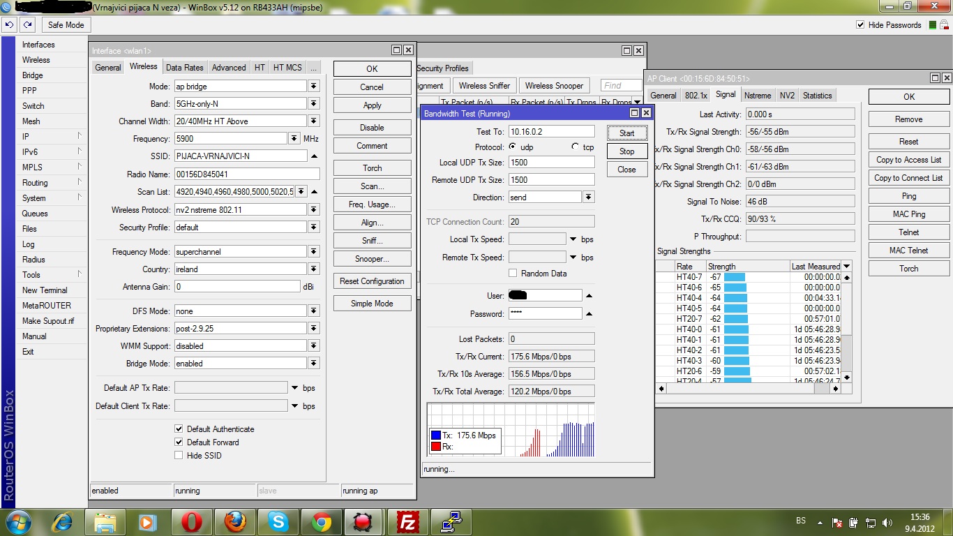

I have successfully managed to setup another n link. It is 30 KM distance with tx/rx ccq 90/93, signal tx/rx 56/56 270Mbps/270Mbps, bandwidth test goes up to 195Mbps, ping 2ms…works like a charm. Cards are R52HN with panel antennas.
