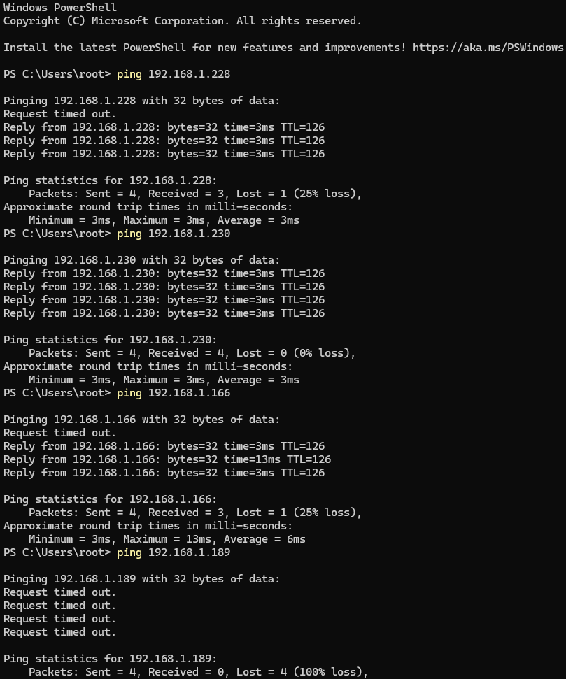

The problem itself looks like this on the wg client, ping skips, and something is unavailable
I at random tried making a dst-nat rule on the wg-gateway from the wg interface to the ip address of the central router, now everything pings without fail. However, nothing but pinging works, and if you disable mascarading on the client, it disappears too…

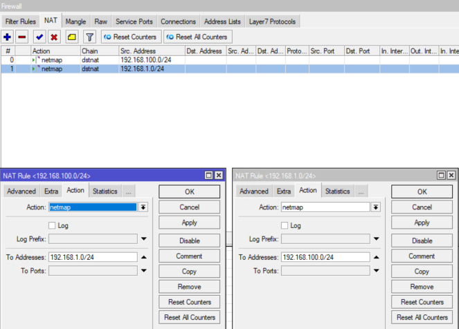

Thank you all for the replies, decided on my own with NETMAP rules. I created 2 rules with ip addresses of WG pool and local network, and assigned them to each other in action. But now it stopped working again. I turned on the log for these rules and noticed that all calls go to 192.168.1.255 or 255.255.255.255, as well as turning on netmap on the central router when pinging another subnet gives a response from the wg pool.
