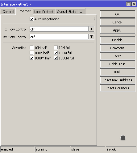

  • When I tried to advertise only 1000M(half and full) the interface didn’t worked anymore.

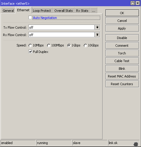

  • When I unchecked the Auto Negotiation and checked 1Gbps and Full Duplex the ethernet interface didn’t worked anymore.
    I had to connect to another interface to enable 100Mbps(full) on the interface in order to make it work again.

Print screens:
Before:
and
After:
Can someone tell me why I can’t connect from the PC to the MKTK Router at 1Gbps even if the router advertise 1000M(half and full) and why when the speed settings are changed in the MKTK Router the interface doesn’t work anymore?
