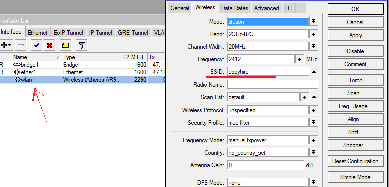

“ERROR: scan not running” I get this error sometimes try several times it should work - just that - scan and connect or just simple copy SSID name of designated wifi to wlan SSID TAB “space”
than go in IP->DHCP client create DHCP on wlan1 and that is
On the last one u can not Delete wlan interface, u can uninstall or install wireless packed or u can disable and enable. In wiki manual that is not what it says, it says to delete wlan interface in bridge->ports (That is different, by doing that wlan port and rest of ether ports will not be in bridge) because u need wlan to act as WAN port
Actually if u are a beginner in mikrotik the most suitable option for you is ''quick set", placed top left in winbox - it’s easy to use
