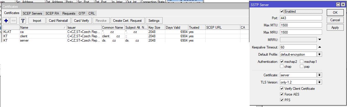

I have used two hEX Mikrotik as SSTP VPN concentrator with certifications and lot of hAP as clients.
On the primary hEX I generated a ca, server and client certificates. So ca and client cert imported to clients hAP and created SSTP tunnel. On the hEX I had set “verify client certificate”. Everything works fine.
But if I exported a certifications and import these to second hEX. So if first mikrotik shutdown and turn on second Mikrotik hEX and with the same configuration and restore certifications so the clients are not possible to connect.
I found only diferences with certifications that on the primary (on this were generated) are certifications issued and index ca but on the second one Mikrotik not.

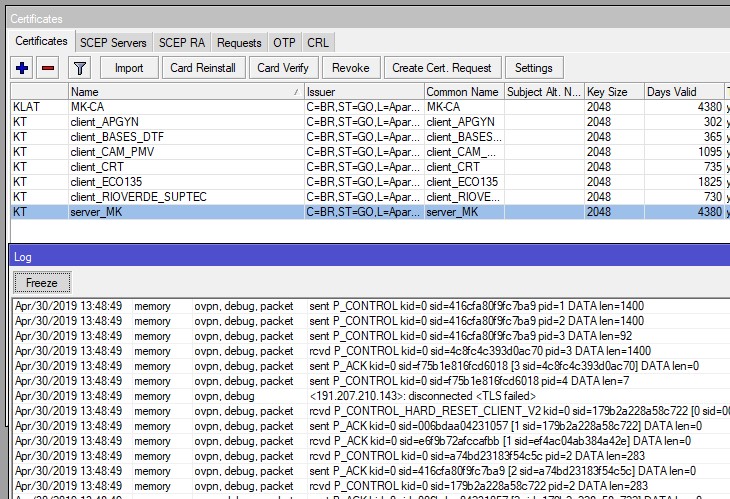

Hi Exiver, I have two CCR1016, firts in production and second in backup. Same Hardware end RouterOS 6.44.3.

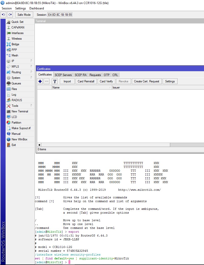

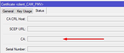

When I restore the backup, the certificates do not have the “K” of privete key, see.
After restore backup, I Export certificate of MK Production end import to backup (.crt and .KEY), but not working

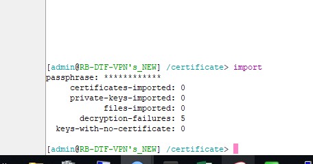

I had a similar problem recently. After restoring the backup did you delete the certificates before importing them again?
As @tdw mentioned: If you want to import the certificates again - you need to delete them first.
Your first picture shows us that you dont have the private keys on that Device. Where did you first create them?
The right procedure would be:
→ Router #1 with CA-Certificate and everything else (Export Certs+Keys)
→ Download Certs+Keys to your Computer or a safe location
→ Backup Router#1
→ Router #2 should be completetly empty, same software version as Router #1 (no default config, no certificates, check /certifiticates print before importing)
→ Restore Certificates + private Keys
→ Rename Certificates + private Keys to the same “Name” as on Router #1
→ Import Config
That should be the correct way…

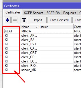

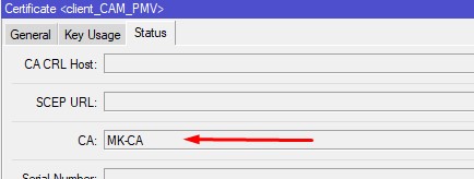

These are the MK production certificates that work. See the first column. Certificate CA KLAT, Certificate client KI. There are Working.

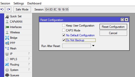

1-factory reset (Not default configuration)
2-Restore Backup (With the production MK settings)

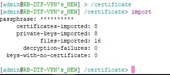

3- Deleted the existing certificates
4- Import certificates / key sucess.
5-Certificates Not working, VPN not conection and first column not “i” (issued), only “K”

The I for issued is not necessary since its only displayed on the device which created the certificates. Thats expected.

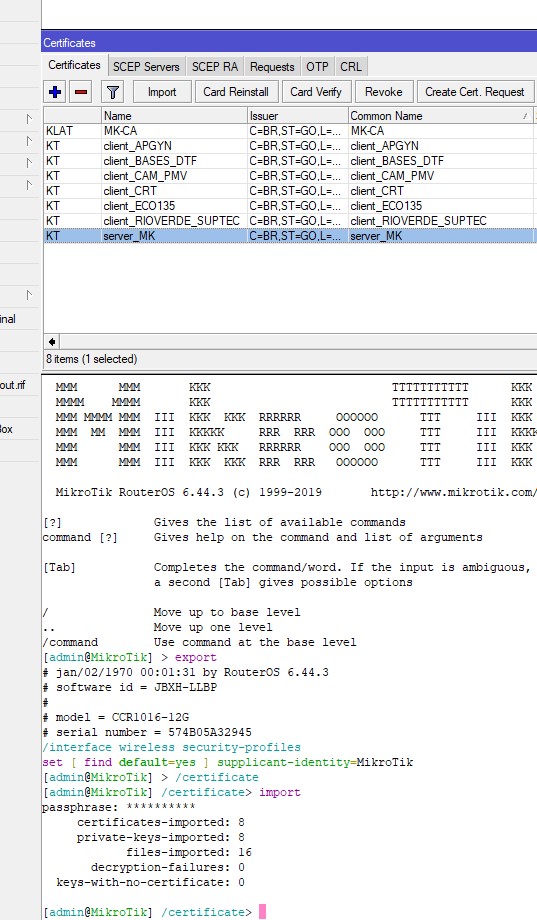

Now, I took the following steps in MK Backup (BKP).
1- Factory reset (Not default configuration)
2 - MK BKP, No settings
3- Import Certificate to MK BKP
4 - Not Working the VPN Error (TLS Failed)
Unfortunable it does not work, the VPN does not connect. But, if disable “required Client Certificate”, this work.

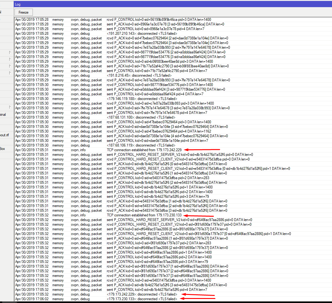

Please, see if the log is better.
You missed the clients side logs…
Thus guessing into the wild again: Is the Hostname on your server the same as on your original router? Must be since the certificate is only valid for identity “server_MK” so if your backup system has a different /system identity the client wont accept the server certificate.

08:07:17 ovpn,debug,packet rcvd P_CONTROL kid=0 sid=08cc6394b47b43e5 pid=3 DATA len=1400
08:07:17 ovpn,debug,packet sent P_ACK kid=0 sid=cd6c2e6757ed684e [3 sid=08cc6394b47b43e5] DATA len=0
08:07:17 ovpn,debug,packet sent P_CONTROL kid=0 sid=cd6c2e6757ed684e pid=4 DATA len=7
08:07:17 ovpn,debug <187.69.86.246>: disconnected <TLS failed>
08:07:17 ovpn,debug,packet rcvd P_CONTROL_HARD_RESET_CLIENT_V2 kid=0 sid=8d26e0ee9a2cd43f [0 sid=b156dbdc6951121c] pid=1 DATA len=0
08:07:17 ovpn,debug,packet sent P_ACK kid=0 sid=b156dbdc6951121c [1 sid=8d26e0ee9a2cd43f] DATA len=0
08:07:17 ovpn,debug,packet rcvd P_CONTROL kid=0 sid=8d26e0ee9a2cd43f pid=2 DATA len=283
08:07:17 ovpn,debug,packet sent P_ACK kid=0 sid=b156dbdc6951121c [2 sid=8d26e0ee9a2cd43f] DATA len=0
08:07:17 ovpn,debug,packet sent P_CONTROL kid=0 sid=b156dbdc6951121c pid=1 DATA len=1400
08:07:17 ovpn,debug,packet sent P_CONTROL kid=0 sid=b156dbdc6951121c pid=2 DATA len=1400
08:07:17 ovpn,debug,packet sent P_CONTROL kid=0 sid=b156dbdc6951121c pid=3 DATA len=79
08:07:17 ovpn,debug,packet rcvd P_ACK kid=0 sid=8d26e0ee9a2cd43f [1 sid=b156dbdc6951121c] DATA len=0
08:07:17 ovpn,debug,packet rcvd P_ACK kid=0 sid=8d26e0ee9a2cd43f [2 sid=b156dbdc6951121c] DATA len=0
08:07:17 ovpn,debug,packet rcvd P_ACK kid=0 sid=8d26e0ee9a2cd43f [3 sid=b156dbdc6951121c] DATA len=0
08:07:18 ovpn,info TCP connection established from 200.9.126.102
08:07:18 ovpn,debug,packet sent P_CONTROL_HARD_RESET_SERVER_V2 kid=0 sid=299189ea932f30e1 pid=0 DATA len=0
08:07:18 ovpn,debug,packet rcvd P_CONTROL_HARD_RESET_CLIENT_V2 kid=0 sid=6a1fad2a431ff322 pid=0 DATA len=0
08:07:18 ovpn,debug,packet sent P_ACK kid=0 sid=299189ea932f30e1 [0 sid=6a1fad2a431ff322] DATA len=0
08:07:18 ovpn,info TCP connection established from 179.150.174.205
08:07:18 ovpn,debug,packet sent P_CONTROL_HARD_RESET_SERVER_V2 kid=0 sid=b6cf43ad2e24c4c4 pid=0 DATA len=0
08:07:18 ovpn,debug,packet rcvd P_CONTROL_HARD_RESET_CLIENT_V2 kid=0 sid=548deae82b13e927 pid=0 DATA len=0
08:07:18 ovpn,debug,packet sent P_ACK kid=0 sid=b6cf43ad2e24c4c4 [0 sid=548deae82b13e927] DATA len=0
08:07:18 ovpn,debug,packet rcvd P_CONTROL_HARD_RESET_CLIENT_V2 kid=0 sid=6a1fad2a431ff322 [0 sid=299189ea932f30e1] pid=1 DATA len=0
08:07:18 ovpn,debug,packet sent P_ACK kid=0 sid=299189ea932f30e1 [1 sid=6a1fad2a431ff322] DATA len=0
08:07:18 ovpn,debug,packet rcvd P_CONTROL kid=0 sid=6a1fad2a431ff322 pid=2 DATA len=283
08:07:18 ovpn,debug,packet sent P_ACK kid=0 sid=299189ea932f30e1 [2 sid=6a1fad2a431ff322] DATA len=0
08:07:18 ovpn,debug,packet rcvd P_CONTROL_HARD_RESET_CLIENT_V2 kid=0 sid=548deae82b13e927 [0 sid=b6cf43ad2e24c4c4] pid=1 DATA len=0
08:07:18 ovpn,debug,packet sent P_ACK kid=0 sid=b6cf43ad2e24c4c4 [1 sid=548deae82b13e927] DATA len=0
08:07:18 ovpn,debug,packet rcvd P_CONTROL kid=0 sid=548deae82b13e927 pid=2 DATA len=283
08:07:18 ovpn,debug,packet sent P_ACK kid=0 sid=b6cf43ad2e24c4c4 [2 sid=548deae82b13e927] DATA len=0
08:07:19 ovpn,debug,packet sent P_CONTROL kid=0 sid=299189ea932f30e1 pid=1 DATA len=1400
08:07:19 ovpn,debug,packet sent P_CONTROL kid=0 sid=299189ea932f30e1 pid=2 DATA len=1400
08:07:19 ovpn,debug,packet sent P_CONTROL kid=0 sid=299189ea932f30e1 pid=3 DATA len=79
08:07:19 ovpn,debug,packet rcvd P_ACK kid=0 sid=6a1fad2a431ff322 [1 sid=299189ea932f30e1] DATA len=0
08:07:19 ovpn,debug,packet rcvd P_CONTROL kid=0 sid=8d26e0ee9a2cd43f pid=3 DATA len=1400
08:07:19 ovpn,debug,packet sent P_ACK kid=0 sid=b156dbdc6951121c [3 sid=8d26e0ee9a2cd43f] DATA len=0
08:07:19 ovpn,debug,packet sent P_CONTROL kid=0 sid=b156dbdc6951121c pid=4 DATA len=7
08:07:19 ovpn,debug <191.207.207.17>: disconnected <TLS failed>
08:07:19 ovpn,debug,packet sent P_CONTROL kid=0 sid=b6cf43ad2e24c4c4 pid=1 DATA len=1400
08:07:19 ovpn,debug,packet sent P_CONTROL kid=0 sid=b6cf43ad2e24c4c4 pid=2 DATA len=1400
08:07:19 ovpn,debug,packet sent P_CONTROL kid=0 sid=b6cf43ad2e24c4c4 pid=3 DATA len=79
08:07:19 ovpn,debug,packet rcvd P_ACK kid=0 sid=6a1fad2a431ff322 [2 sid=299189ea932f30e1] DATA len=0
08:07:19 ovpn,debug,packet rcvd P_ACK kid=0 sid=6a1fad2a431ff322 [3 sid=299189ea932f30e1] DATA len=0
08:07:19 ovpn,debug,packet rcvd P_ACK kid=0 sid=548deae82b13e927 [1 sid=b6cf43ad2e24c4c4] DATA len=0
08:07:19 ovpn,debug,packet rcvd P_ACK kid=0 sid=548deae82b13e927 [2 sid=b6cf43ad2e24c4c4] DATA len=0
08:07:19 ovpn,debug,packet rcvd P_ACK kid=0 sid=548deae82b13e927 [3 sid=b6cf43ad2e24c4c4] DATA len=0
08:07:19 ovpn,info TCP connection established from 187.2.142.65
08:07:19 ovpn,debug,packet sent P_CONTROL_HARD_RESET_SERVER_V2 kid=0 sid=0eafd69ce1c3e83 pid=0 DATA len=0
08:07:19 ovpn,debug,packet rcvd P_CONTROL_HARD_RESET_CLIENT_V2 kid=0 sid=61ac2f52e8203619 pid=0 DATA len=0
08:07:19 ovpn,debug,packet sent P_ACK kid=0 sid=0eafd69ce1c3e83 [0 sid=61ac2f52e8203619] DATA len=0
08:07:19 ovpn,info TCP connection established from 187.68.131.100
08:07:19 ovpn,debug,packet sent P_CONTROL_HARD_RESET_SERVER_V2 kid=0 sid=aaa5253dec49a9ca pid=0 DATA len=0
08:07:19 ovpn,debug,packet rcvd P_CONTROL_HARD_RESET_CLIENT_V2 kid=0 sid=5635d751a76dfd3c pid=0 DATA len=0
08:07:19 ovpn,debug,packet sent P_ACK kid=0 sid=aaa5253dec49a9ca [0 sid=5635d751a76dfd3c] DATA len=0
08:07:19 ovpn,debug,packet rcvd P_CONTROL_HARD_RESET_CLIENT_V2 kid=0 sid=61ac2f52e8203619 [0 sid=0eafd69ce1c3e83] pid=1 DATA len=0
08:07:19 ovpn,debug,packet sent P_ACK kid=0 sid=0eafd69ce1c3e83 [1 sid=61ac2f52e8203619] DATA len=0
08:07:19 ovpn,info TCP connection established from 179.242.106.114
08:07:19 ovpn,debug,packet sent P_CONTROL_HARD_RESET_SERVER_V2 kid=0 sid=30705daf7dd21374 pid=0 DATA len=0
08:07:19 ovpn,debug,packet rcvd P_CONTROL kid=0 sid=61ac2f52e8203619 pid=2 DATA len=283
08:07:19 ovpn,debug,packet sent P_ACK kid=0 sid=0eafd69ce1c3e83 [2 sid=61ac2f52e8203619] DATA len=0
08:07:19 ovpn,debug,packet rcvd P_CONTROL_HARD_RESET_CLIENT_V2 kid=0 sid=5635d751a76dfd3c [0 sid=aaa5253dec49a9ca] pid=1 DATA len=0
08:07:19 ovpn,debug,packet sent P_ACK kid=0 sid=aaa5253dec49a9ca [1 sid=5635d751a76dfd3c] DATA len=0
08:07:20 ovpn,debug,packet rcvd P_CONTROL kid=0 sid=5635d751a76dfd3c pid=2 DATA len=283
08:07:20 ovpn,debug,packet sent P_ACK kid=0 sid=aaa5253dec49a9ca [2 sid=5635d751a76dfd3c] DATA len=0
08:07:20 ovpn,debug,packet sent P_CONTROL kid=0 sid=0eafd69ce1c3e83 pid=1 DATA len=1400
08:07:20 ovpn,debug,packet sent P_CONTROL kid=0 sid=0eafd69ce1c3e83 pid=2 DATA len=1400
08:07:20 ovpn,debug,packet sent P_CONTROL kid=0 sid=0eafd69ce1c3e83 pid=3 DATA len=79
08:07:20 ovpn,debug,packet rcvd P_ACK kid=0 sid=61ac2f52e8203619 [1 sid=0eafd69ce1c3e83] DATA len=0
08:07:20 ovpn,info TCP connection established from 189.93.154.204
08:07:20 ovpn,debug,packet sent P_CONTROL_HARD_RESET_SERVER_V2 kid=0 sid=5aacee9cbe2ff2 pid=0 DATA len=0
08:07:20 ovpn,debug,packet rcvd P_CONTROL_HARD_RESET_CLIENT_V2 kid=0 sid=8dee7d9a74d387f pid=0 DATA len=0
08:07:20 ovpn,debug,packet sent P_ACK kid=0 sid=5aacee9cbe2ff2 [0 sid=8dee7d9a74d387f] DATA len=0
08:07:20 ovpn,debug,packet rcvd P_ACK kid=0 sid=61ac2f52e8203619 [2 sid=0eafd69ce1c3e83] DATA len=0
08:07:20 ovpn,debug,packet rcvd P_ACK kid=0 sid=61ac2f52e8203619 [3 sid=0eafd69ce1c3e83] DATA len=0
08:07:20 ovpn,debug,packet rcvd P_CONTROL_HARD_RESET_CLIENT_V2 kid=0 sid=8dee7d9a74d387f [0 sid=5aacee9cbe2ff2] pid=1 DATA len=0
08:07:20 ovpn,debug,packet sent P_ACK kid=0 sid=5aacee9cbe2ff2 [1 sid=8dee7d9a74d387f] DATA len=0
08:07:20 ovpn,debug,packet sent P_CONTROL kid=0 sid=aaa5253dec49a9ca pid=1 DATA len=1400
08:07:20 ovpn,debug,packet sent P_CONTROL kid=0 sid=aaa5253dec49a9ca pid=2 DATA len=1400
08:07:20 ovpn,debug,packet sent P_CONTROL kid=0 sid=aaa5253dec49a9ca pid=3 DATA len=79
08:07:20 ovpn,debug,packet rcvd P_ACK kid=0 sid=5635d751a76dfd3c [1 sid=aaa5253dec49a9ca] DATA len=0
08:07:20 ovpn,debug,packet rcvd P_CONTROL kid=0 sid=8dee7d9a74d387f pid=2 DATA len=283
08:07:20 ovpn,debug,packet sent P_ACK kid=0 sid=5aacee9cbe2ff2 [2 sid=8dee7d9a74d387f] DATA len=0
08:07:20 ovpn,debug,packet rcvd P_CONTROL kid=0 sid=6a1fad2a431ff322 pid=3 DATA len=1400
08:07:20 ovpn,debug,packet sent P_ACK kid=0 sid=299189ea932f30e1 [3 sid=6a1fad2a431ff322] DATA len=0
08:07:20 ovpn,debug,packet sent P_CONTROL kid=0 sid=299189ea932f30e1 pid=4 DATA len=7
08:07:20 ovpn,debug <200.9.126.102>: disconnected <TLS failed>
08:07:20 ovpn,debug,packet rcvd P_ACK kid=0 sid=5635d751a76dfd3c [2 sid=aaa5253dec49a9ca] DATA len=0
08:07:20 ovpn,debug,packet rcvd P_ACK kid=0 sid=5635d751a76dfd3c [3 sid=aaa5253dec49a9ca] DATA len=0
08:07:20 ovpn,info TCP connection established from 179.102.176.19
08:07:20 ovpn,debug,packet sent P_CONTROL_HARD_RESET_SERVER_V2 kid=0 sid=638d6eb59d9e25fa pid=0 DATA len=0
08:07:20 ovpn,debug,packet rcvd P_CONTROL_HARD_RESET_CLIENT_V2 kid=0 sid=0df14e5bf93087ec pid=0 DATA len=0
08:07:20 ovpn,debug,packet sent P_ACK kid=0 sid=638d6eb59d9e25fa [0 sid=0df14e5bf93087ec] DATA len=0
08:07:20 ovpn,debug,packet sent P_CONTROL kid=0 sid=5aacee9cbe2ff2 pid=1 DATA len=1400
08:07:20 ovpn,debug,packet sent P_CONTROL kid=0 sid=5aacee9cbe2ff2 pid=2 DATA len=1400
08:07:20 ovpn,debug,packet sent P_CONTROL kid=0 sid=5aacee9cbe2ff2 pid=3 DATA len=79
08:07:20 ovpn,debug,packet rcvd P_CONTROL_HARD_RESET_CLIENT_V2 kid=0 sid=0df14e5bf93087ec [0 sid=638d6eb59d9e25fa] pid=1 DATA len=0
08:07:20 ovpn,debug,packet sent P_ACK kid=0 sid=638d6eb59d9e25fa [1 sid=0df14e5bf93087ec] DATA len=0
08:07:20 ovpn,debug,packet rcvd P_ACK kid=0 sid=8dee7d9a74d387f [1 sid=5aacee9cbe2ff2] DATA len=0
08:07:20 ovpn,debug,packet rcvd P_CONTROL kid=0 sid=0df14e5bf93087ec pid=2 DATA len=283
08:07:20 ovpn,debug,packet sent P_ACK kid=0 sid=638d6eb59d9e25fa [2 sid=0df14e5bf93087ec] DATA len=0
08:07:20 ovpn,debug,packet rcvd P_ACK kid=0 sid=8dee7d9a74d387f [2 sid=5aacee9cbe2ff2] DATA len=0
08:07:20 ovpn,debug,packet rcvd P_ACK kid=0 sid=8dee7d9a74d387f [3 sid=5aacee9cbe2ff2] DATA len=0
08:07:20 ovpn,debug,packet sent P_CONTROL kid=0 sid=638d6eb59d9e25fa pid=1 DATA len=1400
08:07:20 ovpn,debug,packet sent P_CONTROL kid=0 sid=638d6eb59d9e25fa pid=2 DATA len=1400
08:07:20 ovpn,debug,packet sent P_CONTROL kid=0 sid=638d6eb59d9e25fa pid=3 DATA len=79
08:07:20 ovpn,debug,packet rcvd P_CONTROL kid=0 sid=548deae82b13e927 pid=3 DATA len=1400
08:07:20 ovpn,debug,packet sent P_ACK kid=0 sid=b6cf43ad2e24c4c4 [3 sid=548deae82b13e927] DATA len=0
08:07:20 ovpn,debug,packet sent P_CONTROL kid=0 sid=b6cf43ad2e24c4c4 pid=4 DATA len=7
08:07:20 ovpn,debug <179.150.174.205>: disconnected <TLS failed>
08:07:20 ovpn,debug,packet rcvd P_ACK kid=0 sid=0df14e5bf93087ec [1 sid=638d6eb59d9e25fa] DATA len=0
08:07:21 ovpn,debug,packet rcvd P_ACK kid=0 sid=0df14e5bf93087ec [2 sid=638d6eb59d9e25fa] DATA len=0
08:07:21 ovpn,debug,packet rcvd P_ACK kid=0 sid=0df14e5bf93087ec [3 sid=638d6eb59d9e25fa] DATA len=0
08:07:21 ovpn,debug,packet rcvd P_CONTROL_HARD_RESET_CLIENT_V2 kid=0 sid=452eecfe4dd667d7 pid=0 DATA len=0
08:07:21 ovpn,debug,packet sent P_ACK kid=0 sid=30705daf7dd21374 [0 sid=452eecfe4dd667d7] DATA len=0
08:07:21 ovpn,debug,packet rcvd P_CONTROL kid=0 sid=5635d751a76dfd3c pid=3 DATA len=1400
08:07:21 ovpn,debug,packet sent P_ACK kid=0 sid=aaa5253dec49a9ca [3 sid=5635d751a76dfd3c] DATA len=0
08:07:21 ovpn,debug,packet sent P_CONTROL kid=0 sid=aaa5253dec49a9ca pid=4 DATA len=7
08:07:21 ovpn,debug <187.68.131.100>: disconnected <TLS failed>
08:07:21 ovpn,debug,packet rcvd P_CONTROL kid=0 sid=8dee7d9a74d387f pid=3 DATA len=1400
08:07:21 ovpn,debug,packet sent P_ACK kid=0 sid=5aacee9cbe2ff2 [3 sid=8dee7d9a74d387f] DATA len=0
08:07:21 ovpn,debug,packet sent P_CONTROL kid=0 sid=5aacee9cbe2ff2 pid=4 DATA len=7
08:07:21 ovpn,debug <189.93.154.204>: disconnected <TLS failed>
08:07:22 ovpn,debug,packet rcvd P_CONTROL kid=0 sid=0df14e5bf93087ec pid=3 DATA len=1400
08:07:22 ovpn,debug,packet sent P_ACK kid=0 sid=638d6eb59d9e25fa [3 sid=0df14e5bf93087ec] DATA len=0
08:07:22 ovpn,debug,packet sent P_CONTROL kid=0 sid=638d6eb59d9e25fa pid=4 DATA len=7
08:07:22 ovpn,debug <179.102.176.19>: disconnected <TLS failed>
08:07:22 ovpn,debug,packet rcvd P_CONTROL kid=0 sid=61ac2f52e8203619 pid=3 DATA len=1400
08:07:22 ovpn,debug,packet sent P_ACK kid=0 sid=0eafd69ce1c3e83 [3 sid=61ac2f52e8203619] DATA len=0
08:07:22 ovpn,debug,packet sent P_CONTROL kid=0 sid=0eafd69ce1c3e83 pid=4 DATA len=7
08:07:22 ovpn,debug <187.2.142.65>: disconnected <TLS failed>
08:07:22 ovpn,info TCP connection established from 191.11.230.207
08:07:22 ovpn,debug,packet sent P_CONTROL_HARD_RESET_SERVER_V2 kid=0 sid=17755e1feadb52e8 pid=0 DATA len=0
08:07:22 ovpn,debug,packet rcvd P_CONTROL_HARD_RESET_CLIENT_V2 kid=0 sid=fbd132b7409cdc25 pid=0 DATA len=0
08:07:22 ovpn,debug,packet sent P_ACK kid=0 sid=17755e1feadb52e8 [0 sid=fbd132b7409cdc25] DATA len=0
08:07:22 ovpn,debug,packet rcvd P_CONTROL_HARD_RESET_CLIENT_V2 kid=0 sid=fbd132b7409cdc25 [0 sid=17755e1feadb52e8] pid=1 DATA len=0
08:07:22 ovpn,debug,packet sent P_ACK kid=0 sid=17755e1feadb52e8 [1 sid=fbd132b7409cdc25] DATA len=0
08:07:22 ovpn,debug,packet rcvd P_CONTROL kid=0 sid=fbd132b7409cdc25 pid=2 DATA len=283
08:07:22 ovpn,debug,packet sent P_ACK kid=0 sid=17755e1feadb52e8 [2 sid=fbd132b7409cdc25] DATA len=0
08:07:22 ovpn,debug,packet sent P_CONTROL kid=0 sid=17755e1feadb52e8 pid=1 DATA len=1400
08:07:22 ovpn,debug,packet sent P_CONTROL kid=0 sid=17755e1feadb52e8 pid=2 DATA len=1400
08:07:22 ovpn,debug,packet sent P_CONTROL kid=0 sid=17755e1feadb52e8 pid=3 DATA len=79
08:07:22 ovpn,debug,packet rcvd P_ACK kid=0 sid=fbd132b7409cdc25 [1 sid=17755e1feadb52e8] DATA len=0
08:07:23 ovpn,debug,packet rcvd P_ACK kid=0 sid=fbd132b7409cdc25 [2 sid=17755e1feadb52e8] DATA len=0
08:07:23 ovpn,debug,packet rcvd P_ACK kid=0 sid=fbd132b7409cdc25 [3 sid=17755e1feadb52e8] DATA len=0
08:07:23 ovpn,info TCP connection established from 191.207.231.204
08:07:23 ovpn,debug,packet sent P_CONTROL_HARD_RESET_SERVER_V2 kid=0 sid=0ae0b5138072382c pid=0 DATA len=0
08:07:23 ovpn,debug,packet rcvd P_CONTROL_HARD_RESET_CLIENT_V2 kid=0 sid=7b9b2b01f86e2ae pid=0 DATA len=0
08:07:23 ovpn,debug,packet sent P_ACK kid=0 sid=0ae0b5138072382c [0 sid=7b9b2b01f86e2ae] DATA len=0
08:07:23 ovpn,debug,packet rcvd P_CONTROL_HARD_RESET_CLIENT_V2 kid=0 sid=7b9b2b01f86e2ae [0 sid=0ae0b5138072382c] pid=1 DATA len=0
08:07:23 ovpn,debug,packet sent P_ACK kid=0 sid=0ae0b5138072382c [1 sid=7b9b2b01f86e2ae] DATA len=0
08:07:23 ovpn,debug,packet rcvd P_CONTROL kid=0 sid=7b9b2b01f86e2ae pid=2 DATA len=283
08:07:23 ovpn,debug,packet sent P_ACK kid=0 sid=0ae0b5138072382c [2 sid=7b9b2b01f86e2ae] DATA len=0
08:07:23 ovpn,debug,packet sent P_CONTROL kid=0 sid=0ae0b5138072382c pid=1 DATA len=1400
08:07:23 ovpn,debug,packet sent P_CONTROL kid=0 sid=0ae0b5138072382c pid=2 DATA len=1400
08:07:23 ovpn,debug,packet sent P_CONTROL kid=0 sid=0ae0b5138072382c pid=3 DATA len=79
08:07:23 ovpn,debug,packet rcvd P_ACK kid=0 sid=7b9b2b01f86e2ae [1 sid=0ae0b5138072382c] DATA len=0
08:07:23 ovpn,debug,packet rcvd P_ACK kid=0 sid=7b9b2b01f86e2ae [2 sid=0ae0b5138072382c] DATA len=0
08:07:23 ovpn,debug,packet rcvd P_ACK kid=0 sid=7b9b2b01f86e2ae [3 sid=0ae0b5138072382c] DATA len=0
08:07:23 ovpn,debug,packet rcvd P_CONTROL_HARD_RESET_CLIENT_V2 kid=0 sid=452eecfe4dd667d7 [0 sid=30705daf7dd21374] pid=1 DATA len=0
08:07:23 ovpn,debug,packet sent P_ACK kid=0 sid=30705daf7dd21374 [1 sid=452eecfe4dd667d7] DATA len=0
08:07:23 ovpn,debug,packet rcvd P_CONTROL kid=0 sid=452eecfe4dd667d7 pid=2 DATA len=283
08:07:23 ovpn,debug,packet sent P_ACK kid=0 sid=30705daf7dd21374 [2 sid=452eecfe4dd667d7] DATA len=0
08:07:23 ovpn,debug,packet sent P_CONTROL kid=0 sid=30705daf7dd21374 pid=1 DATA len=1400
08:07:23 ovpn,debug,packet sent P_CONTROL kid=0 sid=30705daf7dd21374 pid=2 DATA len=1400
08:07:23 ovpn,debug,packet sent P_CONTROL kid=0 sid=30705daf7dd21374 pid=3 DATA len=79
08:07:24 ovpn,debug,packet rcvd P_CONTROL kid=0 sid=fbd132b7409cdc25 pid=3 DATA len=1400
08:07:24 ovpn,debug,packet sent P_ACK kid=0 sid=17755e1feadb52e8 [3 sid=fbd132b7409cdc25] DATA len=0
08:07:24 ovpn,debug,packet sent P_CONTROL kid=0 sid=17755e1feadb52e8 pid=4 DATA len=7
08:07:24 ovpn,debug <191.11.230.207>: disconnected <TLS failed>
08:07:24 ovpn,info TCP connection established from 191.11.243.178
08:07:24 ovpn,debug,packet sent P_CONTROL_HARD_RESET_SERVER_V2 kid=0 sid=ffb66c8d25212ac3 pid=0 DATA len=0
08:07:24 ovpn,debug,packet rcvd P_CONTROL_HARD_RESET_CLIENT_V2 kid=0 sid=a13552c7a625642 pid=0 DATA len=0
08:07:24 ovpn,debug,packet sent P_ACK kid=0 sid=ffb66c8d25212ac3 [0 sid=a13552c7a625642] DATA len=0
08:07:24 ovpn,debug,packet rcvd P_CONTROL kid=0 sid=7b9b2b01f86e2ae pid=3 DATA len=1400
08:07:24 ovpn,debug,packet sent P_ACK kid=0 sid=0ae0b5138072382c [3 sid=7b9b2b01f86e2ae] DATA len=0
08:07:24 ovpn,debug,packet sent P_CONTROL kid=0 sid=0ae0b5138072382c pid=4 DATA len=7
08:07:24 ovpn,debug <191.207.231.204>: disconnected <TLS failed>
08:07:24 ovpn,debug,packet rcvd P_CONTROL_HARD_RESET_CLIENT_V2 kid=0 sid=a13552c7a625642 [0 sid=ffb66c8d25212ac3] pid=1 DATA len=0
08:07:24 ovpn,debug,packet sent P_ACK kid=0 sid=ffb66c8d25212ac3 [1 sid=a13552c7a625642] DATA len=0
08:07:24 ovpn,debug,packet rcvd P_ACK kid=0 sid=452eecfe4dd667d7 [1 sid=30705daf7dd21374] DATA len=0
08:07:24 ovpn,debug,packet rcvd P_CONTROL kid=0 sid=a13552c7a625642 pid=2 DATA len=283
08:07:24 ovpn,debug,packet sent P_ACK kid=0 sid=ffb66c8d25212ac3 [2 sid=a13552c7a625642] DATA len=0
08:07:24 ovpn,debug,packet sent P_CONTROL kid=0 sid=ffb66c8d25212ac3 pid=1 DATA len=1400
08:07:24 ovpn,debug,packet sent P_CONTROL kid=0 sid=ffb66c8d25212ac3 pid=2 DATA len=1400
08:07:24 ovpn,debug,packet sent P_CONTROL kid=0 sid=ffb66c8d25212ac3 pid=3 DATA len=79
08:07:25 ovpn,info TCP connection established from 187.68.106.119
08:07:25 ovpn,debug,packet sent P_CONTROL_HARD_RESET_SERVER_V2 kid=0 sid=178f129613ea6fb2 pid=0 DATA len=0
08:07:25 ovpn,debug,packet rcvd P_ACK kid=0 sid=a13552c7a625642 [1 sid=ffb66c8d25212ac3] DATA len=0
08:07:25 ovpn,debug,packet rcvd P_ACK kid=0 sid=452eecfe4dd667d7 [2 sid=30705daf7dd21374] DATA len=0
08:07:25 ovpn,debug,packet rcvd P_ACK kid=0 sid=452eecfe4dd667d7 [3 sid=30705daf7dd21374] DATA len=0
08:07:25 ovpn,debug,packet rcvd P_ACK kid=0 sid=a13552c7a625642 [2 sid=ffb66c8d25212ac3] DATA len=0
08:07:25 ovpn,debug,packet rcvd P_ACK kid=0 sid=a13552c7a625642 [3 sid=ffb66c8d25212ac3] DATA len=0
08:07:25 ovpn,debug,packet rcvd P_CONTROL_HARD_RESET_CLIENT_V2 kid=0 sid=c778522662b5256 pid=0 DATA len=0
08:07:25 ovpn,debug,packet sent P_ACK kid=0 sid=178f129613ea6fb2 [0 sid=c778522662b5256] DATA len=0
08:07:26 ovpn,debug,packet rcvd P_CONTROL kid=0 sid=452eecfe4dd667d7 pid=3 DATA len=1400
08:07:26 ovpn,debug,packet sent P_ACK kid=0 sid=30705daf7dd21374 [3 sid=452eecfe4dd667d7] DATA len=0
08:07:26 ovpn,debug,packet sent P_CONTROL kid=0 sid=30705daf7dd21374 pid=4 DATA len=7
08:07:26 ovpn,debug <179.242.106.114>: disconnected <TLS failed>
08:07:26 ovpn,debug,packet rcvd P_CONTROL kid=0 sid=a13552c7a625642 pid=3 DATA len=1400
08:07:26 ovpn,debug,packet sent P_ACK kid=0 sid=ffb66c8d25212ac3 [3 sid=a13552c7a625642] DATA len=0
08:07:26 ovpn,debug,packet sent P_CONTROL kid=0 sid=ffb66c8d25212ac3 pid=4 DATA len=7
08:07:26 ovpn,debug <191.11.243.178>: disconnected <TLS failed>
08:07:26 ovpn,info TCP connection established from 187.68.245.99
08:07:26 ovpn,debug,packet sent P_CONTROL_HARD_RESET_SERVER_V2 kid=0 sid=2411e9f172088e8 pid=0 DATA len=0
08:07:26 ovpn,debug,packet rcvd P_CONTROL_HARD_RESET_CLIENT_V2 kid=0 sid=1954c2b8cdc524a7 pid=0 DATA len=0
08:07:26 ovpn,debug,packet sent P_ACK kid=0 sid=2411e9f172088e8 [0 sid=1954c2b8cdc524a7] DATA len=0
08:07:26 ovpn,debug,packet rcvd P_CONTROL_HARD_RESET_CLIENT_V2 kid=0 sid=1954c2b8cdc524a7 [0 sid=2411e9f172088e8] pid=1 DATA len=0
08:07:26 ovpn,debug,packet sent P_ACK kid=0 sid=2411e9f172088e8 [1 sid=1954c2b8cdc524a7] DATA len=0
08:07:26 ovpn,debug,packet rcvd P_CONTROL kid=0 sid=1954c2b8cdc524a7 pid=2 DATA len=283
08:07:26 ovpn,debug,packet sent P_ACK kid=0 sid=2411e9f172088e8 [2 sid=1954c2b8cdc524a7] DATA len=0
08:07:26 ovpn,debug,packet sent P_CONTROL kid=0 sid=2411e9f172088e8 pid=1 DATA len=1400
08:07:26 ovpn,debug,packet sent P_CONTROL kid=0 sid=2411e9f172088e8 pid=2 DATA len=1400
08:07:26 ovpn,debug,packet sent P_CONTROL kid=0 sid=2411e9f172088e8 pid=3 DATA len=79
08:07:26 ovpn,debug,packet rcvd P_ACK kid=0 sid=1954c2b8cdc524a7 [1 sid=2411e9f172088e8] DATA len=0
08:07:26 ovpn,debug,packet rcvd P_ACK kid=0 sid=1954c2b8cdc524a7 [2 sid=2411e9f172088e8] DATA len=0
08:07:26 ovpn,debug,packet rcvd P_ACK kid=0 sid=1954c2b8cdc524a7 [3 sid=2411e9f172088e8] DATA len=0
08:07:27 ovpn,debug,packet rcvd P_CONTROL_HARD_RESET_CLIENT_V2 kid=0 sid=c778522662b5256 [0 sid=178f129613ea6fb2] pid=1 DATA len=0
08:07:27 ovpn,debug,packet sent P_ACK kid=0 sid=178f129613ea6fb2 [1 sid=c778522662b5256] DATA len=0
08:07:27 ovpn,debug,packet rcvd P_CONTROL kid=0 sid=c778522662b5256 pid=2 DATA len=283
08:07:27 ovpn,debug,packet sent P_ACK kid=0 sid=178f129613ea6fb2 [2 sid=c778522662b5256] DATA len=0
08:07:27 ovpn,debug,packet sent P_CONTROL kid=0 sid=178f129613ea6fb2 pid=1 DATA len=1400
08:07:27 ovpn,debug,packet sent P_CONTROL kid=0 sid=178f129613ea6fb2 pid=2 DATA len=1400
08:07:27 ovpn,debug,packet sent P_CONTROL kid=0 sid=178f129613ea6fb2 pid=3 DATA len=79
08:07:27 ovpn,info TCP connection established from 187.69.86.246
08:07:27 ovpn,debug,packet sent P_CONTROL_HARD_RESET_SERVER_V2 kid=0 sid=0a36e3c877df5aed pid=0 DATA len=0
08:07:27 ovpn,debug,packet rcvd P_CONTROL_HARD_RESET_CLIENT_V2 kid=0 sid=8b102f34dcc1dfa5 pid=0 DATA len=0
08:07:27 ovpn,debug,packet sent P_ACK kid=0 sid=0a36e3c877df5aed [0 sid=8b102f34dcc1dfa5] DATA len=0
08:07:27 ovpn,debug,packet rcvd P_CONTROL_HARD_RESET_CLIENT_V2 kid=0 sid=8b102f34dcc1dfa5 [0 sid=0a36e3c877df5aed] pid=1 DATA len=0
08:07:27 ovpn,debug,packet sent P_ACK kid=0 sid=0a36e3c877df5aed [1 sid=8b102f34dcc1dfa5] DATA len=0
08:07:27 ovpn,debug,packet rcvd P_CONTROL kid=0 sid=8b102f34dcc1dfa5 pid=2 DATA len=283
08:07:27 ovpn,debug,packet sent P_ACK kid=0 sid=0a36e3c877df5aed [2 sid=8b102f34dcc1dfa5] DATA len=0
08:07:27 ovpn,debug,packet sent P_CONTROL kid=0 sid=0a36e3c877df5aed pid=1 DATA len=1400
08:07:27 ovpn,debug,packet sent P_CONTROL kid=0 sid=0a36e3c877df5aed pid=2 DATA len=1400
08:07:27 ovpn,debug,packet sent P_CONTROL kid=0 sid=0a36e3c877df5aed pid=3 DATA len=79
08:07:27 ovpn,debug,packet rcvd P_ACK kid=0 sid=8b102f34dcc1dfa5 [1 sid=0a36e3c877df5aed] DATA len=0
08:07:27 ovpn,debug,packet rcvd P_ACK kid=0 sid=8b102f34dcc1dfa5 [2 sid=0a36e3c877df5aed] DATA len=0
08:07:27 ovpn,debug,packet rcvd P_ACK kid=0 sid=8b102f34dcc1dfa5 [3 sid=0a36e3c877df5aed] DATA len=0
08:07:28 ovpn,debug,packet rcvd P_CONTROL kid=0 sid=1954c2b8cdc524a7 pid=3 DATA len=1400
08:07:28 ovpn,debug,packet sent P_ACK kid=0 sid=2411e9f172088e8 [3 sid=1954c2b8cdc524a7] DATA len=0
08:07:28 ovpn,debug,packet sent P_CONTROL kid=0 sid=2411e9f172088e8 pid=4 DATA len=7
08:07:28 ovpn,debug <187.68.245.99>: disconnected <TLS failed>
08:07:28 ovpn,debug,packet rcvd P_ACK kid=0 sid=c778522662b5256 [1 sid=178f129613ea6fb2] DATA len=0
08:07:28 ovpn,debug,packet rcvd P_ACK kid=0 sid=c778522662b5256 [2 sid=178f129613ea6fb2] DATA len=0

08:07:34 ovpn,debug,packet sent P_ACK kid=0 sid=f5464f4e9b3f16e4 [2 sid=4657b9c7f3d814cf] DATA len=0
08:07:34 ovpn,debug,packet sent P_CONTROL kid=0 sid=f5464f4e9b3f16e4 pid=1 DATA len=1400
08:07:34 ovpn,debug,packet sent P_CONTROL kid=0 sid=f5464f4e9b3f16e4 pid=2 DATA len=1400
08:07:34 ovpn,debug,packet sent P_CONTROL kid=0 sid=f5464f4e9b3f16e4 pid=3 DATA len=79
08:07:34 ovpn,debug,packet rcvd P_ACK kid=0 sid=4657b9c7f3d814cf [1 sid=f5464f4e9b3f16e4] DATA len=0
08:07:34 ovpn,debug,packet rcvd P_CONTROL kid=0 sid=086b143a43b97d7b pid=3 DATA len=1400
08:07:34 ovpn,debug,packet sent P_ACK kid=0 sid=80b67ffa3cac63b [3 sid=086b143a43b97d7b] DATA len=0
08:07:34 ovpn,debug,packet rcvd P_ACK kid=0 sid=4657b9c7f3d814cf [2 sid=f5464f4e9b3f16e4] DATA len=0
08:07:34 ovpn,debug,packet rcvd P_ACK kid=0 sid=4657b9c7f3d814cf [3 sid=f5464f4e9b3f16e4] DATA len=0
08:07:34 ovpn,debug,packet sent P_CONTROL kid=0 sid=80b67ffa3cac63b pid=4 DATA len=7
08:07:34 ovpn,debug <187.2.142.65>: disconnected <TLS failed>
08:07:34 ovpn,info TCP connection established from 191.207.231.204
08:07:34 ovpn,debug,packet sent P_CONTROL_HARD_RESET_SERVER_V2 kid=0 sid=a24fed3112bc59f pid=0 DATA len=0
08:07:34 ovpn,debug,packet rcvd P_CONTROL_HARD_RESET_CLIENT_V2 kid=0 sid=cf3fdd67b61f7fc pid=0 DATA len=0
08:07:34 ovpn,debug,packet sent P_ACK kid=0 sid=a24fed3112bc59f [0 sid=cf3fdd67b61f7fc] DATA len=0
08:07:34 ovpn,debug,packet rcvd P_CONTROL_HARD_RESET_CLIENT_V2 kid=0 sid=cf3fdd67b61f7fc [0 sid=a24fed3112bc59f] pid=1 DATA len=0
08:07:34 ovpn,debug,packet sent P_ACK kid=0 sid=a24fed3112bc59f [1 sid=cf3fdd67b61f7fc] DATA len=0
08:07:34 ovpn,debug,packet rcvd P_CONTROL kid=0 sid=cf3fdd67b61f7fc pid=2 DATA len=283
08:07:34 ovpn,debug,packet sent P_ACK kid=0 sid=a24fed3112bc59f [2 sid=cf3fdd67b61f7fc] DATA len=0
08:07:35 ovpn,debug,packet sent P_CONTROL kid=0 sid=a24fed3112bc59f pid=1 DATA len=1400
08:07:35 ovpn,debug,packet sent P_CONTROL kid=0 sid=a24fed3112bc59f pid=2 DATA len=1400
08:07:35 ovpn,debug,packet sent P_CONTROL kid=0 sid=a24fed3112bc59f pid=3 DATA len=79
08:07:35 ovpn,debug,packet rcvd P_ACK kid=0 sid=cf3fdd67b61f7fc [1 sid=a24fed3112bc59f] DATA len=0
08:07:35 ovpn,debug,packet rcvd P_ACK kid=0 sid=cf3fdd67b61f7fc [2 sid=a24fed3112bc59f] DATA len=0
08:07:35 ovpn,debug,packet rcvd P_ACK kid=0 sid=cf3fdd67b61f7fc [3 sid=a24fed3112bc59f] DATA len=0
08:07:35 ovpn,debug,packet rcvd P_CONTROL kid=0 sid=251d228a7984e173 pid=3 DATA len=1400
08:07:35 ovpn,debug,packet sent P_ACK kid=0 sid=892e5fca95b2a79 [3 sid=251d228a7984e173] DATA len=0
08:07:35 ovpn,debug,packet sent P_CONTROL kid=0 sid=892e5fca95b2a79 pid=4 DATA len=7
08:07:35 ovpn,debug <189.84.177.130>: disconnected <TLS failed>
08:07:35 ovpn,debug,packet rcvd P_CONTROL kid=0 sid=4657b9c7f3d814cf pid=3 DATA len=1400
08:07:35 ovpn,debug,packet sent P_ACK kid=0 sid=f5464f4e9b3f16e4 [3 sid=4657b9c7f3d814cf] DATA len=0
08:07:35 ovpn,debug,packet sent P_CONTROL kid=0 sid=f5464f4e9b3f16e4 pid=4 DATA len=7
08:07:35 ovpn,debug <191.11.230.207>: disconnected <TLS failed>
08:07:36 ovpn,info TCP connection established from 191.11.243.178
08:07:36 ovpn,debug,packet sent P_CONTROL_HARD_RESET_SERVER_V2 kid=0 sid=c3476313cb6ba8f8 pid=0 DATA len=0
08:07:36 ovpn,debug,packet rcvd P_CONTROL_HARD_RESET_CLIENT_V2 kid=0 sid=2e77d1d1c0b880dc pid=0 DATA len=0
08:07:36 ovpn,debug,packet sent P_ACK kid=0 sid=c3476313cb6ba8f8 [0 sid=2e77d1d1c0b880dc] DATA len=0
08:07:36 ovpn,debug,packet rcvd P_CONTROL_HARD_RESET_CLIENT_V2 kid=0 sid=2e77d1d1c0b880dc [0 sid=c3476313cb6ba8f8] pid=1 DATA len=0
08:07:36 ovpn,debug,packet sent P_ACK kid=0 sid=c3476313cb6ba8f8 [1 sid=2e77d1d1c0b880dc] DATA len=0
08:07:36 ovpn,info TCP connection established from 179.242.106.114
08:07:36 ovpn,debug,packet sent P_CONTROL_HARD_RESET_SERVER_V2 kid=0 sid=4dfe11ac3485df1c pid=0 DATA len=0
08:07:36 ovpn,debug,packet rcvd P_CONTROL kid=0 sid=2e77d1d1c0b880dc pid=2 DATA len=283
08:07:36 ovpn,debug,packet sent P_ACK kid=0 sid=c3476313cb6ba8f8 [2 sid=2e77d1d1c0b880dc] DATA len=0
08:07:36 ovpn,debug,packet rcvd P_CONTROL kid=0 sid=cf3fdd67b61f7fc pid=3 DATA len=1400
08:07:36 ovpn,debug,packet sent P_ACK kid=0 sid=a24fed3112bc59f [3 sid=cf3fdd67b61f7fc] DATA len=0
08:07:36 ovpn,debug,packet sent P_CONTROL kid=0 sid=a24fed3112bc59f pid=4 DATA len=7
08:07:36 ovpn,debug <191.207.231.204>: disconnected <TLS failed>
08:07:36 ovpn,debug,packet sent P_CONTROL kid=0 sid=c3476313cb6ba8f8 pid=1 DATA len=1400
08:07:36 ovpn,debug,packet sent P_CONTROL kid=0 sid=c3476313cb6ba8f8 pid=2 DATA len=1400
08:07:36 ovpn,debug,packet sent P_CONTROL kid=0 sid=c3476313cb6ba8f8 pid=3 DATA len=79
08:07:36 ovpn,debug,packet rcvd P_ACK kid=0 sid=2e77d1d1c0b880dc [1 sid=c3476313cb6ba8f8] DATA len=0
08:07:36 ovpn,debug,packet rcvd P_ACK kid=0 sid=2e77d1d1c0b880dc [2 sid=c3476313cb6ba8f8] DATA len=0
08:07:36 ovpn,debug,packet rcvd P_ACK kid=0 sid=2e77d1d1c0b880dc [3 sid=c3476313cb6ba8f8] DATA len=0
08:07:37 ovpn,debug,packet rcvd P_CONTROL_HARD_RESET_CLIENT_V2 kid=0 sid=da77436584aea9ee pid=0 DATA len=0
08:07:37 ovpn,debug,packet sent P_ACK kid=0 sid=4dfe11ac3485df1c [0 sid=da77436584aea9ee] DATA len=0
08:07:38 ovpn,debug,packet rcvd P_CONTROL kid=0 sid=2e77d1d1c0b880dc pid=3 DATA len=1400
08:07:38 ovpn,debug,packet sent P_ACK kid=0 sid=c3476313cb6ba8f8 [3 sid=2e77d1d1c0b880dc] DATA len=0
08:07:38 ovpn,debug,packet sent P_CONTROL kid=0 sid=c3476313cb6ba8f8 pid=4 DATA len=7
08:07:38 ovpn,debug <191.11.243.178>: disconnected <TLS failed>
08:07:38 ovpn,info TCP connection established from 187.68.245.99
08:07:38 ovpn,debug,packet sent P_CONTROL_HARD_RESET_SERVER_V2 kid=0 sid=987ac7603919edc pid=0 DATA len=0
08:07:38 ovpn,debug,packet rcvd P_CONTROL_HARD_RESET_CLIENT_V2 kid=0 sid=407b6dceee69982 pid=0 DATA len=0
08:07:38 ovpn,debug,packet sent P_ACK kid=0 sid=987ac7603919edc [0 sid=407b6dceee69982] DATA len=0
08:07:38 ovpn,debug,packet rcvd P_CONTROL_HARD_RESET_CLIENT_V2 kid=0 sid=407b6dceee69982 [0 sid=987ac7603919edc] pid=1 DATA len=0
08:07:38 ovpn,debug,packet sent P_ACK kid=0 sid=987ac7603919edc [1 sid=407b6dceee69982] DATA len=0
08:07:38 ovpn,debug,packet rcvd P_CONTROL kid=0 sid=407b6dceee69982 pid=2 DATA len=283
08:07:38 ovpn,debug,packet sent P_ACK kid=0 sid=987ac7603919edc [2 sid=407b6dceee69982] DATA len=0
08:07:38 ovpn,debug,packet sent P_CONTROL kid=0 sid=987ac7603919edc pid=1 DATA len=1400
08:07:38 ovpn,debug,packet sent P_CONTROL kid=0 sid=987ac7603919edc pid=2 DATA len=1400
08:07:38 ovpn,debug,packet sent P_CONTROL kid=0 sid=987ac7603919edc pid=3 DATA len=79
08:07:38 ovpn,debug,packet rcvd P_ACK kid=0 sid=407b6dceee69982 [1 sid=987ac7603919edc] DATA len=0
08:07:38 ovpn,debug,packet rcvd P_ACK kid=0 sid=407b6dceee69982 [2 sid=987ac7603919edc] DATA len=0
08:07:38 ovpn,debug,packet rcvd P_ACK kid=0 sid=407b6dceee69982 [3 sid=987ac7603919edc] DATA len=0
08:07:39 ovpn,info TCP connection established from 187.69.86.246
08:07:39 ovpn,debug,packet sent P_CONTROL_HARD_RESET_SERVER_V2 kid=0 sid=437e1d4a7ec01444 pid=0 DATA len=0
08:07:39 ovpn,debug,packet rcvd P_CONTROL_HARD_RESET_CLIENT_V2 kid=0 sid=f3f6496196e55373 pid=0 DATA len=0
08:07:39 ovpn,debug,packet sent P_ACK kid=0 sid=437e1d4a7ec01444 [0 sid=f3f6496196e55373] DATA len=0
08:07:39 ovpn,debug,packet rcvd P_CONTROL_HARD_RESET_CLIENT_V2 kid=0 sid=f3f6496196e55373 [0 sid=437e1d4a7ec01444] pid=1 DATA len=0
08:07:39 ovpn,debug,packet sent P_ACK kid=0 sid=437e1d4a7ec01444 [1 sid=f3f6496196e55373] DATA len=0
08:07:39 ovpn,debug,packet rcvd P_CONTROL kid=0 sid=f3f6496196e55373 pid=2 DATA len=283
08:07:39 ovpn,debug,packet sent P_ACK kid=0 sid=437e1d4a7ec01444 [2 sid=f3f6496196e55373] DATA len=0
08:07:39 ovpn,info TCP connection established from 187.68.106.119
08:07:39 ovpn,debug,packet sent P_CONTROL_HARD_RESET_SERVER_V2 kid=0 sid=1a6f0bba2ea33f pid=0 DATA len=0
08:07:39 ovpn,debug,packet rcvd P_CONTROL_HARD_RESET_CLIENT_V2 kid=0 sid=53ba9b9891f3840 pid=0 DATA len=0
08:07:39 ovpn,debug,packet sent P_ACK kid=0 sid=1a6f0bba2ea33f [0 sid=53ba9b9891f3840] DATA len=0
08:07:39 ovpn,debug,packet sent P_CONTROL kid=0 sid=437e1d4a7ec01444 pid=1 DATA len=1400
08:07:39 ovpn,debug,packet sent P_CONTROL kid=0 sid=437e1d4a7ec01444 pid=2 DATA len=1400
08:07:39 ovpn,debug,packet sent P_CONTROL kid=0 sid=437e1d4a7ec01444 pid=3 DATA len=79
08:07:39 ovpn,debug,packet rcvd P_CONTROL_HARD_RESET_CLIENT_V2 kid=0 sid=53ba9b9891f3840 [0 sid=1a6f0bba2ea33f] pid=1 DATA len=0
08:07:39 ovpn,debug,packet sent P_ACK kid=0 sid=1a6f0bba2ea33f [1 sid=53ba9b9891f3840] DATA len=0
08:07:39 ovpn,debug,packet rcvd P_CONTROL kid=0 sid=53ba9b9891f3840 pid=2 DATA len=283
08:07:39 ovpn,debug,packet sent P_ACK kid=0 sid=1a6f0bba2ea33f [2 sid=53ba9b9891f3840] DATA len=0
08:07:39 ovpn,debug,packet rcvd P_ACK kid=0 sid=f3f6496196e55373 [1 sid=437e1d4a7ec01444] DATA len=0
08:07:39 ovpn,debug,packet rcvd P_ACK kid=0 sid=f3f6496196e55373 [2 sid=437e1d4a7ec01444] DATA len=0
08:07:39 ovpn,debug,packet rcvd P_ACK kid=0 sid=f3f6496196e55373 [3 sid=437e1d4a7ec01444] DATA len=0
08:07:39 ovpn,debug,packet rcvd P_CONTROL kid=0 sid=407b6dceee69982 pid=3 DATA len=1400
08:07:39 ovpn,debug,packet sent P_ACK kid=0 sid=987ac7603919edc [3 sid=407b6dceee69982] DATA len=0
08:07:39 ovpn,debug,packet sent P_CONTROL kid=0 sid=987ac7603919edc pid=4 DATA len=7
08:07:39 ovpn,debug <187.68.245.99>: disconnected <TLS failed>
08:07:39 ovpn,debug,packet rcvd P_CONTROL_HARD_RESET_CLIENT_V2 kid=0 sid=da77436584aea9ee [0 sid=4dfe11ac3485df1c] pid=1 DATA len=0
08:07:39 ovpn,debug,packet sent P_ACK kid=0 sid=4dfe11ac3485df1c [1 sid=da77436584aea9ee] DATA len=0
08:07:39 ovpn,debug,packet rcvd P_CONTROL kid=0 sid=da77436584aea9ee pid=2 DATA len=283
08:07:39 ovpn,debug,packet sent P_ACK kid=0 sid=4dfe11ac3485df1c [2 sid=da77436584aea9ee] DATA len=0
08:07:39 ovpn,debug,packet sent P_CONTROL kid=0 sid=1a6f0bba2ea33f pid=1 DATA len=1400
08:07:39 ovpn,debug,packet sent P_CONTROL kid=0 sid=1a6f0bba2ea33f pid=2 DATA len=1400
08:07:39 ovpn,debug,packet sent P_CONTROL kid=0 sid=1a6f0bba2ea33f pid=3 DATA len=79
08:07:39 ovpn,debug,packet rcvd P_ACK kid=0 sid=53ba9b9891f3840 [1 sid=1a6f0bba2ea33f] DATA len=0
08:07:40 ovpn,debug,packet sent P_CONTROL kid=0 sid=4dfe11ac3485df1c pid=1 DATA len=1400
08:07:40 ovpn,debug,packet sent P_CONTROL kid=0 sid=4dfe11ac3485df1c pid=2 DATA len=1400
08:07:40 ovpn,debug,packet sent P_CONTROL kid=0 sid=4dfe11ac3485df1c pid=3 DATA len=79
08:07:40 ovpn,debug,packet rcvd P_ACK kid=0 sid=da77436584aea9ee [1 sid=4dfe11ac3485df1c] DATA len=0
08:07:40 ovpn,debug,packet rcvd P_ACK kid=0 sid=da77436584aea9ee [2 sid=4dfe11ac3485df1c] DATA len=0
08:07:40 ovpn,debug,packet rcvd P_ACK kid=0 sid=da77436584aea9ee [3 sid=4dfe11ac3485df1c] DATA len=0
08:07:40 ovpn,debug,packet rcvd P_ACK kid=0 sid=53ba9b9891f3840 [2 sid=1a6f0bba2ea33f] DATA len=0
08:07:40 ovpn,debug,packet rcvd P_ACK kid=0 sid=53ba9b9891f3840 [3 sid=1a6f0bba2ea33f] DATA len=0
08:07:41 ovpn,debug,packet rcvd P_CONTROL kid=0 sid=f3f6496196e55373 pid=3 DATA len=1400
08:07:41 ovpn,debug,packet sent P_ACK kid=0 sid=437e1d4a7ec01444 [3 sid=f3f6496196e55373] DATA len=0
08:07:41 ovpn,debug,packet sent P_CONTROL kid=0 sid=437e1d4a7ec01444 pid=4 DATA len=7
08:07:41 ovpn,debug <187.69.86.246>: disconnected <TLS failed>
08:07:41 ovpn,debug,packet rcvd P_CONTROL kid=0 sid=53ba9b9891f3840 pid=3 DATA len=1400
08:07:41 ovpn,debug,packet sent P_ACK kid=0 sid=1a6f0bba2ea33f [3 sid=53ba9b9891f3840] DATA len=0
08:07:41 ovpn,info TCP connection established from 191.207.207.17
08:07:41 ovpn,debug,packet sent P_CONTROL_HARD_RESET_SERVER_V2 kid=0 sid=fb7054aa2a6ebed6 pid=0 DATA len=0
08:07:41 ovpn,debug,packet rcvd P_CONTROL_HARD_RESET_CLIENT_V2 kid=0 sid=e9f6dea94ffd376c pid=0 DATA len=0
08:07:41 ovpn,debug,packet sent P_ACK kid=0 sid=fb7054aa2a6ebed6 [0 sid=e9f6dea94ffd376c] DATA len=0
08:07:41 ovpn,debug,packet rcvd P_CONTROL_HARD_RESET_CLIENT_V2 kid=0 sid=e9f6dea94ffd376c [0 sid=fb7054aa2a6ebed6] pid=1 DATA len=0
08:07:41 ovpn,debug,packet sent P_ACK kid=0 sid=fb7054aa2a6ebed6 [1 sid=e9f6dea94ffd376c] DATA len=0
08:07:41 ovpn,debug,packet rcvd P_CONTROL kid=0 sid=e9f6dea94ffd376c pid=2 DATA len=283
08:07:41 ovpn,debug,packet sent P_ACK kid=0 sid=fb7054aa2a6ebed6 [2 sid=e9f6dea94ffd376c] DATA len=0
08:07:41 ovpn,debug,packet sent P_CONTROL kid=0 sid=fb7054aa2a6ebed6 pid=1 DATA len=1400
08:07:41 ovpn,debug,packet sent P_CONTROL kid=0 sid=fb7054aa2a6ebed6 pid=2 DATA len=1400
08:07:41 ovpn,debug,packet sent P_CONTROL kid=0 sid=fb7054aa2a6ebed6 pid=3 DATA len=79
08:07:41 ovpn,debug,packet rcvd P_ACK kid=0 sid=e9f6dea94ffd376c [1 sid=fb7054aa2a6ebed6] DATA len=0
08:07:41 ovpn,debug,packet rcvd P_CONTROL kid=0 sid=53ba9b9891f3840 pid=4 DATA len=1162
08:07:41 ovpn,debug,packet sent P_ACK kid=0 sid=1a6f0bba2ea33f [4 sid=53ba9b9891f3840] DATA len=0
08:07:41 ovpn,debug,packet sent P_CONTROL kid=0 sid=1a6f0bba2ea33f pid=4 DATA len=7
08:07:41 ovpn,debug <187.68.106.119>: disconnected <TLS failed>
08:07:41 ovpn,debug,packet rcvd P_ACK kid=0 sid=e9f6dea94ffd376c [2 sid=fb7054aa2a6ebed6] DATA len=0
08:07:41 ovpn,debug,packet rcvd P_ACK kid=0 sid=e9f6dea94ffd376c [3 sid=fb7054aa2a6ebed6] DATA len=0
08:07:41 ovpn,debug,packet rcvd P_CONTROL kid=0 sid=da77436584aea9ee pid=3 DATA len=1400
08:07:41 ovpn,debug,packet sent P_ACK kid=0 sid=4dfe11ac3485df1c [3 sid=da77436584aea9ee] DATA len=0
08:07:41 ovpn,debug,packet sent P_CONTROL kid=0 sid=4dfe11ac3485df1c pid=4 DATA len=7
08:07:41 ovpn,debug <179.242.106.114>: disconnected <TLS failed>
08:07:42 ovpn,info TCP connection established from 200.9.126.102
08:07:42 ovpn,debug,packet sent P_CONTROL_HARD_RESET_SERVER_V2 kid=0 sid=291959d386d7a8a4 pid=0 DATA len=0
08:07:42 ovpn,debug,packet rcvd P_CONTROL_HARD_RESET_CLIENT_V2 kid=0 sid=5e4ce2a334c532d3 pid=0 DATA len=0
08:07:42 ovpn,debug,packet sent P_ACK kid=0 sid=291959d386d7a8a4 [0 sid=5e4ce2a334c532d3] DATA len=0
08:07:42 ovpn,debug,packet rcvd P_CONTROL_HARD_RESET_CLIENT_V2 kid=0 sid=5e4ce2a334c532d3 [0 sid=291959d386d7a8a4] pid=1 DATA len=0
08:07:42 ovpn,debug,packet sent P_ACK kid=0 sid=291959d386d7a8a4 [1 sid=5e4ce2a334c532d3] DATA len=0
08:07:42 ovpn,debug,packet rcvd P_CONTROL kid=0 sid=5e4ce2a334c532d3 pid=2 DATA len=283
08:07:42 ovpn,debug,packet sent P_ACK kid=0 sid=291959d386d7a8a4 [2 sid=5e4ce2a334c532d3] DATA len=0
08:07:42 ovpn,debug,packet sent P_CONTROL kid=0 sid=291959d386d7a8a4 pid=1 DATA len=1400
08:07:42 ovpn,debug,packet sent P_CONTROL kid=0 sid=291959d386d7a8a4 pid=2 DATA len=1400
08:07:42 ovpn,debug,packet sent P_CONTROL kid=0 sid=291959d386d7a8a4 pid=3 DATA len=79
08:07:42 ovpn,debug,packet rcvd P_ACK kid=0 sid=5e4ce2a334c532d3 [1 sid=291959d386d7a8a4] DATA len=0

08:07:48 ovpn,debug,packet sent P_ACK kid=0 sid=e7e66686dfba3069 [1 sid=764183f85cb078d2] DATA len=0
08:07:48 ovpn,debug,packet rcvd P_CONTROL kid=0 sid=764183f85cb078d2 pid=2 DATA len=283
08:07:48 ovpn,debug,packet sent P_ACK kid=0 sid=e7e66686dfba3069 [2 sid=764183f85cb078d2] DATA len=0
08:07:48 ovpn,debug,packet sent P_CONTROL kid=0 sid=e7e66686dfba3069 pid=1 DATA len=1400
08:07:48 ovpn,debug,packet sent P_CONTROL kid=0 sid=e7e66686dfba3069 pid=2 DATA len=1400
08:07:48 ovpn,debug,packet sent P_CONTROL kid=0 sid=e7e66686dfba3069 pid=3 DATA len=79
08:07:48 ovpn,debug,packet rcvd P_ACK kid=0 sid=764183f85cb078d2 [1 sid=e7e66686dfba3069] DATA len=0
08:07:48 ovpn,debug,packet rcvd P_CONTROL kid=0 sid=dfc2f80f1efedf7 pid=3 DATA len=1400
08:07:48 ovpn,debug,packet sent P_ACK kid=0 sid=816a1f78d05e66d [3 sid=dfc2f80f1efedf7] DATA len=0
08:07:48 ovpn,debug,packet sent P_CONTROL kid=0 sid=816a1f78d05e66d pid=4 DATA len=7
08:07:48 ovpn,debug <191.207.231.204>: disconnected <TLS failed>
08:07:48 ovpn,debug,packet rcvd P_ACK kid=0 sid=764183f85cb078d2 [2 sid=e7e66686dfba3069] DATA len=0
08:07:48 ovpn,debug,packet rcvd P_ACK kid=0 sid=764183f85cb078d2 [3 sid=e7e66686dfba3069] DATA len=0
08:07:49 ovpn,info TCP connection established from 185.235.244.244
08:07:49 ovpn,debug,packet sent P_CONTROL_HARD_RESET_SERVER_V2 kid=0 sid=e51d1619664e0cb pid=0 DATA len=0
08:07:49 ovpn,debug <185.235.244.244>: disconnected <peer disconnected>
08:07:49 ovpn,info TCP connection established from 187.68.245.99
08:07:49 ovpn,debug,packet sent P_CONTROL_HARD_RESET_SERVER_V2 kid=0 sid=85af83d1b8d5388b pid=0 DATA len=0
08:07:49 ovpn,debug,packet rcvd P_CONTROL_HARD_RESET_CLIENT_V2 kid=0 sid=057a848163e6dc1 pid=0 DATA len=0
08:07:49 ovpn,debug,packet sent P_ACK kid=0 sid=85af83d1b8d5388b [0 sid=057a848163e6dc1] DATA len=0
08:07:49 ovpn,debug,packet rcvd P_CONTROL kid=0 sid=764183f85cb078d2 pid=3 DATA len=1400
08:07:49 ovpn,debug,packet sent P_ACK kid=0 sid=e7e66686dfba3069 [3 sid=764183f85cb078d2] DATA len=0
08:07:49 ovpn,debug,packet sent P_CONTROL kid=0 sid=e7e66686dfba3069 pid=4 DATA len=7
08:07:49 ovpn,debug <191.11.243.178>: disconnected <TLS failed>
08:07:49 ovpn,debug,packet rcvd P_CONTROL_HARD_RESET_CLIENT_V2 kid=0 sid=057a848163e6dc1 [0 sid=85af83d1b8d5388b] pid=1 DATA len=0
08:07:49 ovpn,debug,packet sent P_ACK kid=0 sid=85af83d1b8d5388b [1 sid=057a848163e6dc1] DATA len=0
08:07:50 ovpn,debug,packet rcvd P_CONTROL kid=0 sid=057a848163e6dc1 pid=2 DATA len=283
08:07:50 ovpn,debug,packet sent P_ACK kid=0 sid=85af83d1b8d5388b [2 sid=057a848163e6dc1] DATA len=0
08:07:50 ovpn,debug,packet sent P_CONTROL kid=0 sid=85af83d1b8d5388b pid=1 DATA len=1400
08:07:50 ovpn,debug,packet sent P_CONTROL kid=0 sid=85af83d1b8d5388b pid=2 DATA len=1400
08:07:50 ovpn,debug,packet sent P_CONTROL kid=0 sid=85af83d1b8d5388b pid=3 DATA len=79
08:07:50 ovpn,debug,packet rcvd P_ACK kid=0 sid=057a848163e6dc1 [1 sid=85af83d1b8d5388b] DATA len=0
08:07:50 ovpn,debug,packet rcvd P_ACK kid=0 sid=057a848163e6dc1 [2 sid=85af83d1b8d5388b] DATA len=0
08:07:50 ovpn,debug,packet rcvd P_ACK kid=0 sid=057a848163e6dc1 [3 sid=85af83d1b8d5388b] DATA len=0
08:07:51 ovpn,info TCP connection established from 187.69.86.246
08:07:51 ovpn,debug,packet sent P_CONTROL_HARD_RESET_SERVER_V2 kid=0 sid=604e73efabe76b17 pid=0 DATA len=0
08:07:51 ovpn,debug,packet rcvd P_CONTROL_HARD_RESET_CLIENT_V2 kid=0 sid=6abd4a94e7175ff0 pid=0 DATA len=0
08:07:51 ovpn,debug,packet sent P_ACK kid=0 sid=604e73efabe76b17 [0 sid=6abd4a94e7175ff0] DATA len=0
08:07:51 ovpn,debug,packet rcvd P_CONTROL_HARD_RESET_CLIENT_V2 kid=0 sid=6abd4a94e7175ff0 [0 sid=604e73efabe76b17] pid=1 DATA len=0
08:07:51 ovpn,debug,packet sent P_ACK kid=0 sid=604e73efabe76b17 [1 sid=6abd4a94e7175ff0] DATA len=0
08:07:51 ovpn,debug,packet rcvd P_CONTROL kid=0 sid=6abd4a94e7175ff0 pid=2 DATA len=283
08:07:51 ovpn,debug,packet sent P_ACK kid=0 sid=604e73efabe76b17 [2 sid=6abd4a94e7175ff0] DATA len=0
08:07:51 ovpn,debug,packet rcvd P_CONTROL kid=0 sid=057a848163e6dc1 pid=3 DATA len=1400
08:07:51 ovpn,debug,packet sent P_ACK kid=0 sid=85af83d1b8d5388b [3 sid=057a848163e6dc1] DATA len=0
08:07:51 ovpn,debug,packet sent P_CONTROL kid=0 sid=85af83d1b8d5388b pid=4 DATA len=7
08:07:51 ovpn,debug <187.68.245.99>: disconnected <TLS failed>
08:07:51 ovpn,debug,packet sent P_CONTROL kid=0 sid=604e73efabe76b17 pid=1 DATA len=1400
08:07:51 ovpn,debug,packet sent P_CONTROL kid=0 sid=604e73efabe76b17 pid=2 DATA len=1400
08:07:51 ovpn,debug,packet sent P_CONTROL kid=0 sid=604e73efabe76b17 pid=3 DATA len=79
08:07:51 ovpn,debug,packet rcvd P_ACK kid=0 sid=6abd4a94e7175ff0 [1 sid=604e73efabe76b17] DATA len=0
08:07:51 ovpn,debug,packet rcvd P_ACK kid=0 sid=6abd4a94e7175ff0 [2 sid=604e73efabe76b17] DATA len=0
08:07:51 ovpn,debug,packet rcvd P_ACK kid=0 sid=6abd4a94e7175ff0 [3 sid=604e73efabe76b17] DATA len=0
08:07:52 ovpn,info TCP connection established from 179.242.106.114
08:07:52 ovpn,debug,packet sent P_CONTROL_HARD_RESET_SERVER_V2 kid=0 sid=a07081491904f25 pid=0 DATA len=0
08:07:52 ovpn,info TCP connection established from 187.68.106.119
08:07:52 ovpn,debug,packet sent P_CONTROL_HARD_RESET_SERVER_V2 kid=0 sid=b13358e4b3b38b8 pid=0 DATA len=0
08:07:52 ovpn,debug,packet rcvd P_CONTROL kid=0 sid=6abd4a94e7175ff0 pid=3 DATA len=1400
08:07:52 ovpn,debug,packet sent P_ACK kid=0 sid=604e73efabe76b17 [3 sid=6abd4a94e7175ff0] DATA len=0
08:07:52 ovpn,debug,packet sent P_CONTROL kid=0 sid=604e73efabe76b17 pid=4 DATA len=7
08:07:52 ovpn,debug <187.69.86.246>: disconnected <TLS failed>
08:07:53 ovpn,info TCP connection established from 191.207.207.17
08:07:53 ovpn,debug,packet sent P_CONTROL_HARD_RESET_SERVER_V2 kid=0 sid=b2a26e7f27ccd6b6 pid=0 DATA len=0
08:07:53 ovpn,debug,packet rcvd P_CONTROL_HARD_RESET_CLIENT_V2 kid=0 sid=39430ecd244e15f pid=0 DATA len=0
08:07:53 ovpn,debug,packet sent P_ACK kid=0 sid=b2a26e7f27ccd6b6 [0 sid=39430ecd244e15f] DATA len=0
08:07:53 ovpn,debug,packet rcvd P_CONTROL_HARD_RESET_CLIENT_V2 kid=0 sid=39430ecd244e15f [0 sid=b2a26e7f27ccd6b6] pid=1 DATA len=0
08:07:53 ovpn,debug,packet sent P_ACK kid=0 sid=b2a26e7f27ccd6b6 [1 sid=39430ecd244e15f] DATA len=0
08:07:53 ovpn,debug,packet rcvd P_CONTROL kid=0 sid=39430ecd244e15f pid=2 DATA len=283
08:07:53 ovpn,debug,packet sent P_ACK kid=0 sid=b2a26e7f27ccd6b6 [2 sid=39430ecd244e15f] DATA len=0
08:07:53 ovpn,debug,packet rcvd P_CONTROL_HARD_RESET_CLIENT_V2 kid=0 sid=7f1defa273ae9a3e pid=0 DATA len=0
08:07:53 ovpn,debug,packet sent P_ACK kid=0 sid=a07081491904f25 [0 sid=7f1defa273ae9a3e] DATA len=0
08:07:53 ovpn,debug,packet sent P_CONTROL kid=0 sid=b2a26e7f27ccd6b6 pid=1 DATA len=1400
08:07:53 ovpn,debug,packet sent P_CONTROL kid=0 sid=b2a26e7f27ccd6b6 pid=2 DATA len=1400
08:07:53 ovpn,debug,packet sent P_CONTROL kid=0 sid=b2a26e7f27ccd6b6 pid=3 DATA len=78
08:07:53 ovpn,debug,packet rcvd P_ACK kid=0 sid=39430ecd244e15f [1 sid=b2a26e7f27ccd6b6] DATA len=0
08:07:53 ovpn,debug,packet rcvd P_ACK kid=0 sid=39430ecd244e15f [2 sid=b2a26e7f27ccd6b6] DATA len=0
08:07:53 ovpn,debug,packet rcvd P_ACK kid=0 sid=39430ecd244e15f [3 sid=b2a26e7f27ccd6b6] DATA len=0
08:07:53 ovpn,debug,packet rcvd P_CONTROL_HARD_RESET_CLIENT_V2 kid=0 sid=5c44ebdd1f7ba649 pid=0 DATA len=0
08:07:53 ovpn,debug,packet sent P_ACK kid=0 sid=b13358e4b3b38b8 [0 sid=5c44ebdd1f7ba649] DATA len=0
08:07:53 ovpn,info TCP connection established from 200.9.126.102
08:07:53 ovpn,debug,packet sent P_CONTROL_HARD_RESET_SERVER_V2 kid=0 sid=6c9b801e3dee9d65 pid=0 DATA len=0
08:07:53 ovpn,debug,packet rcvd P_CONTROL_HARD_RESET_CLIENT_V2 kid=0 sid=c588edb238e228d pid=0 DATA len=0
08:07:53 ovpn,debug,packet sent P_ACK kid=0 sid=6c9b801e3dee9d65 [0 sid=c588edb238e228d] DATA len=0
08:07:53 ovpn,debug,packet rcvd P_CONTROL_HARD_RESET_CLIENT_V2 kid=0 sid=c588edb238e228d [0 sid=6c9b801e3dee9d65] pid=1 DATA len=0
08:07:53 ovpn,debug,packet sent P_ACK kid=0 sid=6c9b801e3dee9d65 [1 sid=c588edb238e228d] DATA len=0
08:07:54 ovpn,debug,packet rcvd P_CONTROL kid=0 sid=c588edb238e228d pid=2 DATA len=283
08:07:54 ovpn,debug,packet sent P_ACK kid=0 sid=6c9b801e3dee9d65 [2 sid=c588edb238e228d] DATA len=0
08:07:54 ovpn,debug,packet sent P_CONTROL kid=0 sid=6c9b801e3dee9d65 pid=1 DATA len=1400
08:07:54 ovpn,debug,packet sent P_CONTROL kid=0 sid=6c9b801e3dee9d65 pid=2 DATA len=1400
08:07:54 ovpn,debug,packet sent P_CONTROL kid=0 sid=6c9b801e3dee9d65 pid=3 DATA len=79
08:07:54 ovpn,debug,packet rcvd P_ACK kid=0 sid=c588edb238e228d [1 sid=6c9b801e3dee9d65] DATA len=0
08:07:54 ovpn,debug,packet rcvd P_ACK kid=0 sid=c588edb238e228d [2 sid=6c9b801e3dee9d65] DATA len=0
08:07:54 ovpn,debug,packet rcvd P_ACK kid=0 sid=c588edb238e228d [3 sid=6c9b801e3dee9d65] DATA len=0
Im not sure if you read what i have written or if you just skim through my messages. Right now i will try it once more, if you keep ignoring me i will not answer anymore. This sounds harsh - im sorry for that but its my free time and what we are doing here is wasting my and your time. No one wants that.
Once again: You are only posting the server sided logs. We need to see the client side as well. The server seems to be not responsible for terminating that connection. So it doesnt help to ONLY see the server side logs!
Please post the output of
  • Main VPN-Router: /system identity print
  • Backup VPN-Router: /system identity print
Why do you post ovpn logs. Please show us the sstp logs. SSTP and OpenVPN are to different protocols!
Original post was about sstp (other author), kadety uses openvpn.
Sorry for my fault.

Identity MK
[admin@RB-DTF-VPN's_NEW] > /system resource print
             uptime: 33m33s
            version: 6.44.2 (stable)
         build-time: Apr/01/2019 12:47:57
   factory-software: 6.35.2
        free-memory: 1662.0MiB
       total-memory: 1952.0MiB
                cpu: tilegx
          cpu-count: 16
      cpu-frequency: 1200MHz
           cpu-load: 1%
     free-hdd-space: 418.9MiB
    total-hdd-space: 512.0MiB
  architecture-name: tile
         board-name: CCR1016-12G
           platform: MikroTik
[admin@RB-DTF-VPN's_NEW] > /system identity print
resource  reboot  reset-configuration
             uptime: 18m50s
        free-memory: 1758.2MiB
                cpu: tilegx
          cpu-count: 16
           cpu-load: 0%
     free-hdd-space: 321.9MiB
           platform: MikroTik
I noticed that in the certificate in the main MK is the CA.
see main MK
Bun in Production MK does not contain
See backup MK
Can this fail?
