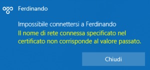

Windows returns imediatly the problem, desn’t even try to send something to the second Mikrotik, that means it recognizes an error with certificate. I’ve deleted it manually inside its local database and installed again, I’ve used the same method of installation that I used for the first Mikrotik and that sucessfully worked, here no success, why? The clock on router2 is ok.

Maybe in english error is: The certificate’s CN name does not match the passed value
Different IPs on different routers? Certificate name should match SSTP server IP or FQDN
I’ve solved it, it’s important to use names slightly different when compiling fields, for example Organization. I was thinking that this wasn’t important, as only URL matters, I was wrong. WIndows was using the other certificate, even if it had a different URL, that’s weird
