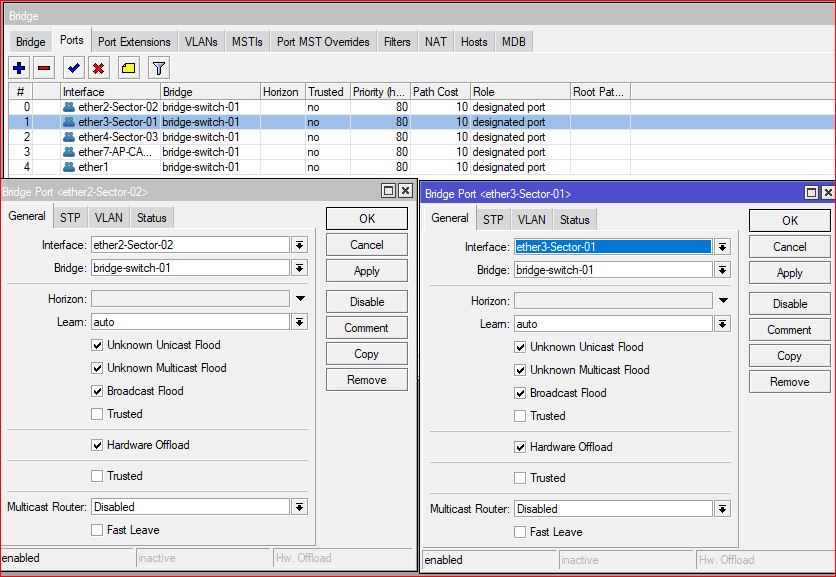

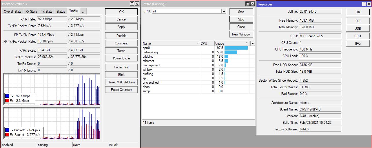

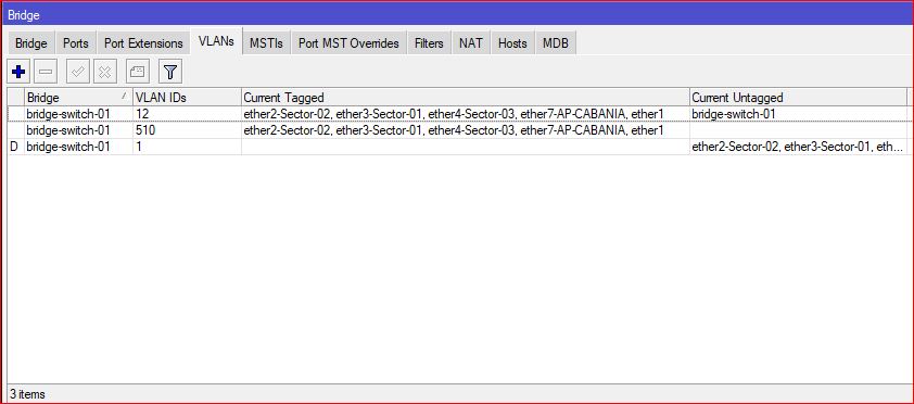

Dear, can you help me, or give me an idea since I cannot find information about why the switch does not pass more than 100Mbps, it is with a very basic configuration, 1 Bridge, all ethernet ports added to this.
2 Vlans were created all using Bridge, no Firewall rules, no routing, simple switch, but this does not reach more than 100Mbps.

Only the CRS3XX series provides hardware offload using bridge VLANs.
For your CRS1XX, please see here: https://wiki.mikrotik.com/wiki/Manual:CRS1xx/2xx_series_switches_examples
It looks like you are doing the VLAN filtering in software, hence putting all load on the CPU. Configuration must be done under /interface ethernet switch to take advantage of the switch properly.
