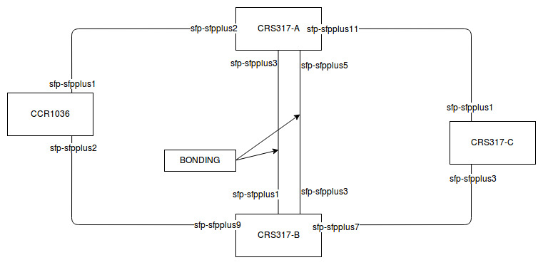

The network topology is attached to the post.

As no one seems to have an idea, run /interface bridge monitor bridge-core-a on all machines and watch whether the information is stable on all four and whether it is consistent (all machines have chosen the same root bridge, the root ports are the expected ones). Look for any bridge filter rules and interface ethernet switch rules which might interfere with stp operation.
Also run /tool profile on the slowly reacting CRS, it may show you which process group takes the most CPU. /log print follow-only may also yield something useful.
Other than that, just a small chance: 6.42.1 on the CCR whereas the rest is running 6.44 and no vlan-filtering there. Normally absence of vlan-filtering should not affect RSTP operation but things sometimes happen, and I hazily remember seeing some complaints about looped packets here on the forum when 6.42 was young.
All information appears as expected in /interface monitor bridge, as below. I believe the problem is related with RouterOS. After I upgraded the CCR to 6.44.3, the message started in equipment too :confused: , but the Changelog no refers to this problem, so I don’t know which version upgrade/downgrade. Any idea or suggestion?
