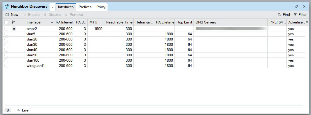

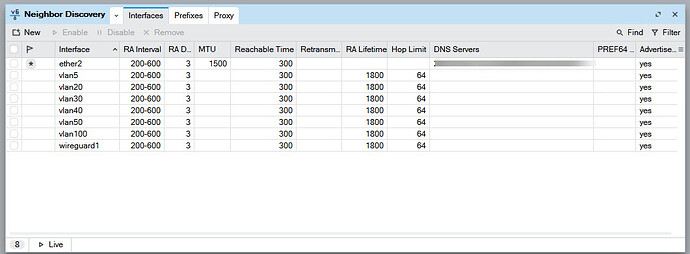

Thanks for your contribution but that is not the problem. I have always defined my ND as you can see in the following:
That just proves that you have ND enabled on your WAN interface, ether2.
/ip dhcp-client add interface=ether2 name=ether2 use-peer-dns=no
/ipv6 dhcp-client add add-default-route=yes comment="delegate ISP-assigned prefix" interface=ether2 pool-name=rogers-ipv6 pool-prefix-length=64 prefix-hint=::/56 request=address,prefix use-peer-dns=no
/ipv6 nd set [ find default=yes ] advertise-dns=yes interface=ether2 mtu=1500 ra-lifetime=none reachable-time=5m
Why are you even advertising DNS to your ISP? :face_with_spiral_eyes:

Did you test with the entry for ether2 removed?
First let me say that Znevna found my problem and now 7.23.1 works ... Thank you and I apologize for my poor behaviour ...

The problem code
Now corrected to /ipv6 nd set [ find default=yes ] interface=ether2 mtu=1500 ra-lifetime=none reachable-time=5m
