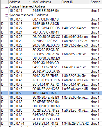

ROS version 6.44.5, model RB3011 I have network 10.0.0.0/16, I have 35 devices connected to network. For some reason DHCP server assigns randomly IP addresses, for example 10.0.50 than starts assigning 10.0.0.63, 10.0.0.64, 10.0.0.66, jumps to 10.0.0.101. Does it keeps some addressees which were used before and how to remove them?

As shown in figure. I cannot figure our why DHCP creates this holes in IP address space. Yesterday I have updated RuterOS from 6.44.1 to 6.44.6 , at least started adding IP address 10.0.0.0-10.0.0.254 range. I only have 3 statically defined addresses 10.0.0.2, 10.0.0.3, 10.0.0.4 those are switches and Default GW 10.0.0.1
Let’s say router leased .30 to some device, then .31, then .32
When .30 lease expired, it can be leased again, but router won’t try to fill that gap. It will continue to lease .33 etc. if .32 is still active.
That is what you are talking about?
