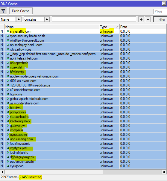

First of all, greetings, friends, i have a problem with a server DNS in a router Mikrotik, and I would like you to support me, the problem is, when i see in my DNS Cache register of
resolutions, and i have close a 20 000 resolutions of close 30 000 resolutions, and this use a lot of space, i hope that you help me with this issue, that i dont understand, thx a lot, God Bless you.
(Image Attachments)
Using Pi-hole and Chrome?
https://discourse.pi-hole.net/t/strange-entries-in-query-log/21814
In the setup of IP->DNS set the max TTL to a lower value like 01:00:00
This will clean these entries after 1 hour so they do not accumulate so much.
