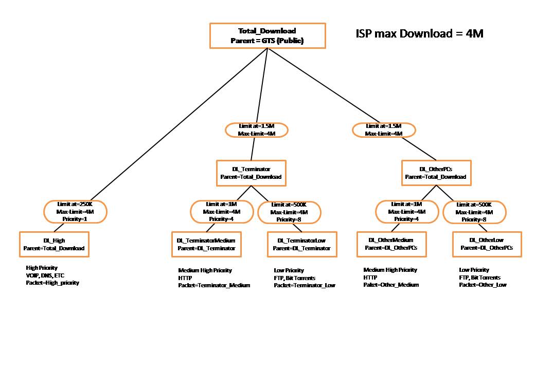

But, even in small network like mine, it is very easy to loose the overview and start making mistakes and I think it is a good investment making a diagram like attached to outline exactly what you want to achieve.
