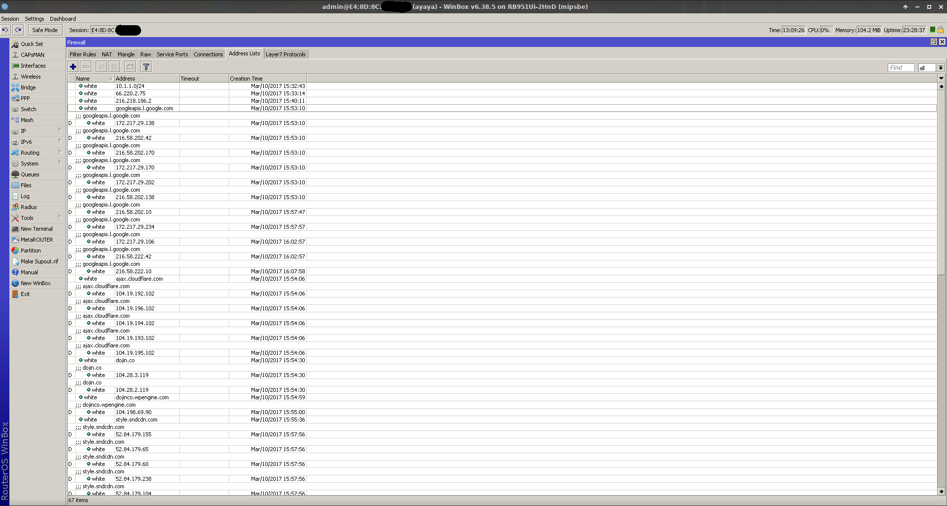

I tested the rules here and works fine. You need remember that websites contain external content like css, scripts, fonts and others from other IPs. Then you is dropping packets from these external IPs.
The DNS rule works with no problems when search a name in 8.8.8.8.
To work the dojin.co, i needed add many external address which dojin.co loads the content. You can see on attachment my address list.

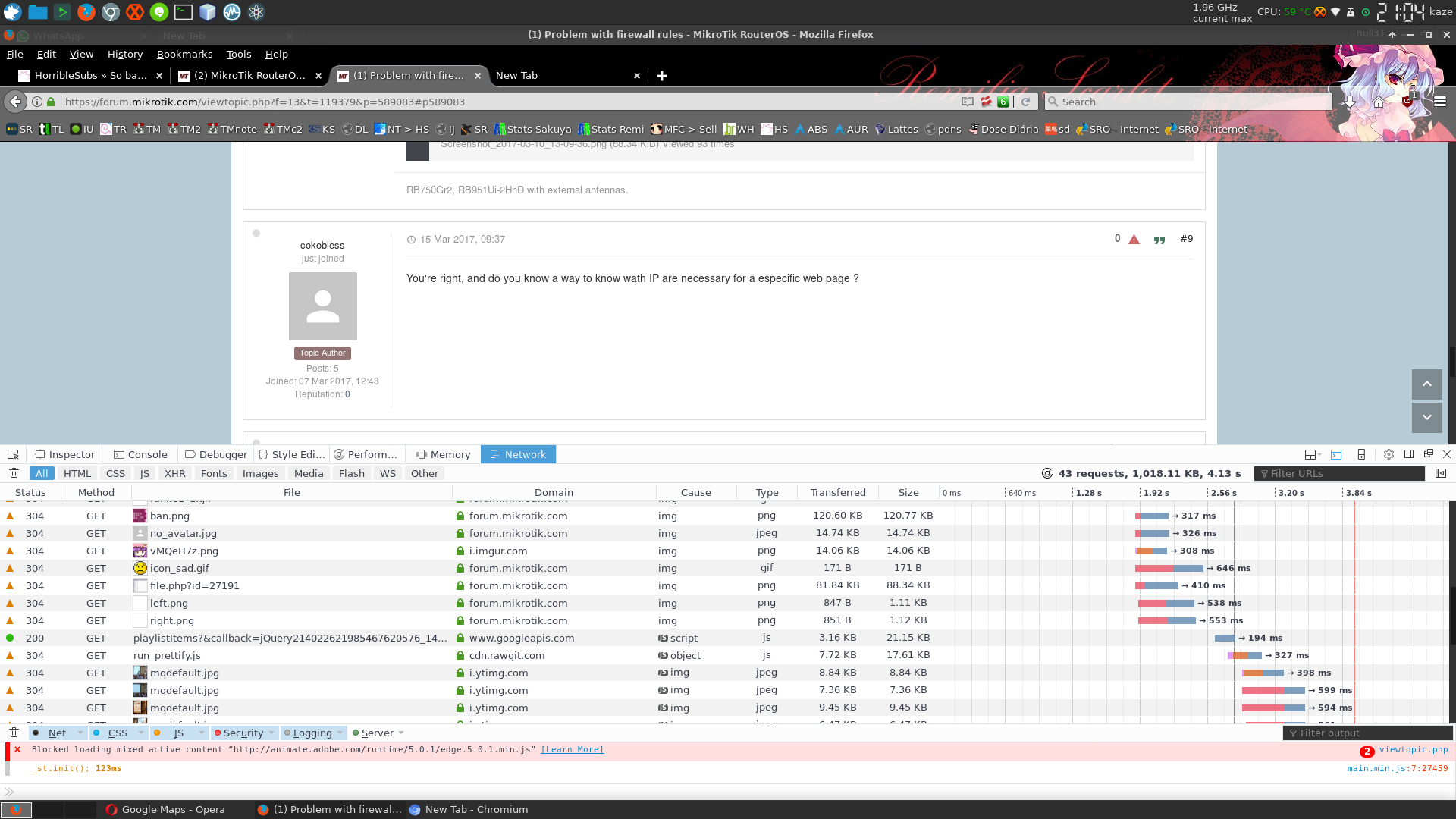

You can use Developer mode from browsers, the typical F12.
For the case of dojin.co, i used the Firefox; F12 > Network. After load the page and see what is loaded, i added the names (domains) to address-list.
An example is the below print:
You can see what was loaded when i opened this topic.
