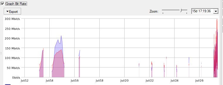

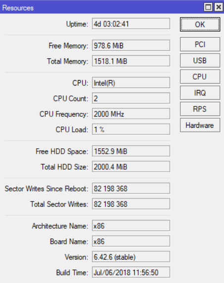

I have Dude 6.42.6 on RouterOS on eSXI server and the problem is that the Dude have very small pieces of link graph history. It is looks like this:

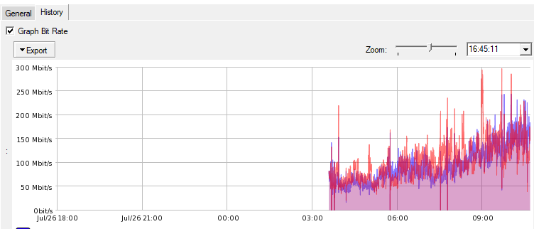

And, as you see some links show history only for 4 am, but now 11 am at my place (and it is router time).

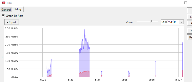

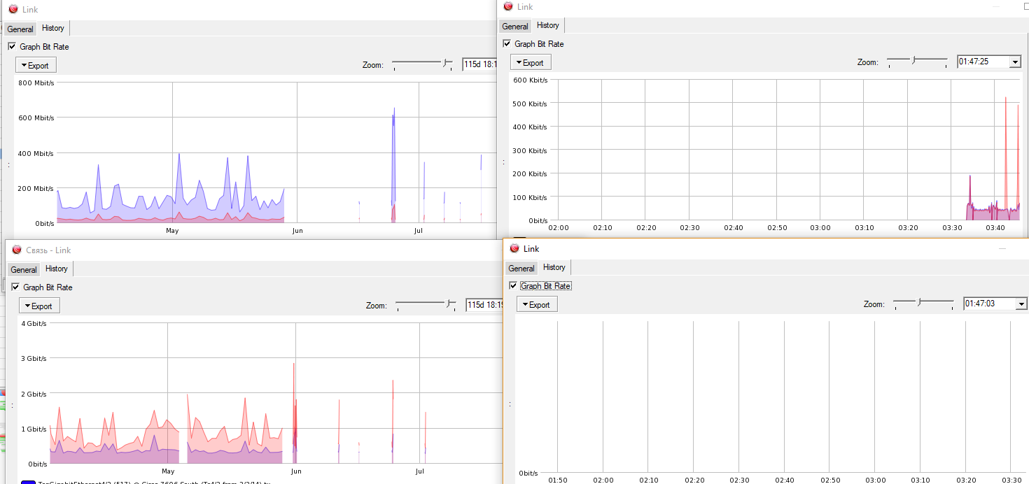

Other link examples:
All this links are always up and always have good traffic. Last one always have at least more than 50 Mbit/s
I remeber this problem for about an year for different versions (I have autoupgrade script).
My maps have a lot of devices (about 1700), there is a big operator network.
What can I do with it?
Thank you in advance!
Are the holes at the same place of all graphs? If not then you could have some kind of packet loss, maybe some antiflood filter takes place somewhere in the network?
I have similar experience and I can clearly map those holes it to time periods, when SNMP is not available (for example network problem, device turned off, SNMP service stopped etc..)
Same apply for the chart which ends on 4am - it means since then, there is no SNMP data available → no data for chart → chart does not update X axis with empty data (thats kind of error in TheDude graphing. I believe it should show empty data, but the graphing still needs a lot of development)
Can you make sure that you can do manual SNMP walk for devices which are missing chart at current time? Let us know your finding.

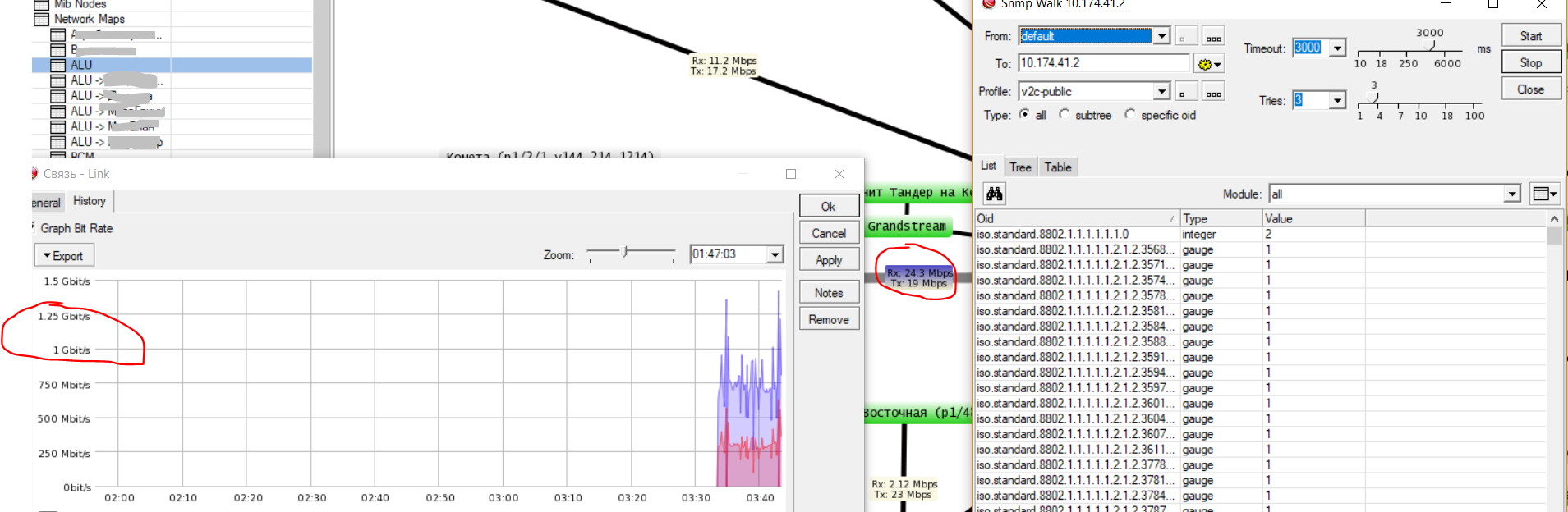

Manual is ok. Also the current link speed show something wrong and not updating.

We can see gaps on the graph, few hours each, but dude snmpwalk works good always at the same time. Nonsense. I’m pretty sure this is a software issue, Mikrotik must to fix it.
