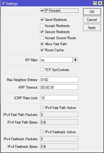

i can implement, in my firewall router (ccr1036-2s+) or in bgp router (ccr1072), rules I see in wiki mikrotik or is too aggressive?
all my netowkr go out via those routers

in attachement I give you ip settings of bgp router and firewall router.
thanks
So, CPU is the enemy here. Your devices have limited resources inspect traffic (IP firewall).
In most cases you should control a router in front (closer to the Internet) than your firewall. Your firewall needs a mechanism to tell your router about malicious traffic and drop it via a null or blackhole route.
By dropping traffic in routing ahead of the stateful inspection device you conserve CPU and it is able to stay responsive.
There isn’t a magic, preset, way to do what I described but the components can be as simple as logging ACLs on the firewall that seem to be DDoS traffic and have scripting that watches the logs and reacts. The reaction could be an API driven action that creates a blackhole route and schedules it’s cleanup after say 10 min.
