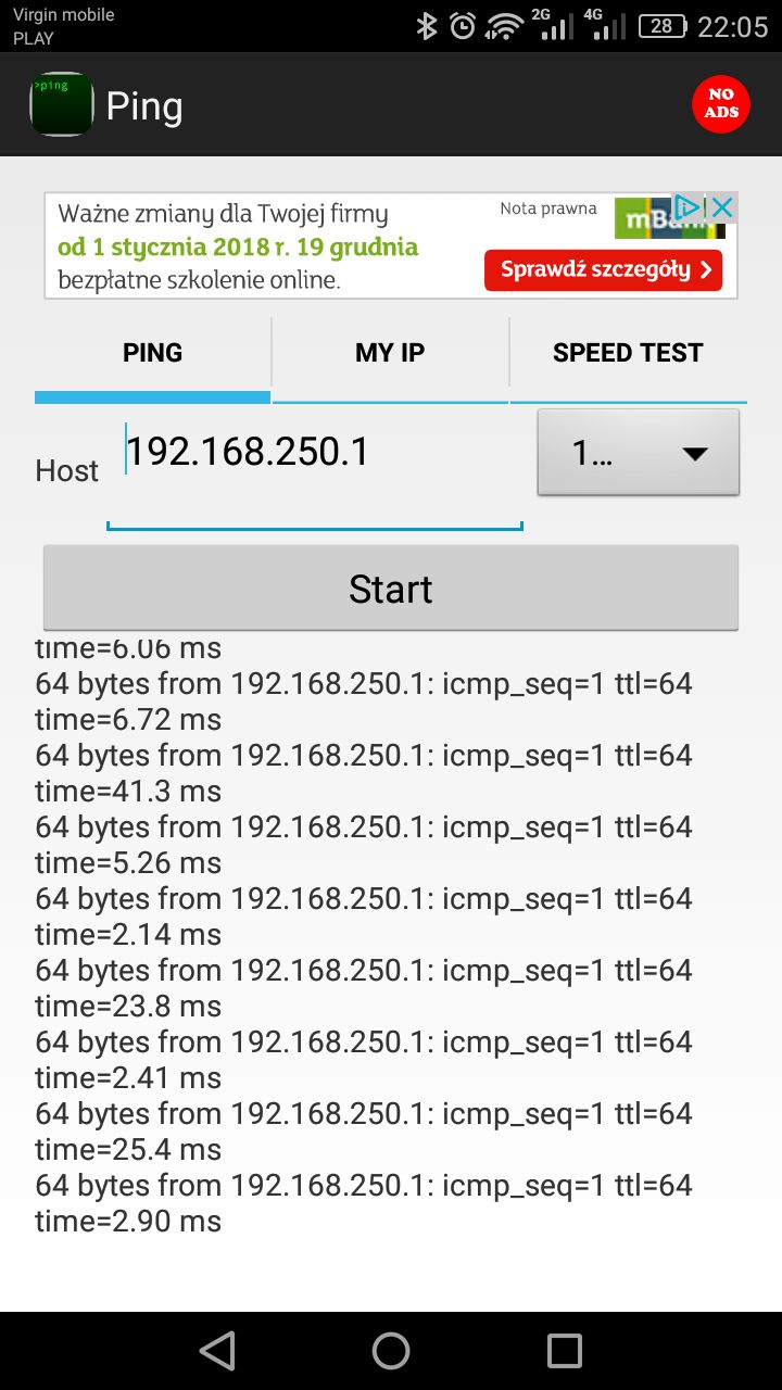

Recently I have bought an mikrotik RouterBOARD 962UiGS-5HacT2Hn . From the begining I have problem with it. I have configured it using Quick Set. It is disconnecting devices or simply work very, very slow or sometimes I can’t connect at all.

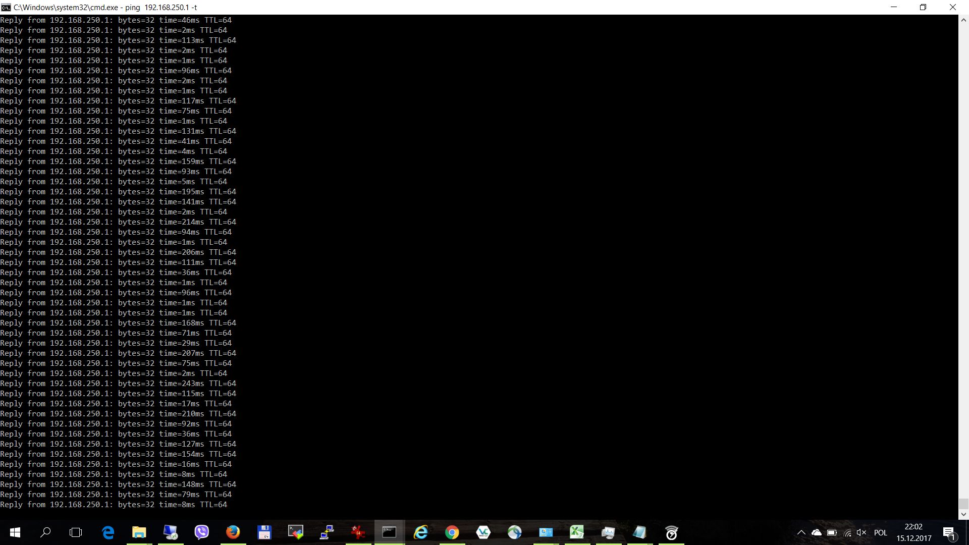

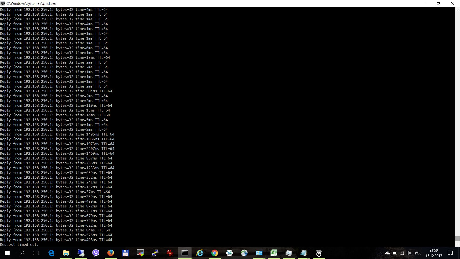

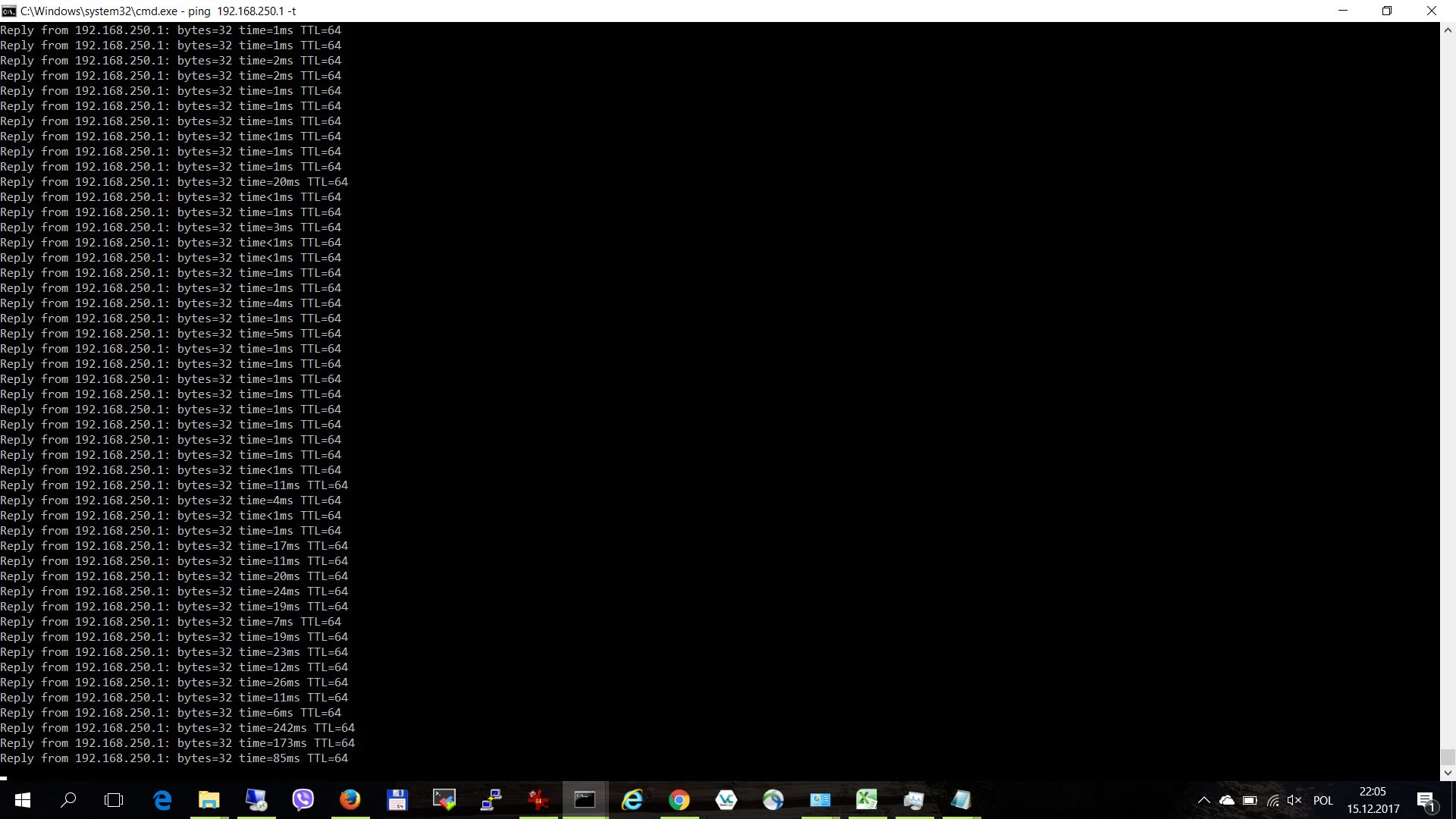

Right now I’m siting about 2,5 m from AP and I’m trining to troubleshoot what is wrong (see the attachment).
I have already upgraded to a newest version: RouterOS v6.40.5 (stable).
Can anyone help me with it ?

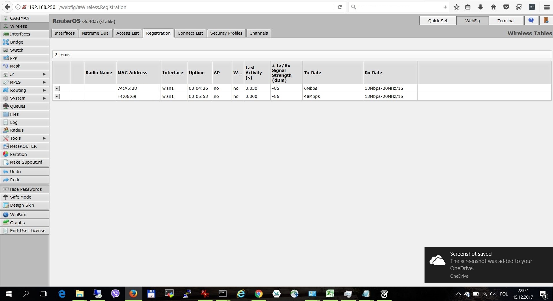

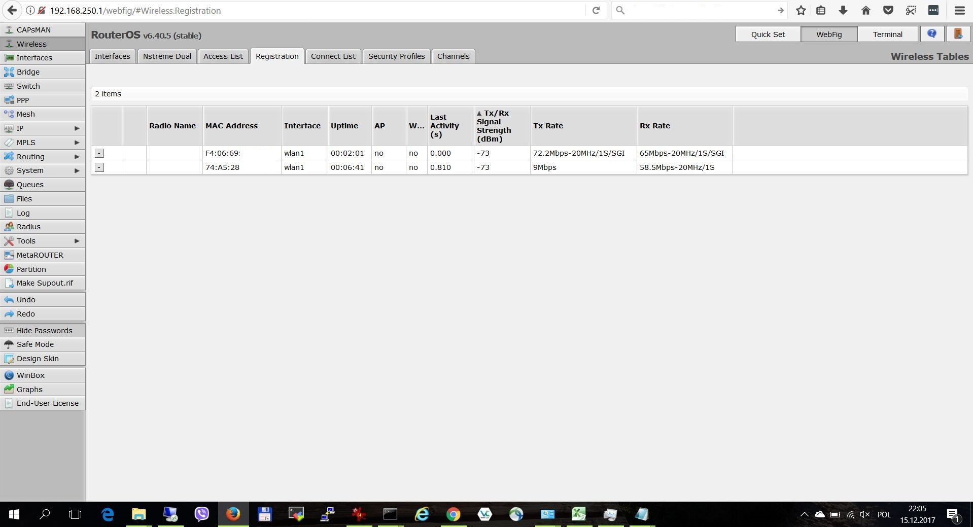

Normally the device should work perfectly with factory config. Try a reset, or quickSet “home dual” again. With factory config, you could provide Wireless Debug logs and Registration table print
Thanks for the answer. I have tried my own 3 configs :wink: After all of them I was reseting device to factory. Now is 4th - default one using Quick Set.
Today tests. On laptop is working decently fine (it depends where I sit :slight_smile: ) but on smartphones it is disaster :confused: wireless I was siting arround 10 - 11m from AP two walls (hollow brick), closer means 5-6m one wall (hollow brick).
I have a hope that shop, where I bought this router, will take it back and give me money back.
P.S. Where is the second post from this discussion ?

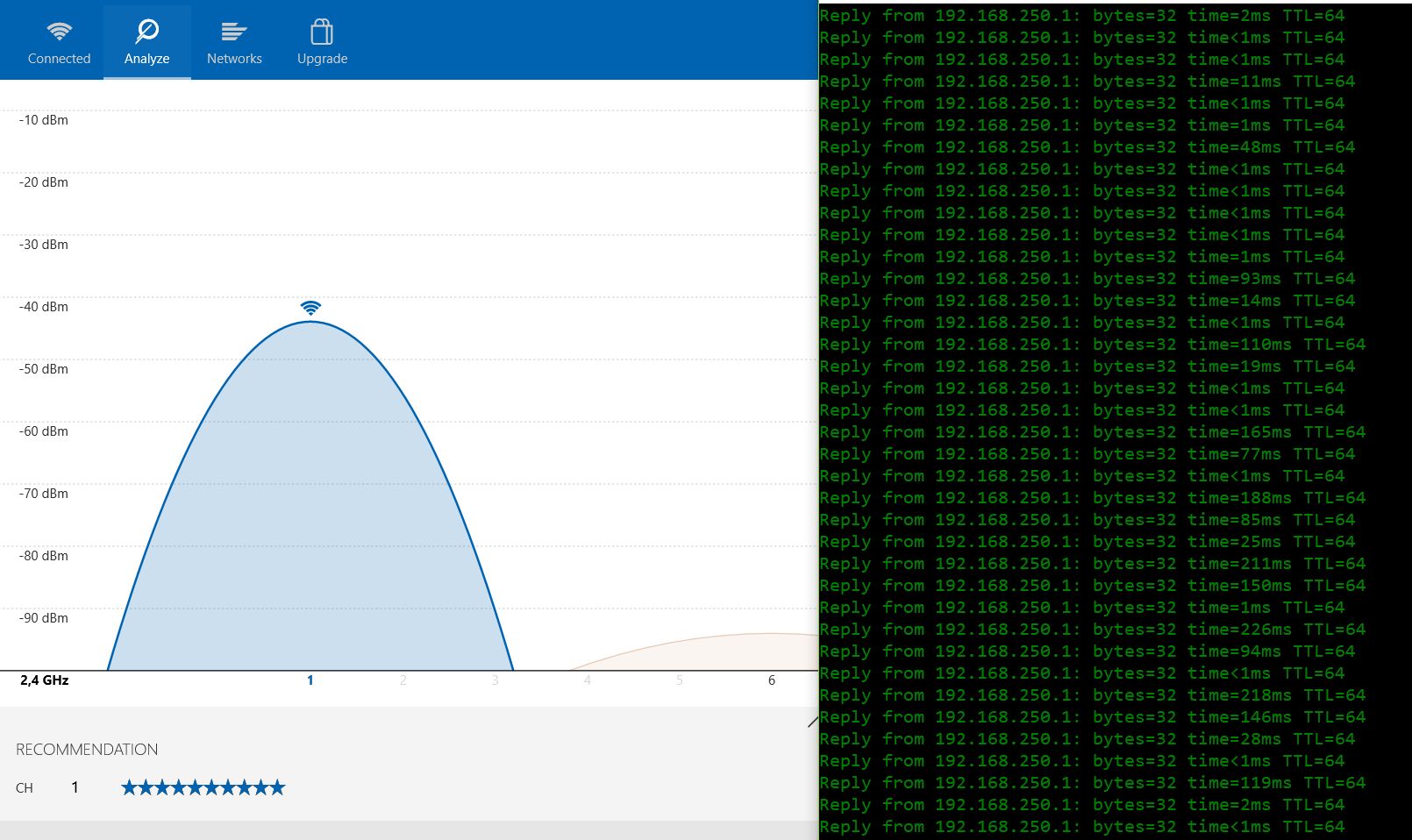

Try a channel other than 1 (6 or 11)
There may be rf interference that will not show
Wireless Snooper may give you more insight
-73 respective -85 dBm receive levels are quite low. This explains the issues you got there.
On old tplink -78 -80 and the connection was stable, but slow.
Now I can use wireless only in two rooms. For other rooms I should but one mikrotik per room ?:))
