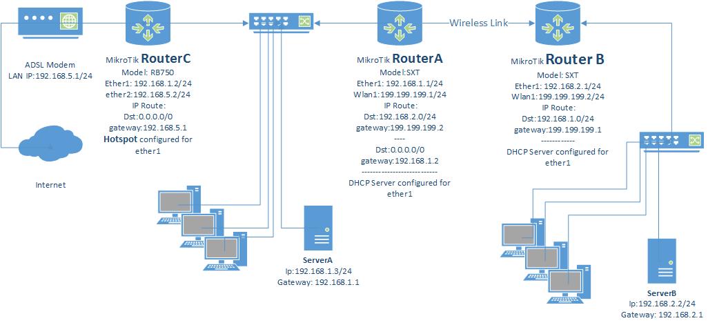

i have a network(2 subnet) same this:
when i enable hotspot on “RouterC” i cant ping 192.168.1.3 from “RouterB”.

i have some server on network 192.168.1.0/24. i want those server will be available on other subnets.

If you want to access them from outside the hotspot network, yes. But that was not your original problem. Look at your pic in your original post.
