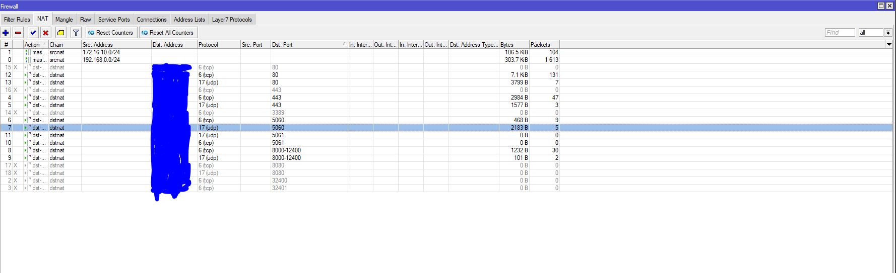

IP -FireWALL-SERVICES enabled SIP refer screenshot
Dst address in firewall is my public ip
My connection type is ipv4 address with public ip /28
IP PBX IS MATRIX ETERNITY NE

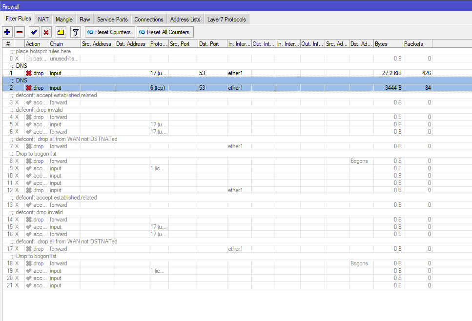

NOTHING IN FIREWALL FILTER RULES

To be honest I nothing springs out as blocking inbound registrations. In fact your firewall could be described as dangerously sparse. I wonder about all the static NATs though, whether these might be conflicting. I might be inclined to strip back all the NAT entries referring to your PBX except for the masquerade line.
