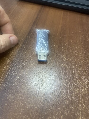

This method was also tested ))) 12 layers of aluminum foil
