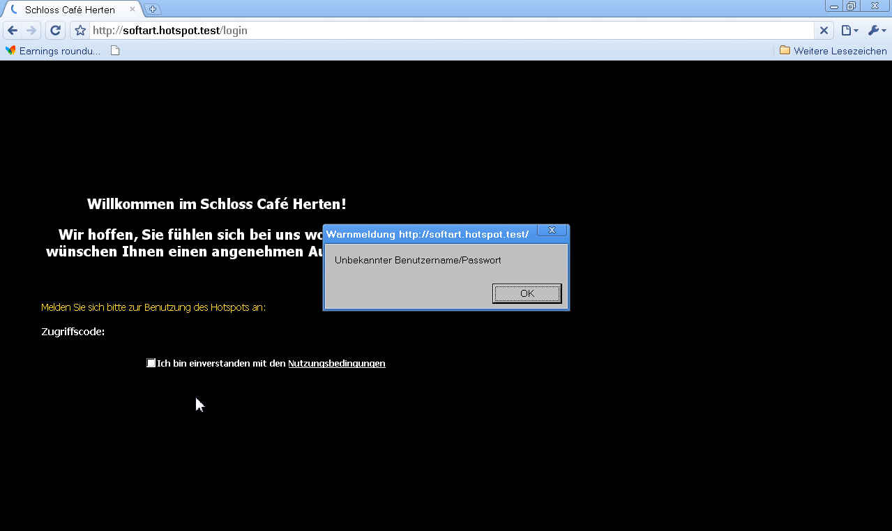

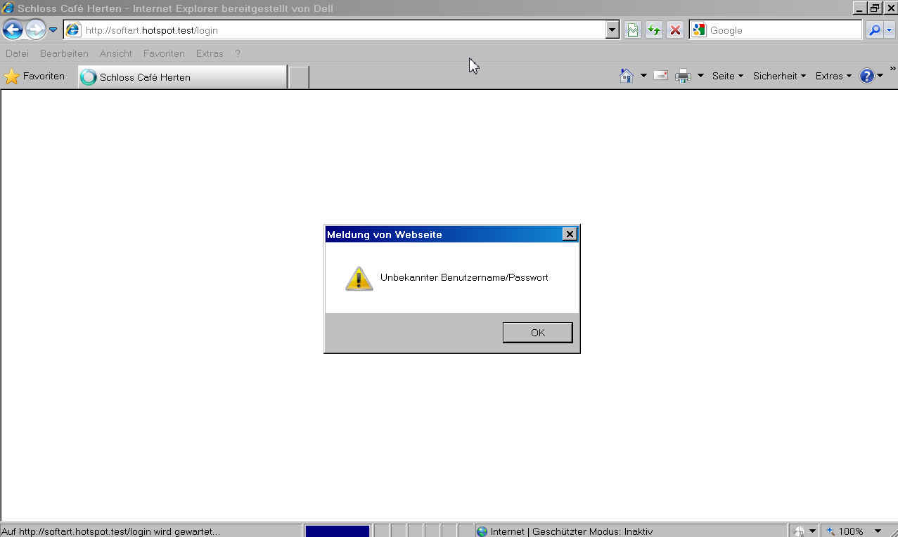

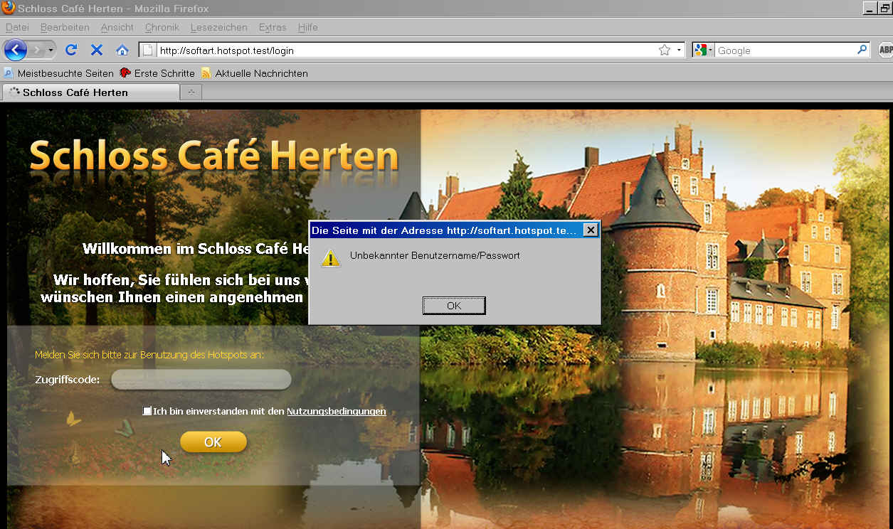

    I have quite different behaviour in chrome, firefox and IE8. Seems like, the alert somehow executes in a special “environment” regarding to the the CSS, depending upon browser. In FF I see most of real login.html, in IE8 nothing at all of it.

    One more observation: In case, I reposition the alert-window of IE8 2 times within the browser window, then the background will change from white to be identical to what I receive from FF immediately. So like some trigger or event is missing.

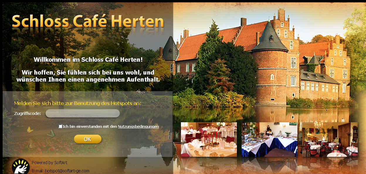

    First of all: Even the display in FF is not completely correct, in case of bad login. So my initial posting in this thread was not correct, I have to admit.
    Attached the correct, initial login-page. You see, even in FF a few elements are missing, when the alert shows up.
