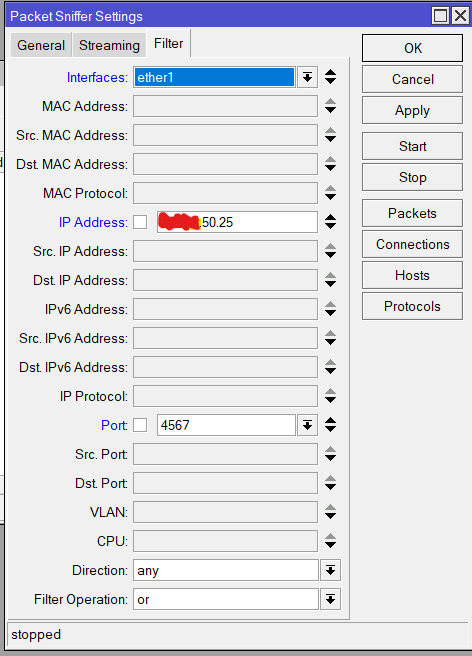

To make it clear whether the ISP has a problem with that unexpected MAC address or not, enable the macvlan interface (during a time when you can ignore the fact that it causes the internet connection to break), run /tool/sniffer/quick ip-address=x.x.50.25 port=4567 and try to open http://x.x.50.25:4567 in a browser on your mobile connected to LTE or 5G network; if the sniffer shows packets to come in, you can probably keep the macvlan in use, otherwise you’ll have to move the x.x.50.25/24 to ether1 and try again. But the ISP may still have an issue with outgoing packets with the macvlan MAC address as source, so the above is only a first step check; the next step would be to ping the x.x.50.25 from the phone (which requires an app).
I followed your instructions and enabled the MACVLAN interface, but after running the packet sniffer and trying to access http://x.x.50.25:4567 from my mobile device, I didn’t see any incoming traffic from MACVLAN interface.

If you do the same now with xx.xx.50.25 attached to ether1, can you see the TCP packets to port 4567 to come in?
I couldn’t see any TCP Packet.. Is this what you meant?

If you cannot see any TCP packets even now as the x.x.50.25 is attached to ether1, but the dst-nat rules are working the way you expect, either your ISP filters your incoming traffic or you sniff incorrectly, so maybe you were sniffing incorrectly before as well? Did you press [Start] in the window you have posted? Did you specify the port 4567 in the browser on the phone as I suggested?
Absolutely I did..
