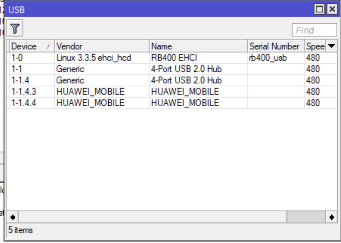

Both e3372 have the same VendorID 0x12d1 and DeviceID 0x1506 in System->Resources->USB
Can it be that Mikrotik recognizes this two devices as ONE and THE SAME Device? How can i fix it?
