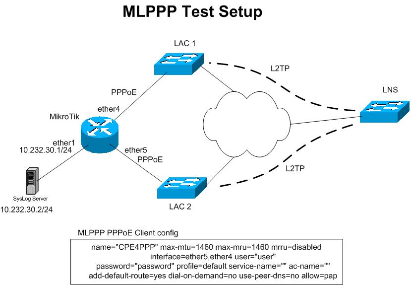

I have been attempting to establish a two channel MLPPP session by having a Mikrotik, with a PPPoE client interface associated with both ether4 and ether5, connect to two independent LAC’s that in turn tunnel using L2TP to a MLPPP enabled LNS. A diagram of the test setup is attached (Mikrotik MLPPP Test Setup.jpg). Apart from the PPPoE client, the only other interface configured is ether1 that connects to a SysLog server that was used to capture events.
