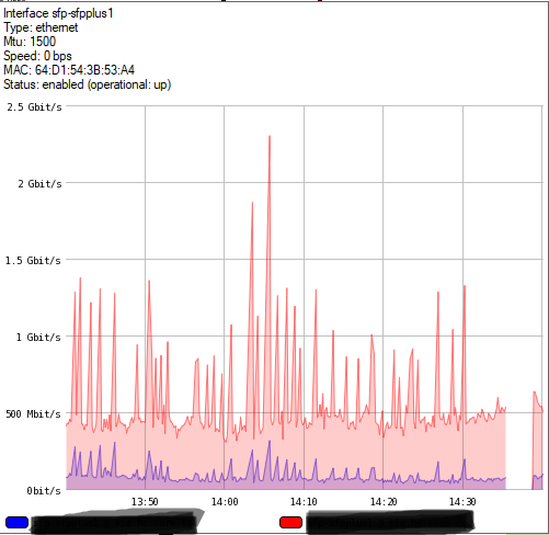

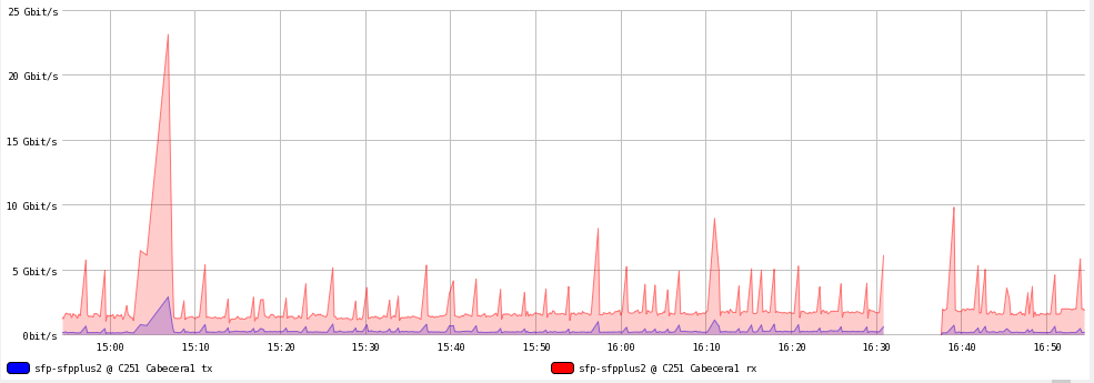

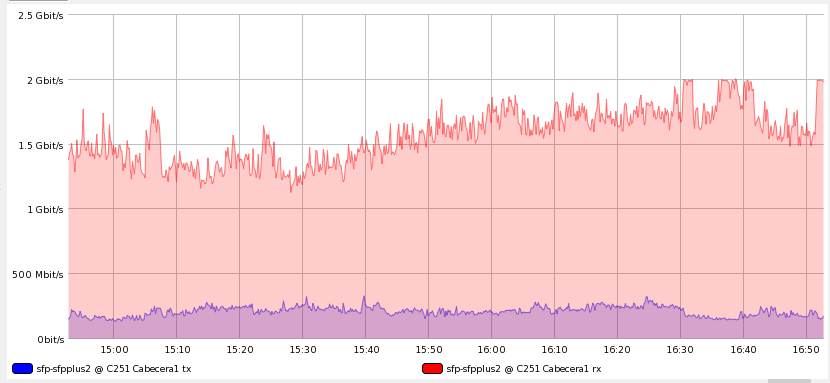

I have a small problem, since I installed version 6.46.4 of doubt, the graphics do not work properly, graphs with peaks and bad. I show an interface before and after in attached images.

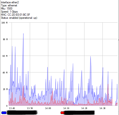

Same behavior with dude server v6.47.2 on RB1100AHx4 Dude Edition. Here are a few examples of my graphs. Has anyone else this experience and knows how to fix it?
if you select snmp instead of routeros for the graphs, they seem to be displayed correctly again
