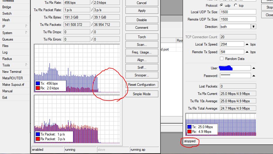

I have Mikrotik point to point link with good throughput . This connection is interrupted several times in a hour and This log can be seen : disconnected,too many poll timeouts .
This problem seen in configure with N band . I don’t have any problem when configure in A/G band .
By the way I need At least 100 Mbps throughput and i forced to use N band .
Please help me to resolve the problem .

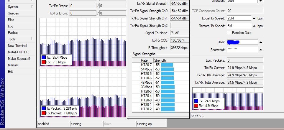

When use bandwidth test this link working properly .
