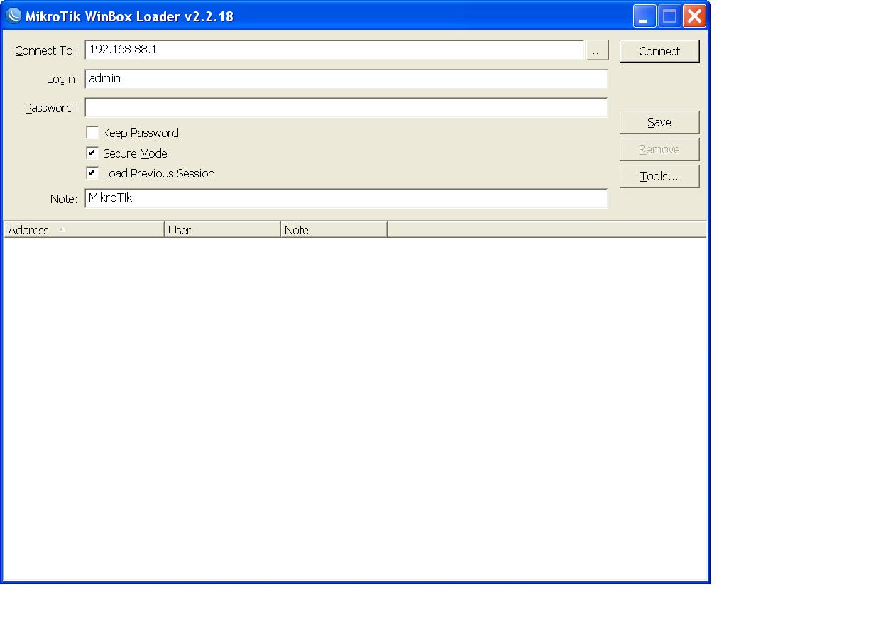

    Running Winbox appears the window Winbox Loader v2.2.18 I post. Clicking on “…” button, there is no MAC
    address. Clicking on “Connect” button, an error message appears:
    “RouterOS Winbox Error: could not fetch index from 192.168.88.1:80: disconnected”.
    I solved that problem giving my PC a manual IP address: 192.168.88.2, submask: 255.255.255.0,
    preferred gateway: 192.168.88.1 (the usual my RB IP address), DNS server: blank), but
    running Winbox appears the windows Winbox Loader v2.2.18 I posted, again without any MAC address,
    clicking on Connect, appears a window with the message “connecting to 192.168.88.1 (port 8291)”, then (port 0)
    and finally the error message:
