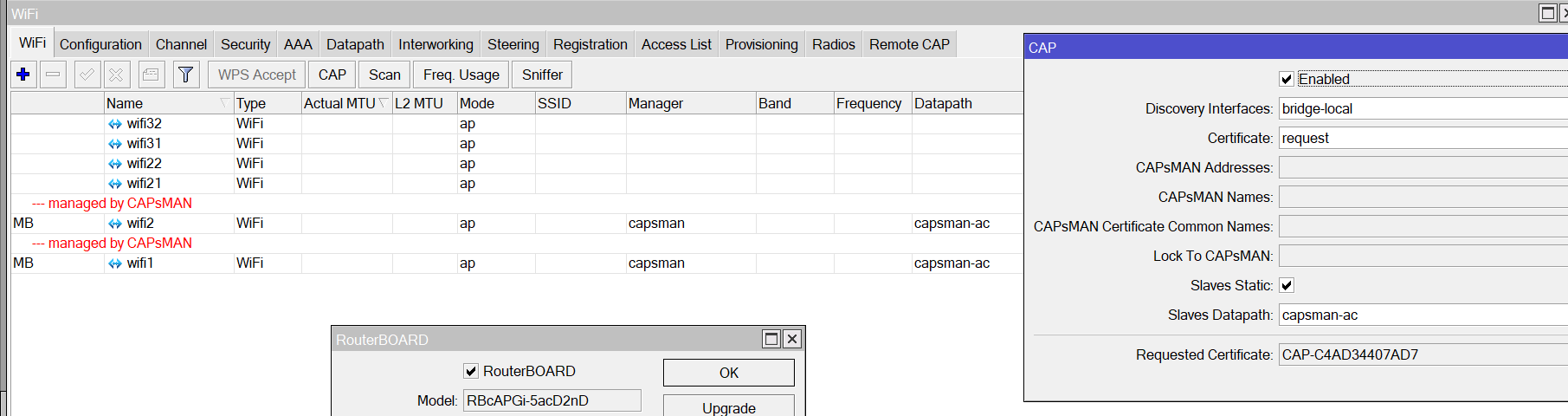

admin@RBcAPGi-5acD2nD > /interface/wifi/print detail
Flags: M - master; D - dynamic; B - bound; X - disabled, I - inactive, R - running
 0 M BI ;;; managed by CAPsMAN
        default-name="wifi1" name="wifi1" mac-address=C4:AD:34:40:7A:D9 arp-timeout=auto radio-mac=C4:AD:34:40:7A:D9 configuration.manager=capsman datapath=capsman-ac
 1 M BI ;;; managed by CAPsMAN
        default-name="wifi2" name="wifi2" mac-address=C4:AD:34:40:7A:DA arp-timeout=auto radio-mac=C4:AD:34:40:7A:DA configuration.manager=capsman datapath=capsman-ac
 2    I name="wifi21" mac-address=C6:AD:34:40:7A:D9 arp-timeout=auto master-interface=wifi1
 3    I name="wifi22" mac-address=C6:AD:34:40:7A:DA arp-timeout=auto master-interface=wifi2
 4    I name="wifi31" mac-address=C6:AD:34:40:7A:D9 arp-timeout=auto master-interface=wifi1 configuration.mode=ap
 5    I name="wifi32" mac-address=C6:AD:34:40:7A:DA arp-timeout=auto master-interface=wifi2 configuration.mode=ap

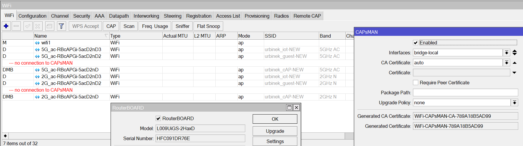

While on CAPsMAN side, interfaces are created with aligned but trow error “no connection to CAPsMAN” (wtf?)
admin@urbinek_L009UiGS-2HaxD-IN > /interface/wifi/print detail
 0 MDBI ;;; no connection to CAPsMAN
        name="2G_ac-RBcAPGi-5acD2nD" mac-address=C4:AD:34:40:7A:D9 arp-timeout=auto radio-mac=C4:AD:34:40:7A:D9 configuration=home_2-ac
 1  D I name="2G_ac-RBcAPGi-5acD2nD2" mac-address=C6:AD:34:40:7A:D9 arp-timeout=auto master-interface=2G_ac-RBcAPGi-5acD2nD configuration=guest_2-ac
 2  D I name="2G_ac-RBcAPGi-5acD2nD3" mac-address=C6:AD:34:40:7A:DA arp-timeout=auto master-interface=2G_ac-RBcAPGi-5acD2nD configuration=iot_2-ac
 3 MDBI ;;; no connection to CAPsMAN
        name="5G_ac-RBcAPGi-5acD2nD" mac-address=C4:AD:34:40:7A:DA arp-timeout=auto radio-mac=C4:AD:34:40:7A:DA configuration=home_5-ac
 4  D I name="5G_ac-RBcAPGi-5acD2nD2" mac-address=C6:AD:34:40:7A:DB arp-timeout=auto master-interface=5G_ac-RBcAPGi-5acD2nD configuration=guest_5-ac
 5  D I name="5G_ac-RBcAPGi-5acD2nD3" mac-address=C6:AD:34:40:7A:DC arp-timeout=auto master-interface=5G_ac-RBcAPGi-5acD2nD configuration=iot_5-ac

New capsman on L009UiGS-2HaxD:
/interface wifi security
add authentication-types=wpa2-psk disabled=no name=guest
add authentication-types=wpa2-psk disabled=no name=iot
add authentication-types=wpa2-psk disabled=no name=home
/interface wifi channel
add band=2ghz-n disabled=no name=2-AC skip-dfs-channels=disabled
add band=5ghz-ac disabled=no name=5-AC skip-dfs-channels=disabled
add band=5ghz-ax disabled=no name=5-AX skip-dfs-channels=disabled
add band=2ghz-ax disabled=no name=2-AX skip-dfs-channels=disabled
/interface wifi datapath
add bridge=bridge-local disabled=no name=guest vlan-id=48
add bridge=bridge-local disabled=no name=home vlan-id=64
add bridge=bridge-local disabled=no name=iot vlan-id=32
add bridge=bridge-local disabled=no name=capsman-ac
/interface wifi configuration
add channel=2-AC country=Poland datapath=capsman-ac disabled=no manager=capsman name=home_2-ac security=home ssid=urbinek_cAP-NEW
add channel=2-AC country=Poland datapath=capsman-ac disabled=no name=guest_2-ac security=guest ssid=urbinek_guest-NEW
add channel=2-AC country=Poland datapath=capsman-ac disabled=no name=iot_2-ac security=iot ssid=urbinek_iot-NEW
add channel=2-AX country=Poland datapath=home disabled=no name=home_2-ax security=home ssid=urbinek_cAP-NEW
add channel=2-AX country=Poland datapath=guest disabled=no name=guest_2-ax security=guest ssid=urbinek_guest-NEW
add channel=2-AX country=Poland datapath=iot disabled=no name=iot_2-ax security=iot ssid=urbinek_iot-NEW
add channel=5-AC country=Poland datapath=capsman-ac disabled=no manager=capsman name=home_5-ac security=home ssid=urbinek_cAP-NEW
add channel=5-AC country=Poland datapath=capsman-ac disabled=no name=guest_5-ac security=guest ssid=urbinek_guest-NEW
add channel=5-AC country=Poland datapath=capsman-ac disabled=no name=iot_5-ac security=iot ssid=urbinek_iot-NEW
add channel=5-AX country=Poland datapath=guest disabled=no name=guest_5-ax security=guest ssid=urbinek_guest-NEW
add channel=5-AX country=Poland datapath=iot disabled=no name=iot_5-ax security=iot ssid=urbinek_iot-NEW
add channel=5-AX country=Poland datapath=home disabled=no name=home_5-ax security=home ssid=urbinek_cAP-NEW
/interface wifi provisioning
add action=create-dynamic-enabled disabled=no master-configuration=home_2-ac name-format=2G_ac-%I slave-configurations=guest_2-ac,iot_2-ac supported-bands=2ghz-n
add action=create-dynamic-enabled disabled=no master-configuration=home_5-ac name-format=5G_ac-%I slave-configurations=guest_5-ac,iot_5-ac supported-bands=5ghz-ac
add action=create-dynamic-enabled disabled=no master-configuration=home_5-ax name-format=5G_ax-%I slave-configurations=guest_5-ax,iot_5-ax supported-bands=5ghz-ax
add action=create-dynamic-enabled disabled=no master-configuration=home_2-ax name-format=2G_ax-%I slave-configurations=guest_2-ax,iot_2-ax supported-bands=2ghz-ax
/interface wifi capsman
set ca-certificate=auto enabled=yes interfaces=bridge-local package-path="" require-peer-certificate=no upgrade-policy=none

/interface wifi cap
set certificate=request discovery-interfaces=bridge-local enabled=yes slaves-datapath=capsman-ac slaves-static=yes
Okay, so it seems that adding manager in was unessesary
add channel=2-AC country=Poland datapath=capsman-ac disabled=no > manager=capsman > name=home_2-ac security=home ssid=urbinek_cAP-NEW
add channel=5-AC country=Poland datapath=capsman-ac disabled=no > manager=capsman > name=home_5-ac security=home ssid=urbinek_cAP-NEW

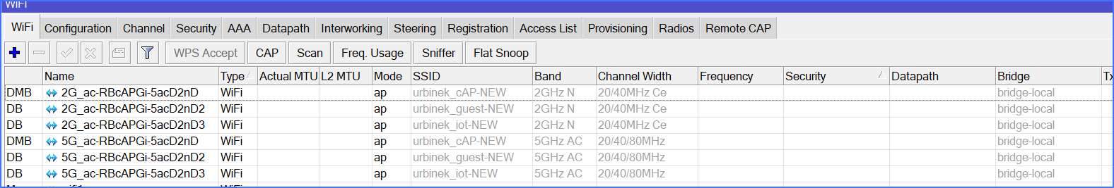

When removed, caps is downloading configuration and broadcasting networks
It i think there is still problem with vlan/bridging. I cant add interfaces as they are dybnamic
Missing ingredient was, actually tagging bridge on cAP and enabling filtering, lol
/interface/bridge set [find where name=bridge-local] vlan-filtering=yes
/interface/bridge/vlan add bridge=bridge-local tagged=bridge-local vlan-ids=64
/interface/bridge/vlan add bridge=bridge-local tagged=bridge-local vlan-ids=16
/interface/bridge/vlan add bridge=bridge-local tagged=bridge-local vlan-ids=32
/interface/bridge/vlan add bridge=bridge-local tagged=bridge-local vlan-ids=48
