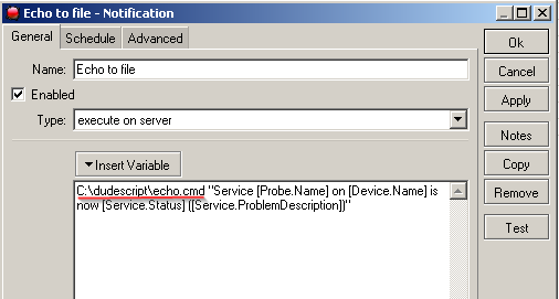

  1. Do not put c:\windows\test.bat in quotes (“”)

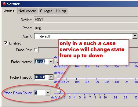

  2. The service does not change it state directly from up to down (this will not be true if you change probe down count to 1).

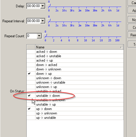

    First it change state from up to unstable, so you will not receive notification. The settings should be
another solution is to check more rules. I use {acked,unknown,unstable,up}->down and {unknown,down}->up
with this you will always know of device, which is down and when it comes from down to up (it happens directly) and from unknown to up (it happens when you are using dependencies for example)
If you want to debug your network, you can check up->unstable and unstable->up. This will notify you, when some device in your network drops some pings, but still answers some of them.
