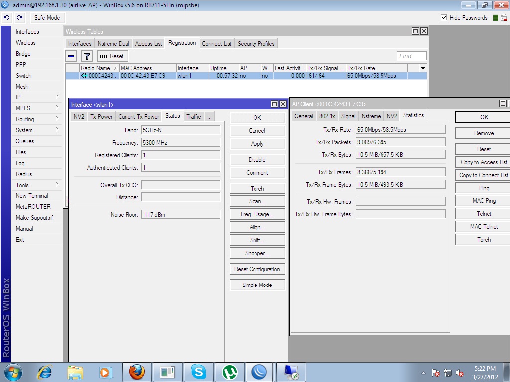

and we have tried this pc-to router711 - 711router-pc bandwidth test and it goes to 15mbps both side tx/rx
but client are not getting the atleast browsing speed
can any one tell me in this regard

I don’t see anything wrong with your setup that would cause really bad issues. Make sure to use NV2 security. Use rate-selection=advanced.
What are your ccq readings? what are the signal strengths?
thanks for your input dear :slight_smile:
ya i have configured wpa2psk security on nv2 tab of wireless card.
and overall ccq on ap side is 101%
i am posting an image
and i want to know what rate selected on advanced tab because i can’t play with configuration (production network ) due to some reason
can you tell me the data reated will be there ???

one more thing >>>
<1>when i check bandwidth test
cpu load goes up to 100%
tcp 10Mbps load
<2> how to enable security one both side
<3> data rates are advanced both side 36, 48, 54 <supported rate A/G > and < basic rate A/G>
<4> sometimes packet loss is 8% and some times 20%
thanks :slight_smile:

1> bandwidth test with TCP is CPU intensive. Use a separate device to generate traffic.
2>
Create identical wireless security profiles on both sides
Use same NV2 key in NV2 setup on both sides
NV2 does not use wireless security profile!
3>
Date rate selection Advanced allows both radios to select faster negotiations on both sides by skipping some steps in normal rate negotiation which are not important.
It does not change the rates actually used. It’s faster negotiations only. Rate Default or Configured changes rates that can be used.
AP wireless protocol should be NV2.
Station wireless protocol should be ANY.
Verify wireless security profiles are identical, and selected for use on both sides.
NV2 pre-shared key must be the same for NV2 to connect.
I have had problems with using “Any” protocol selection much better to use “NV2 nstreme 802.11”
hey thanks friend
i did all these things and every thing works fine but
when i select ht guard interval to long then link goes disappear.
and tx/rx ccq is 100/99% and overall ccq is freez at 59%
i don’t think this is ok :confused:

Looks alright at first glance.
Could you tell more about the actual symptoms you are seeing? How exactly are you performing a test to identify the issue?
You say latency is too high. How high? And how are you testing?
i have maintainoed that in earlier post.
continously i was checking the perfomance of nv2.first day every thing was good but after 5 to 6 hours ping reply from ap was breaking even client was connected to the ap . at client wirless interdace (connected to ess). breakage is 4 to 5 times …
client tx strength become -70 to -80 (i have also changed the free frequency ) but same result.
one of our mikrotik supplier told me to configure in this way ,so i changed the configuration like this
