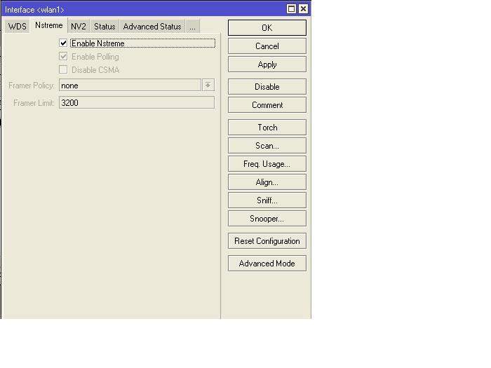

I have similar setup, but where do someone set the nstreme in the wireless. What does it do and what is the impact of it on link.
sorry cant understand what is the fresnel
nstreme first. This will clean up some timing issues

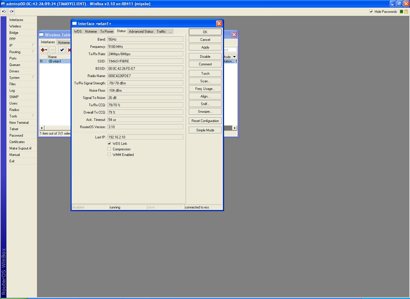

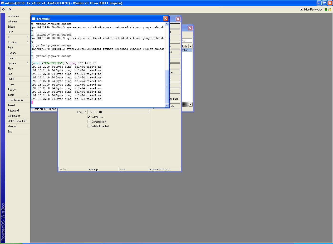

Hello all,
please, i want to ask question based on this two radio, is this link good to transfer or transmit about 4mbps of bandwidth.
See the connections below;
If not good, what will i do to achieve a better signal strength to improve the link. This is the point to point connection using mikrotik rb411.Again, i want to know the effect of nstreme in point to point wireless link connection. What is the best way to enable nstreme in mikrotik.

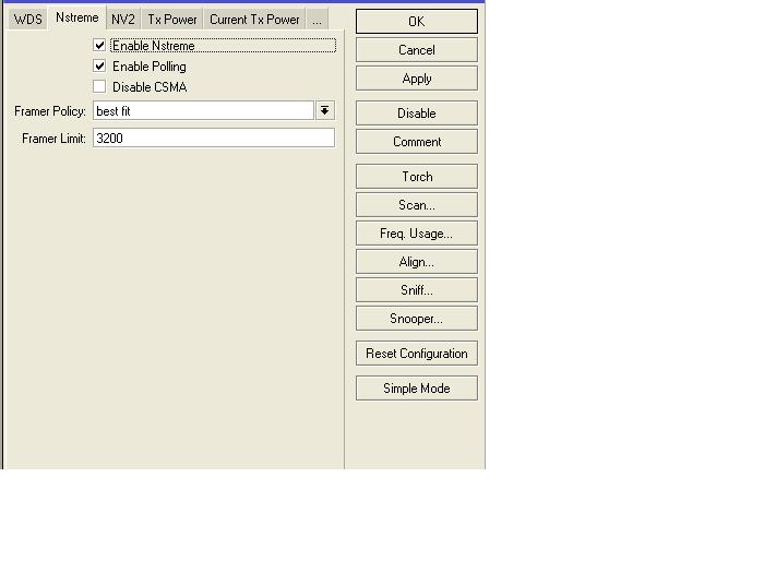

I need a detailed way to configure nstreme dual slave using an rb411 with 1 wlan and ether interface between router a and router b
See This
Nstreme dual Step-by-Step
http://wiki.mikrotik.com/wiki/Nstreme_dual_Step-by-Step
Thanks,
The link you sent to me is for configuration with 2 wlan interface, but what i have is just ether1 and wlan1.
How do i go about it.

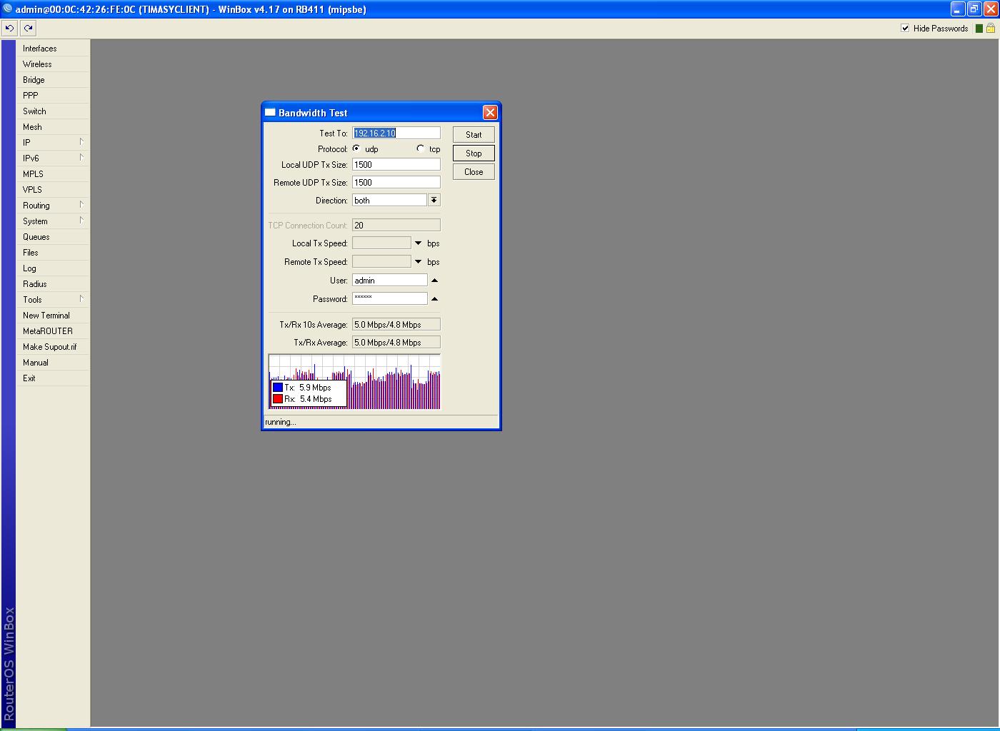

again just look at this link and give me your suggestions and advice. I establishe3d this link, on point - point connection. When i do bandwdith test, see the reply/response time for the two links.
Find the pictures below
Is this a good link or i shd make some adjustments to the links
