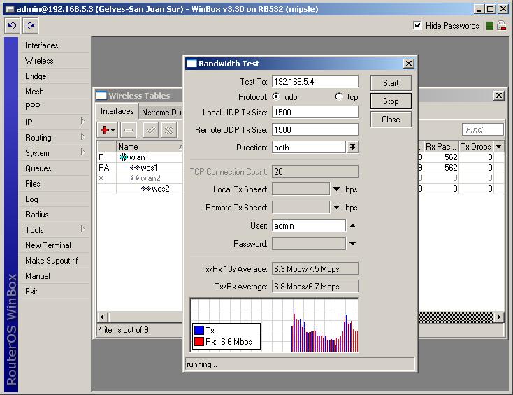

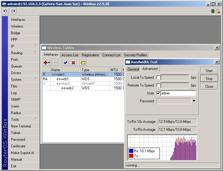

i’ve a similar problem, when I’ve changed my versión 2.9.38 → 3.30, I’ve poor performance in bandwidth test, I had 15/15 Tx/Rx Average 10s, now I’ve 7/7 Tx/Rx Average 10s.
Please help us, thank you.
