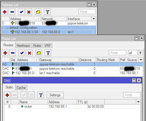

Hi greencomputing,
I have tried what you suggested and it still doesnt work. I am attaching a picture of information that might be useful to you. Also to add, I am able to successfully ping google’s IP using Tools → Ping, so the PPPoE connection is working.

Masquerade? I dunno if MT have configured NAT out of the box.
Show IP->Firewall->NAT config.
As well as IP->DHCP Client.
Hi Rivera, thanks for the response. I have added masquerade for PPPoE, and it stated working. I had masquerade for WAN interface, but it seems that with PPPoE I need to have it for PPPoE. I have also removed default masquerade for WAN interface, and it is still working.
