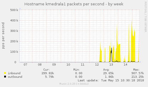

As I wrote, setting MTU lower that 1480 helps, but another strange things happens. Packets count on interface pppoe grows to very high values. I collect data from:
/interface print stats-detail
And output looks like:
410 DR  name="<pppoe-kmedrala1>" last-link-up-time=may/14/2018 16:50:24
       link-downs=0 rx-byte=196 979 539 tx-byte=10 237 853 430
       rx-packet=3 706 128 tx-packet=7 065 682 rx-drop=0 tx-drop=0
       tx-queue-drop=0 rx-error=0 tx-error=0 fp-rx-byte=0 fp-tx-byte=0
       fp-rx-packet=0 fp-tx-packet=0
Pps graphs look like this:
Routerboard was upgraded on 12 may. Traffic on interface pppoe-kmedrala1 it’s very low.
Mikrotik team, can you look at this post?
Mikrotik team? It’s look like some bug.
