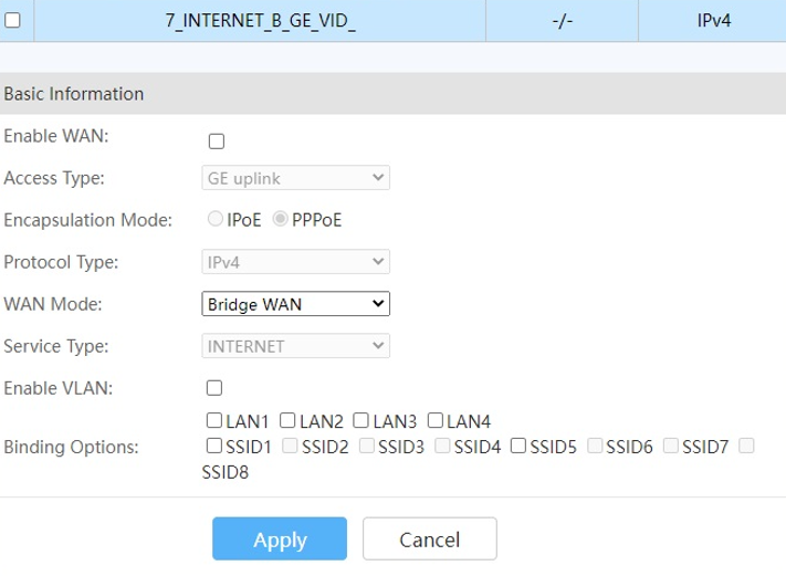

On the huawei, you likely need to tick at least of the LAN1-LAN4 interfaces, the one to which the Mikrotik ether1 is attached. (And probably Enable WAN needs to be checked)
No
  • Above is a picture of the settings recommended by the ISP (for BRIDGE) - without using VLANs.

You still should at least check the checkbox next to the LANX interface that you use to connect to the hAP ax² under Binding Options.
