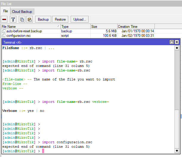

Hello I am trying to import the configuration in the CCR1009, however I get an error
You said it loaded fine LOL
In other words why are using a backup from one machine into a different hardware machine??

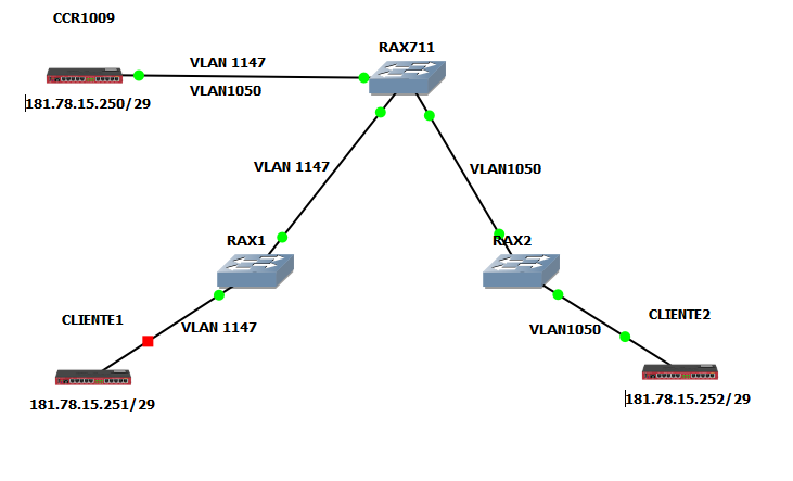

In the image I show the network topology, client 2 through VLAN 1050 has access to the internet without problems. client 1 through VLAN 1147 has a connection at layer 2 level, the computers have mac learning, however the IP traffic through IP 181.78.15.251/29 does not give internet access nor does it respond to ping between the two mikrotiks
