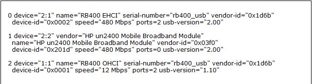

I have Qualcomm UNDP1 ( other names are HP UN2400 or Gobi1000 ) on my RB411U board.
I can see card on Resources at winbox but the card does not appears at Terminal screen;

Hi;
I created a supout.rif file and sent to support.
thanks.
[admin@RB411U] > system resource usb p
 # DEVICE VENDOR                   NAME                  SPEED
 0 2:1                             RB400 EHCI            480 Mbps
 1 2:2    HP un2400 Mobile Broa... HP un2400 Mobile B... 480 Mbps
 2 1:1                             RB400 OHCI            12 Mbps
[admin@RB411U] > port print
Flags: I - inactive
 #   NAME                                CHANNELS   USED-BY                                BAUD-RATE
 0   serial0                             1          Serial Console                         auto
[admin@RB411U] >
