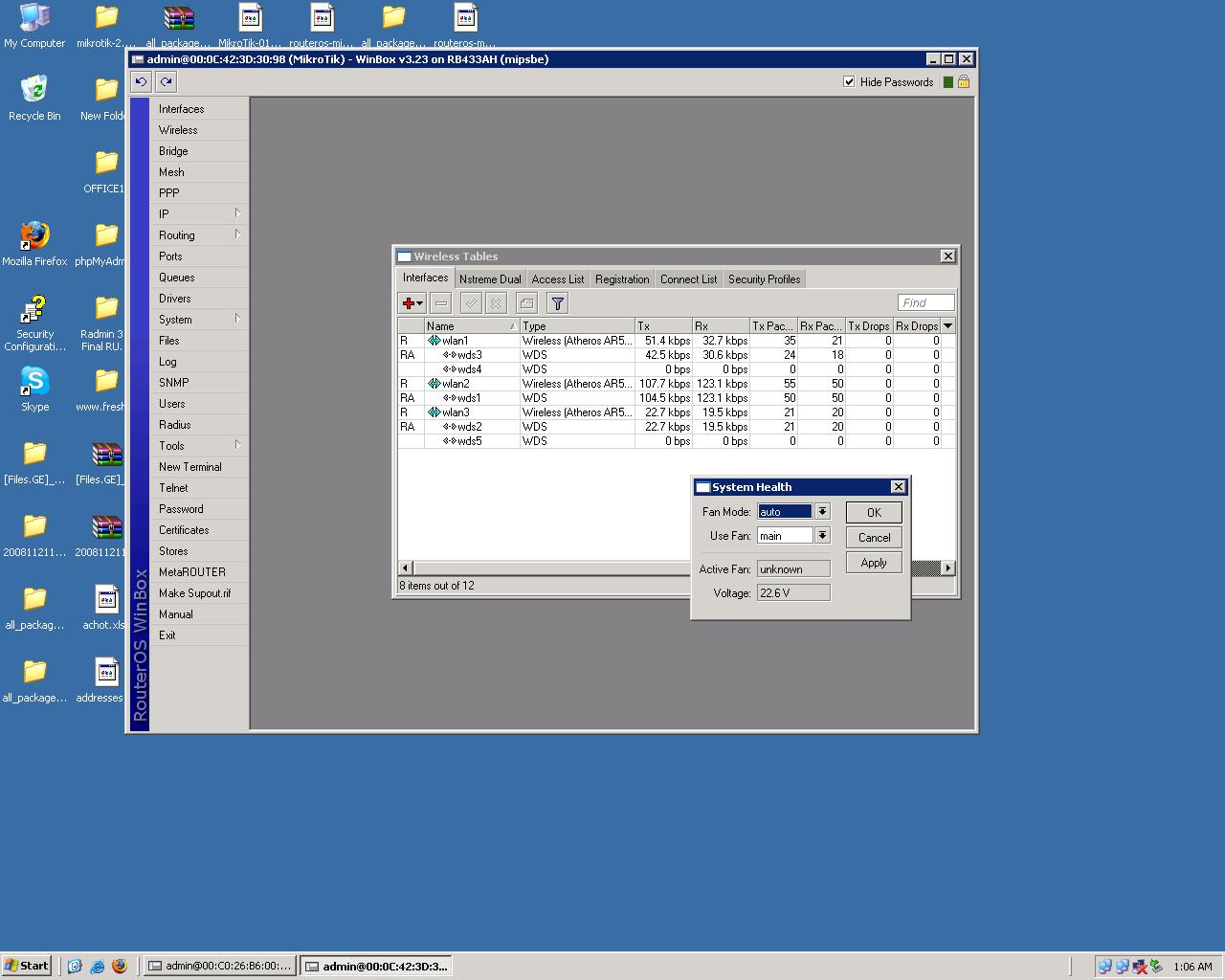

Here is Prin screen

and if i have a llok at the print screen you uploaded it ses you have v 3.23
Yes I have updated now I have v3.24
