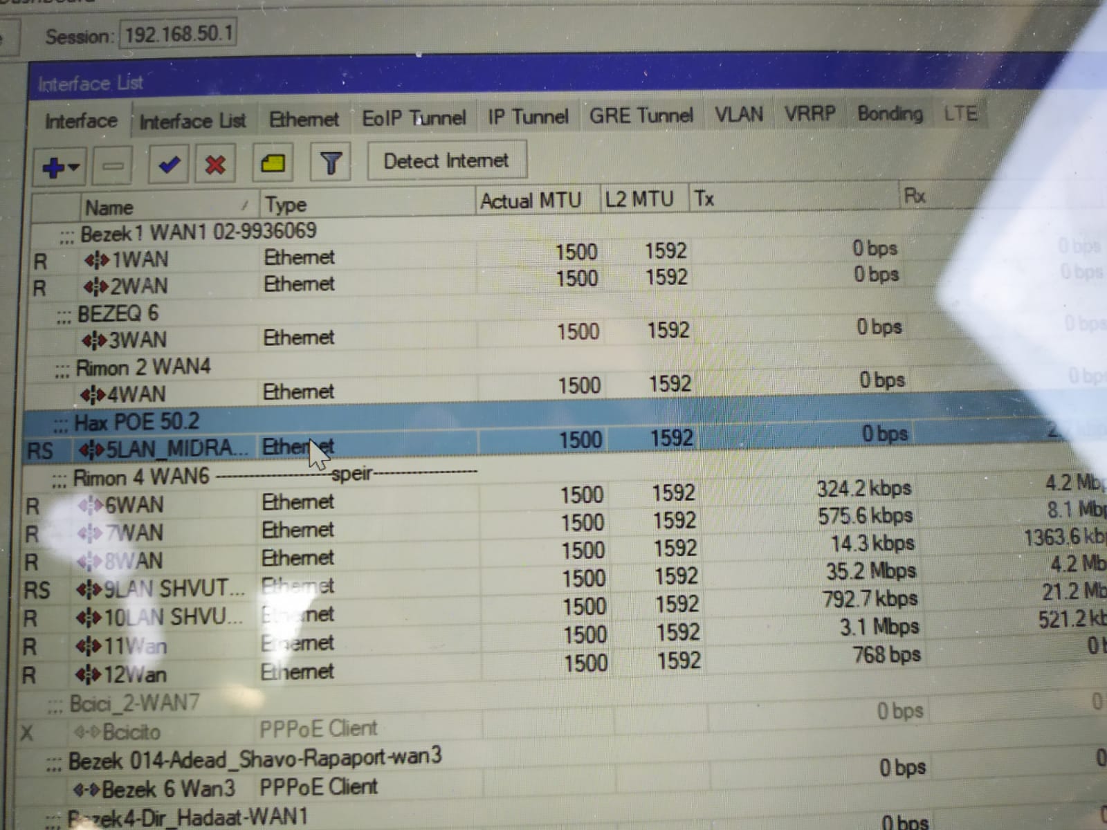

And I have two issues that are unclear to me whether they are physical or in settings.
  1. After a few hours the router works all ports in switch 1 stop working.
    Sometimes I manage to cancel and run and then write on port “R” but it does not work.
  2. Sometimes this problem appears at the same time, but problem # 2 always occurs after problem # 1 has already started.

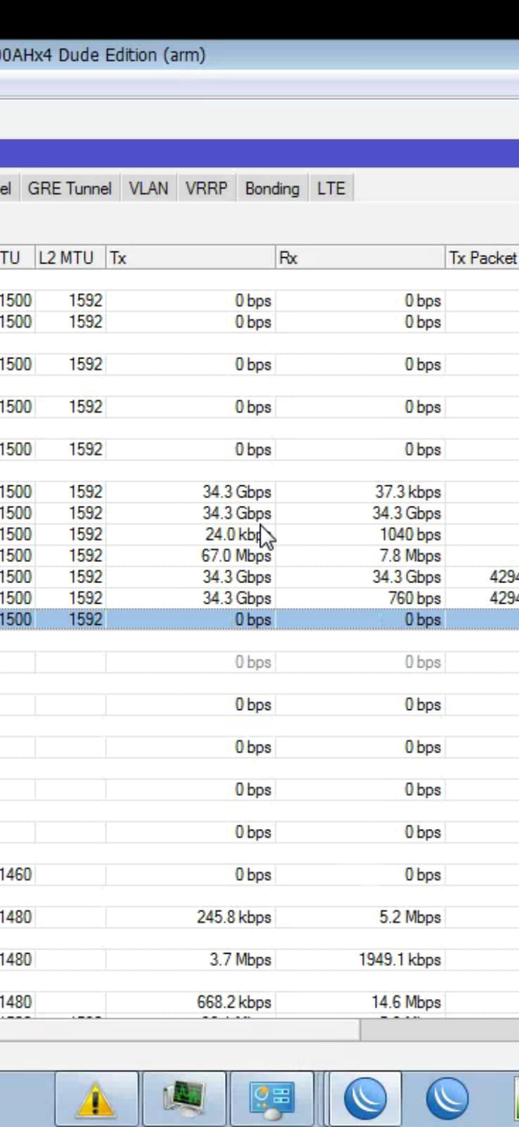

    All ports on switch 1 (1-5) have outbound and inbound traffic of 34GB and sometimes up to 5000GB, with adsl modems only supporting 100mb.

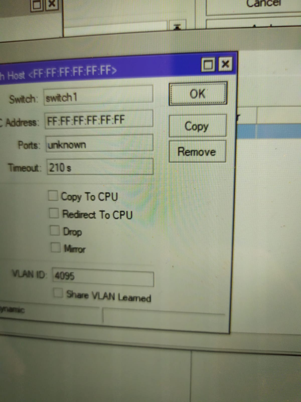

    During this time, sometimes this time appears within the “switch” menu in the HOST tab “D” of FF: FF: FF: FF: FF: FF: FF
What do you say? Physical problem or something in settings?

Is not problem with RB1100, problem is because you have loop on your network!
Try to update to the last ROS version and update the firmware.
Regards.
Or you have a device that is Broadcasting MAC
A loop between two 1Gbps ports cannot make the statistic show 30+Gbps on the physical interface…
this is either some massive software bug or hardware issue…
