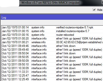

I have mikrotik RB450G. but i have one big promlem with either link down/up (in 2 sec) . I have connected 2 AP . One is Nanostation M2 and the second is AirMax Sector 2G-16-90 with Rocket M2. Nanostation M2 works very good - no one problem but when i connect Airmax - i have the problem with either link down/up.
Either link down /up is the same as in the attached file

Could be a fault with your cable and connectors or the Airmax device.
Best to test them all. In the mean time you could try forcing that Ethernet port to 10mbit.

no it seems that mikrotik devices(seems that devices 4xx) have problem with big packets(nstreme, airmax), this same happens to me between to devices, when one is with nstreme enabled.

I solved freezing on ethernet putting switch between to routerboards. It now works(later I plan to change it for alix board)
